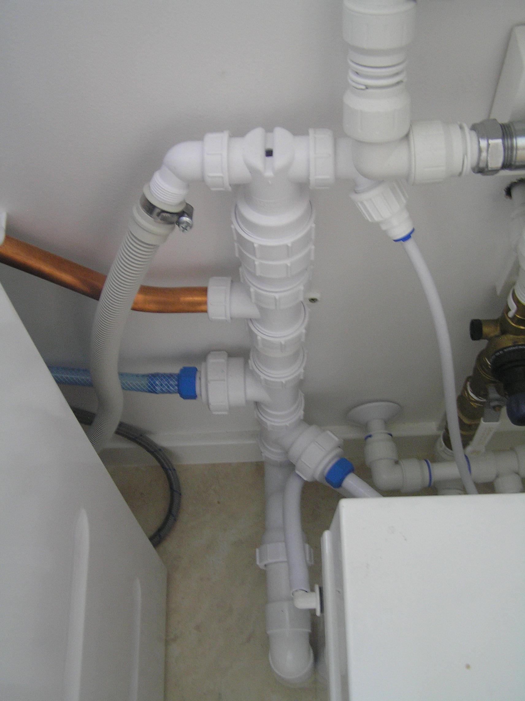

Gone West Posted February 1, 2019 Posted February 1, 2019 (edited) In our house I have a dedicated waste for the appliances in the utility room. The waste has a u-bend and exits into a 110mm soil pipe which goes down through the slab and insulation. Edited February 1, 2019 by PeterStarck

Pete Posted February 1, 2019 Posted February 1, 2019 1 hour ago, PeterStarck said: In our house I have a dedicated waste for the appliances in the utility room. The waste has a u-bend and exits into a 110mm soil pipe which goes down through the slab and insulation. Hi Peter, what is the thing at the top of the stack of unions please? ( The bit with the little hole in it!)
Gone West Posted February 1, 2019 Posted February 1, 2019 @Pete It's a McAlpine V33WM vented twin waste connector. https://mcalpineplumbing.com/traps/domestic-appliance-traps-accessories/v33wm-twin-connector 1
