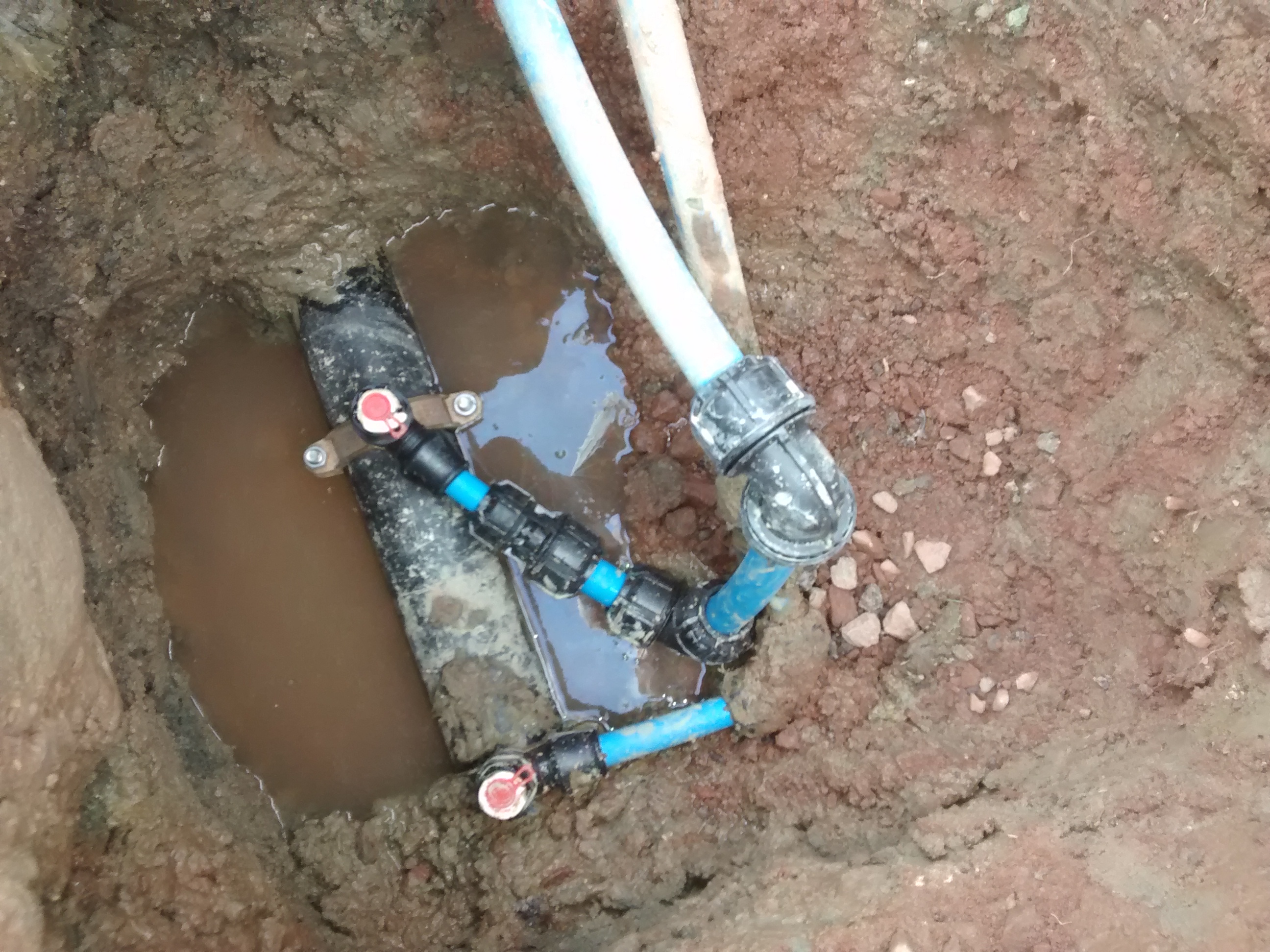

I've just had my mains supply connected today and upon peering into the trench this evening after the workers had left have noticed that the actual connection coming off the mains is in 25mm, then after 150mm or so jumps up through a 'reducer' to 32mm, which is then coupled to my 32mm supply pipe.
Should I be bothered/concerned that I don't have the 32mm connection that I had ordered, or is this standard practice?

Despite specifying 32mm connection, and laying a 32mm communication pipe, our actual connection is 25mm off a 6 inch main.  Two reasons given:
1. Too many 32mm connections reduces overall mains pressure
2. It gives Scottish Water the ability to upgrade the connection to 32mm if supply pressure is a problem.
In essence, Scottish Water (in Orkney) will only provide a 32mm mains connection when actually needed to meet minimum guaranteed performance.
It may well be a similar situation where you live.

Hi,
Yes you're right Nick, nowhere on my paper work is there any detail of what they agree to do to connect my 32mm pipe, only the following statement:
Quote
Please note: we do not guarantee any particular flow or water pressure to existing or future customers.  Our operational standard is to maintain supplies to customers at the stop tap at a pressure of ten meters head at a minimum flow rate of nine litres per minute.
I, like Jack, have about 90m of run from the mains to my stop tap, so fingers crossed that I have a more than the minimum 9l/min!

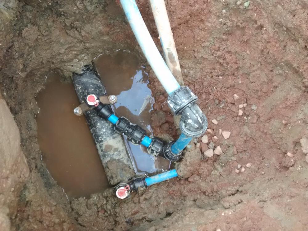

Photo for your interest:

Thanks for the pic :)
At least they've done the most they could do ie they've upsized to 32mm from 25mm as soon as practicable, and the 32mm pipe you've run to the house should mitigate any pressure reduction over the length as much as is possible. 9 L/P/M is shat, so you should get better than that with your arrangement. Have you / they tested it yet for the results ?

They've put me a trickle plug instead of a meter (about 50m up the run), so I have yet to find out what it will be like. It looks to me like the meter is also a 25mm meter so there is another pinch point for me!
