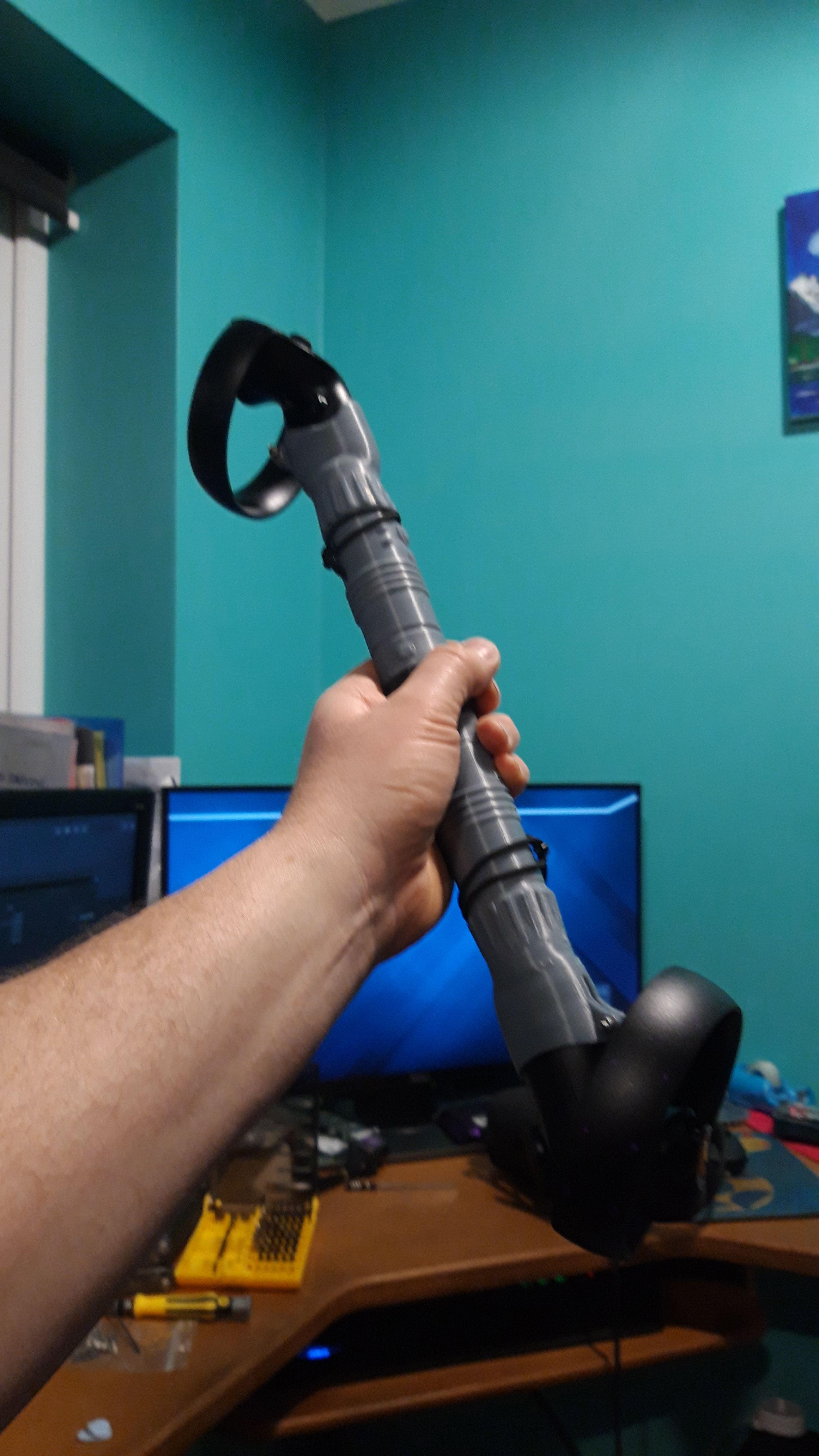

Onoff Posted January 17, 2020 Posted January 17, 2020 3D printed, 2 piece handle to connect two Occulus Rift VR controllers together to make a Darth Maul style light sabre. Used for playing Beat Saber. They interlock with an m/f twist joint but I've backed it up with self amalgamating tape:

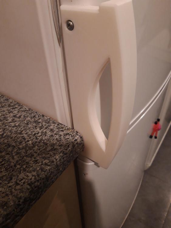

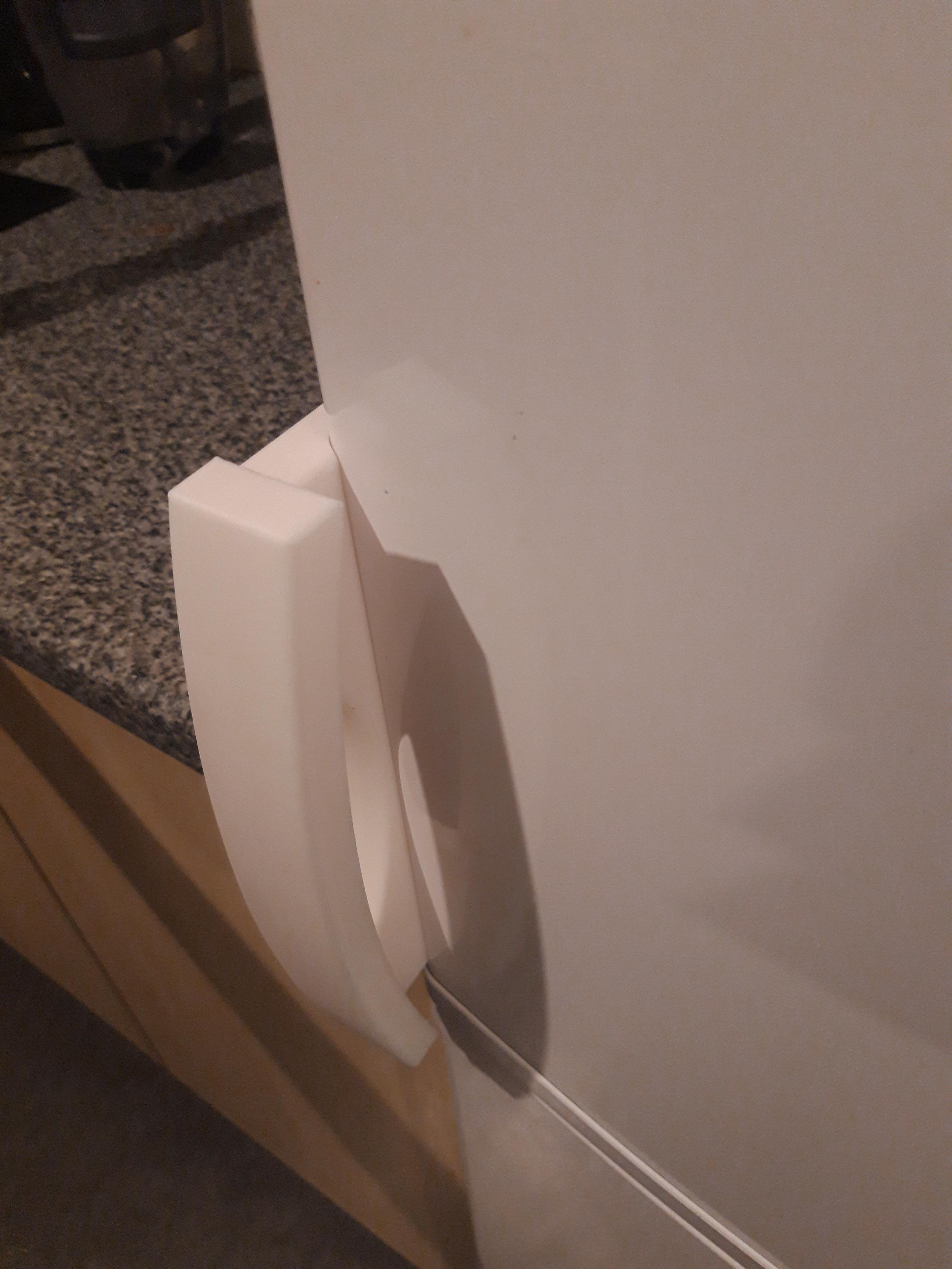

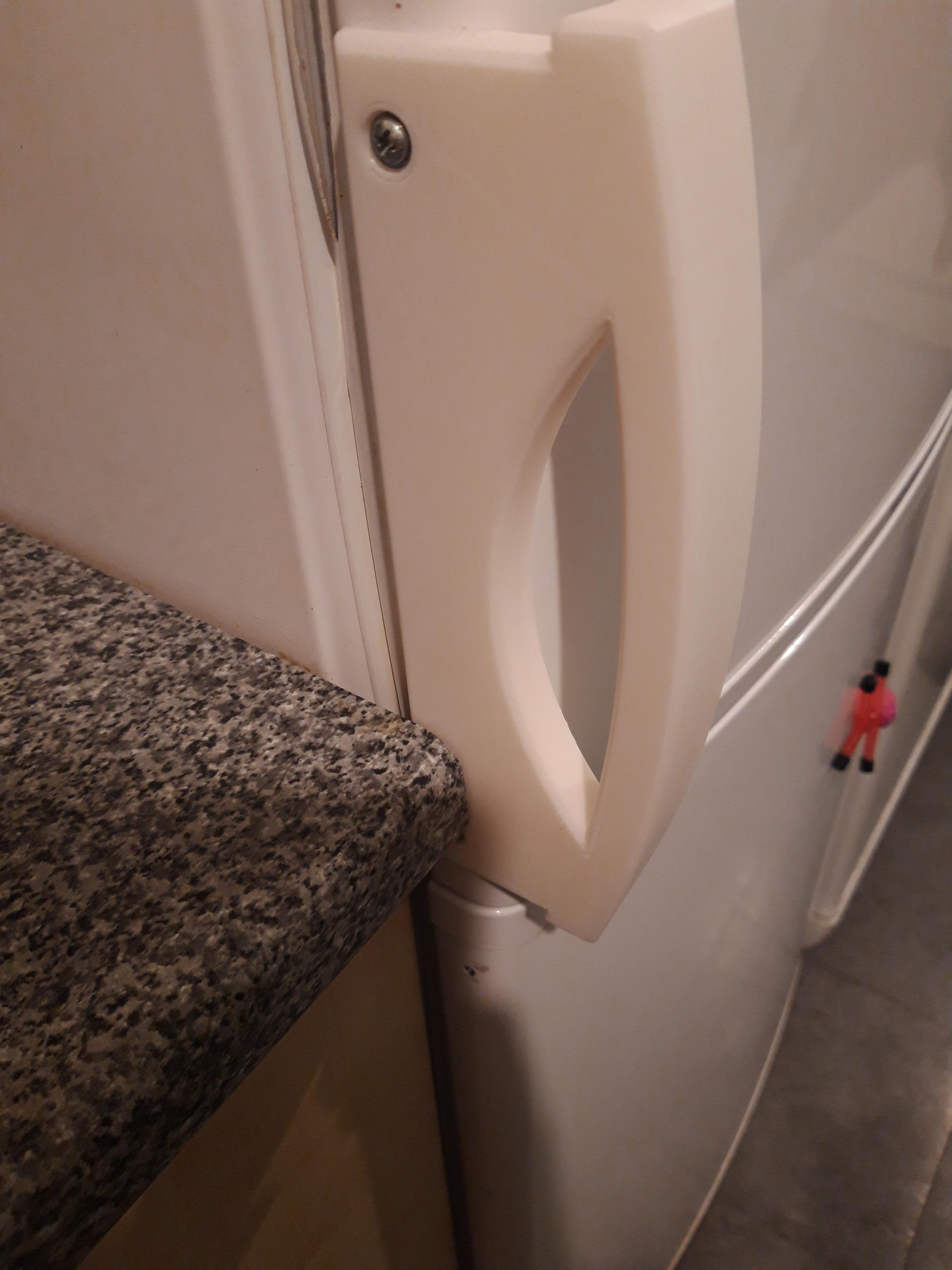

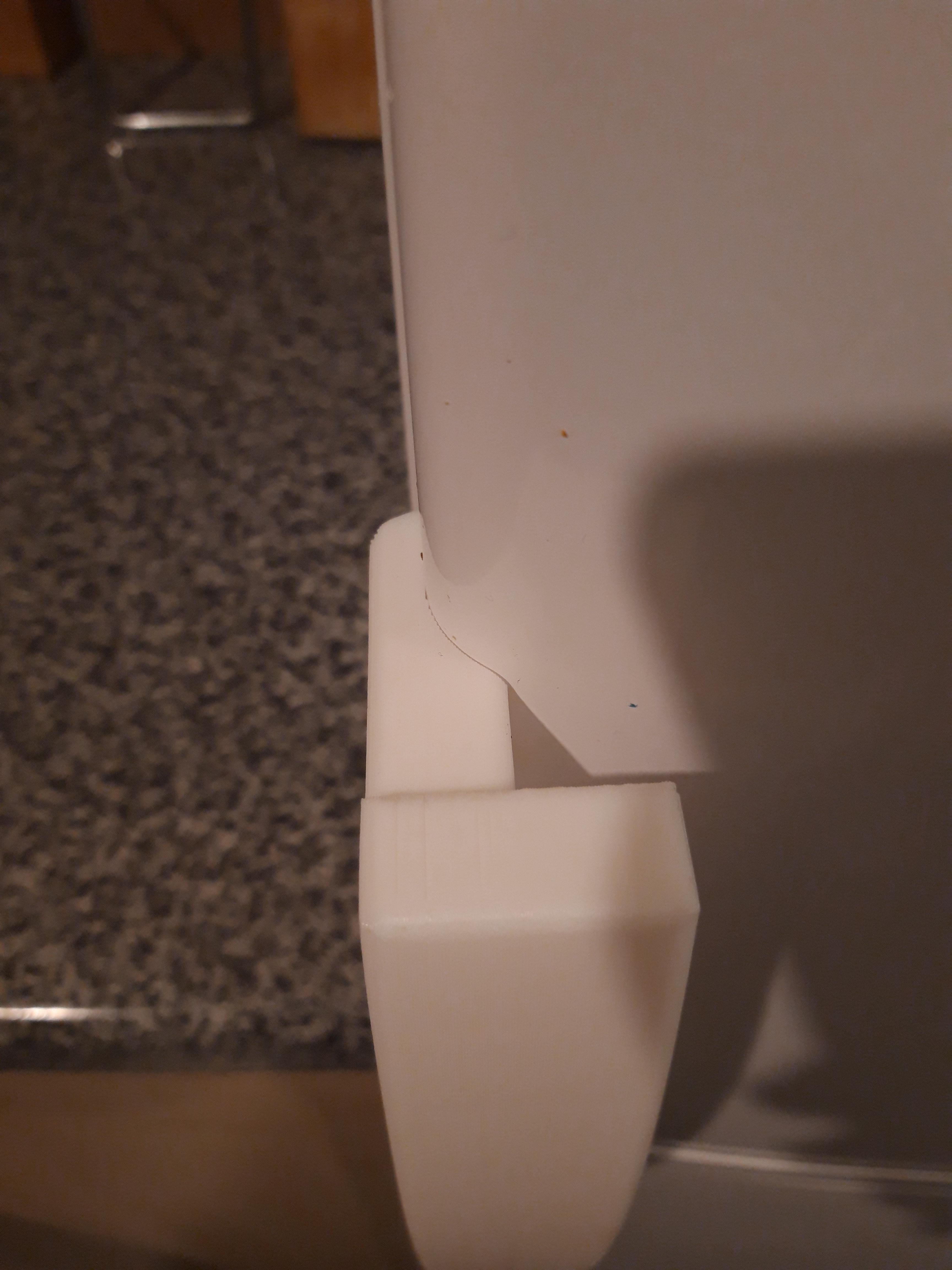

Onoff Posted January 18, 2020 Posted January 18, 2020 We have a winner! Well, other than it's off white compared to the fridge paint. Albeit simplified from the original it's so much smoother etc than the previous print! Pity about the split in the seal... The profile isn't a bad match either: 1

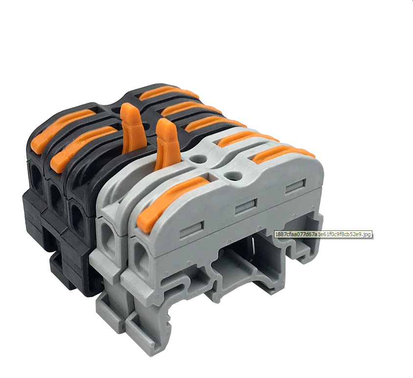

Jeremy Harris Posted March 17, 2020 Posted March 17, 2020 I've wondered why Wago don't have a range of them (or, if they do, then why they don't seem readily available). I used some Wago copies that fit a DIN rail recently. They did look really neat when mounted like this, and were a lot easier to use when held firmly inside a box.

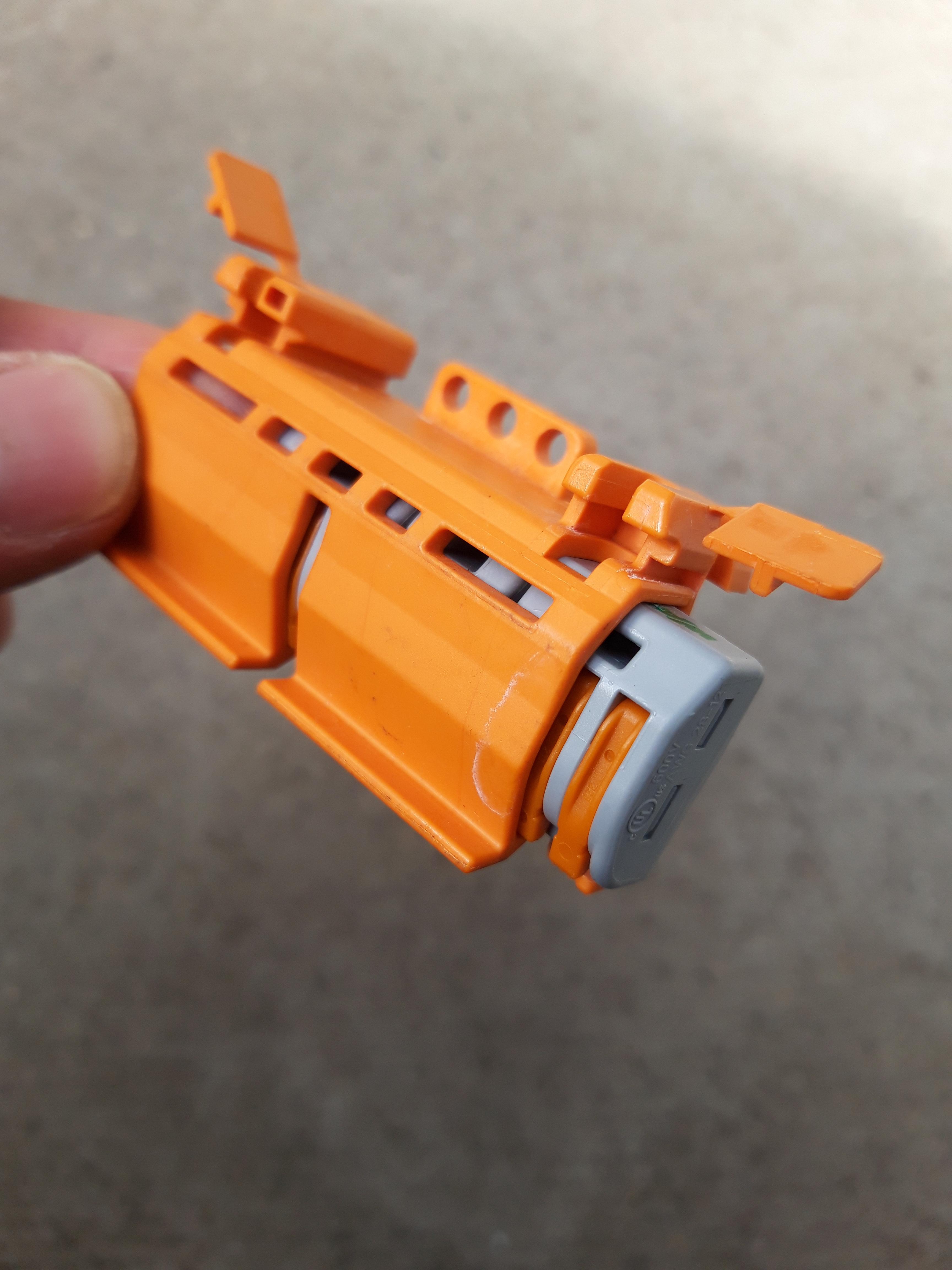

Onoff Posted March 17, 2020 Posted March 17, 2020 (edited) 7 minutes ago, Jeremy Harris said: I've wondered why Wago don't have a range of them (or, if they do, then why they don't seem readily available). I used some Wago copies that fit a DIN rail recently. They did look really neat when mounted like this, and were a lot easier to use when held firmly inside a box. The orange 222-500 holders like this? I always hanker after something else that is i) longer and ii) where you can pop them out individually rather than slide them along: I wonder if these are fire retardant? Edited March 17, 2020 by Onoff
Jeremy Harris Posted March 17, 2020 Posted March 17, 2020 The ones I used were knock-offs, like this: Nice and easy to use, as being fixed down makes lifting the lever and poking the wire in easier. Keeps everything nice and neat, too.

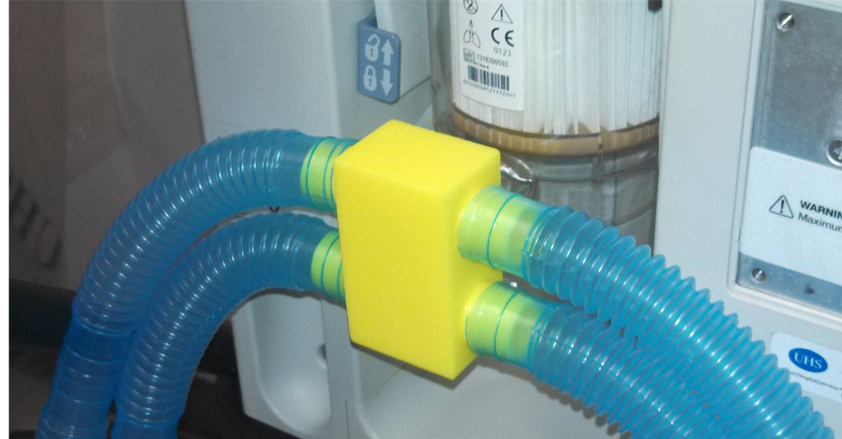

Temp Posted March 17, 2020 Posted March 17, 2020 This look interesting. Its a manifold allowing four masks on one ventilator. Original paper published in 2015 in anticipation of a pandemic. No idea if it makes medical sense. Can't find the .stl anywhere. https://file.scirp.org/Html/2-1750025_49209.htm#ref10
Onoff Posted March 17, 2020 Posted March 17, 2020 42 minutes ago, Temp said: This look interesting. Its a manifold allowing four masks on one ventilator. Original paper published in 2015 in anticipation of a pandemic. No idea if it makes medical sense. Can't find the .stl anywhere. https://file.scirp.org/Html/2-1750025_49209.htm#ref10 I would have thought essential to ensure positive pressure to each patient to prevent cross infection? 1

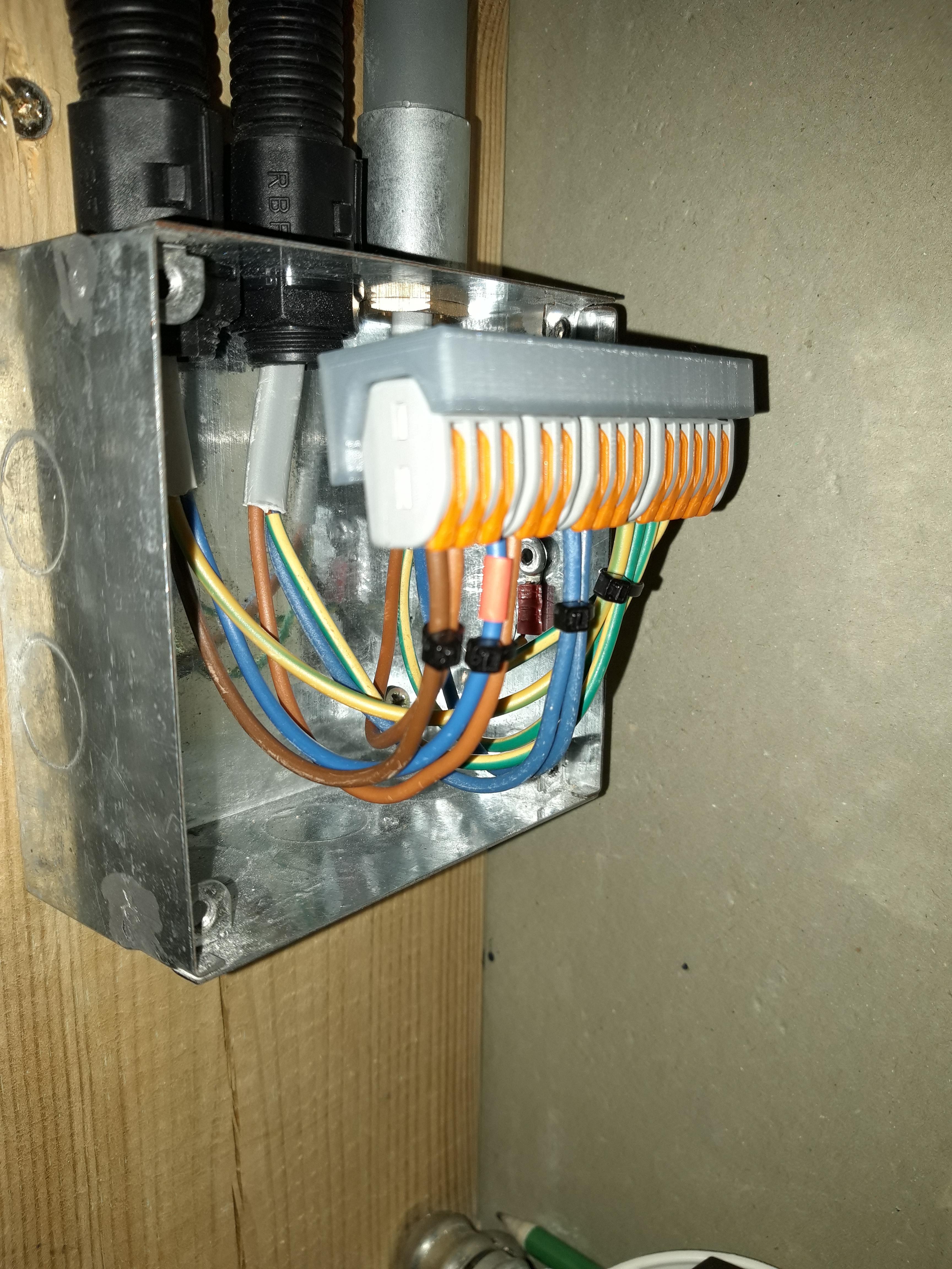

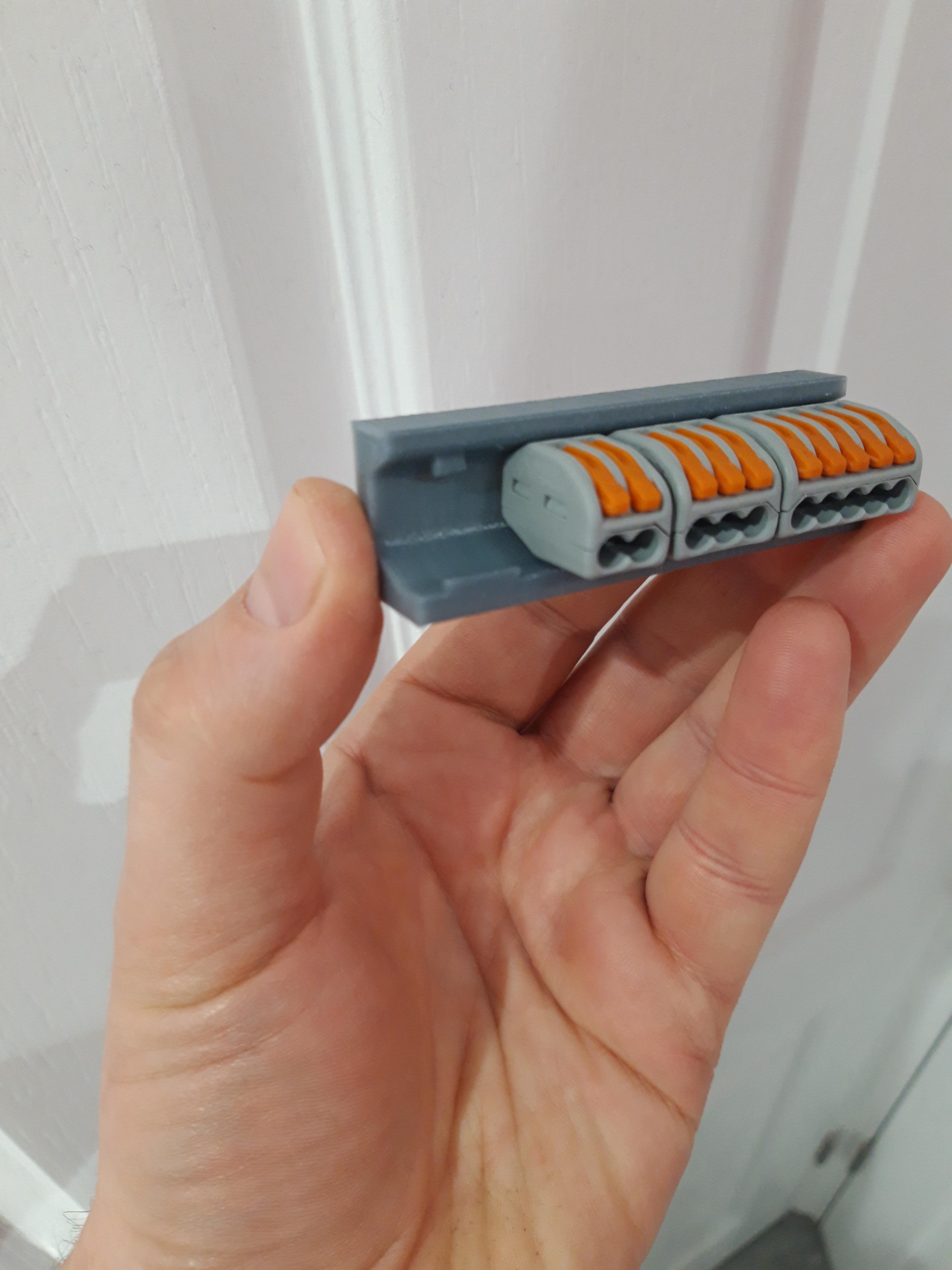

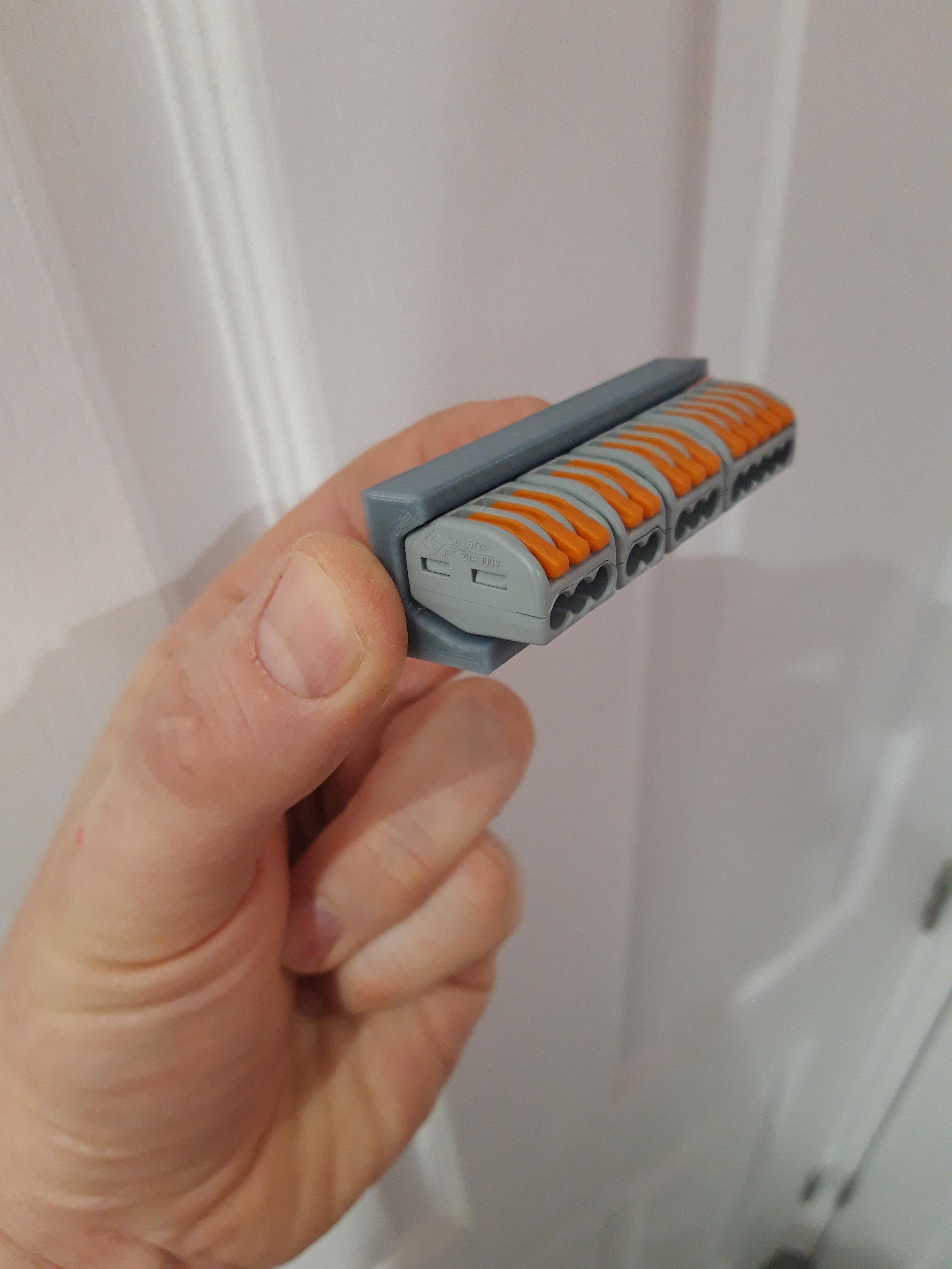

Onoff Posted March 18, 2020 Posted March 18, 2020 Just playing with a printed WAGO connector. My lad is writing a script to self generate the CAD files in whatever configuration. This is a 3+2+3+5. First was too tight, second too loose. This seems to hit the sweet spot with them clipping in and out just about right to the indents in the WAGOs. Double sided tape job probably to the top of the box to save drilling: (First one to mention red sleeving catches the virus! I have literally hundreds of metres of the stuff to use up ? ).
Jeremy Harris Posted March 18, 2020 Posted March 18, 2020 Looks good, nice and neat. Only snag is that it covers up the probe test slot, although that's not really a biggie (handy though, at times).
Onoff Posted March 18, 2020 Posted March 18, 2020 16 minutes ago, Jeremy Harris said: Looks good, nice and neat. Only snag is that it covers up the probe test slot, although that's not really a biggie (handy though, at times). Yes, aware of that. Might adapt to include a test hole/slot.
Jeremy Harris Posted March 18, 2020 Posted March 18, 2020 Easy enough to just unclip them if you ever need to poke a probe in the hole, though. The neatness of having them tidied away outweighs easy access to the probe slot, IMHO.
Onoff Posted March 18, 2020 Posted March 18, 2020 9 hours ago, Jeremy Harris said: Easy enough to just unclip them if you ever need to poke a probe in the hole, though. The neatness of having them tidied away outweighs easy access to the probe slot, IMHO. Just had another look and one of the clips on the printed adapter clips into the test slot on the WAGO so a test hole in the adapter is a no go really.
Jeremy Harris Posted March 18, 2020 Posted March 18, 2020 Just now, Onoff said: Just had another look and one of the clips on the printed adapter clips into the test slot on the WAGO so a test hole in the adapter is a no go really. That's what I thought when I saw it, but only because I have a couple of 222s sat on my desk
