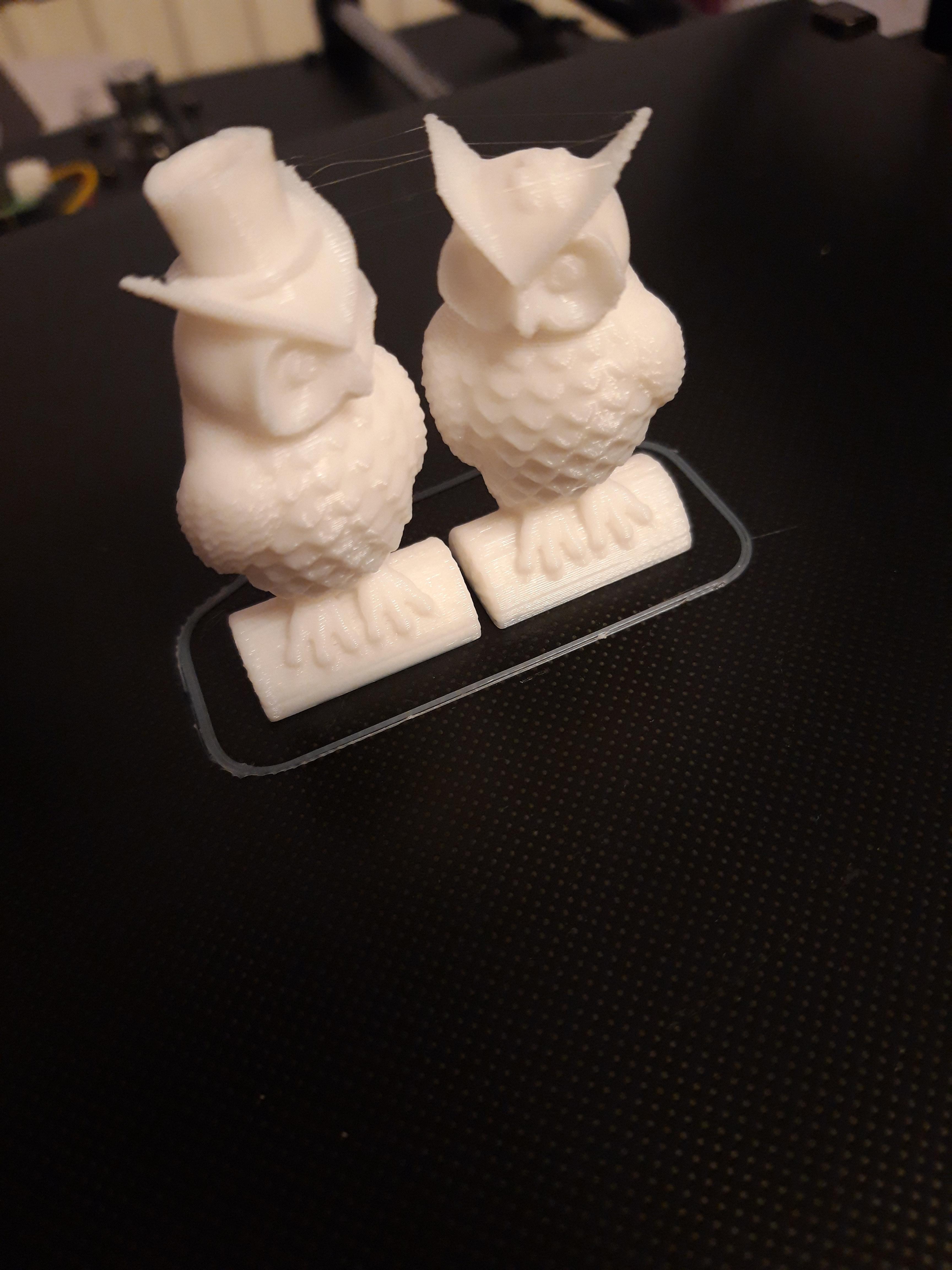

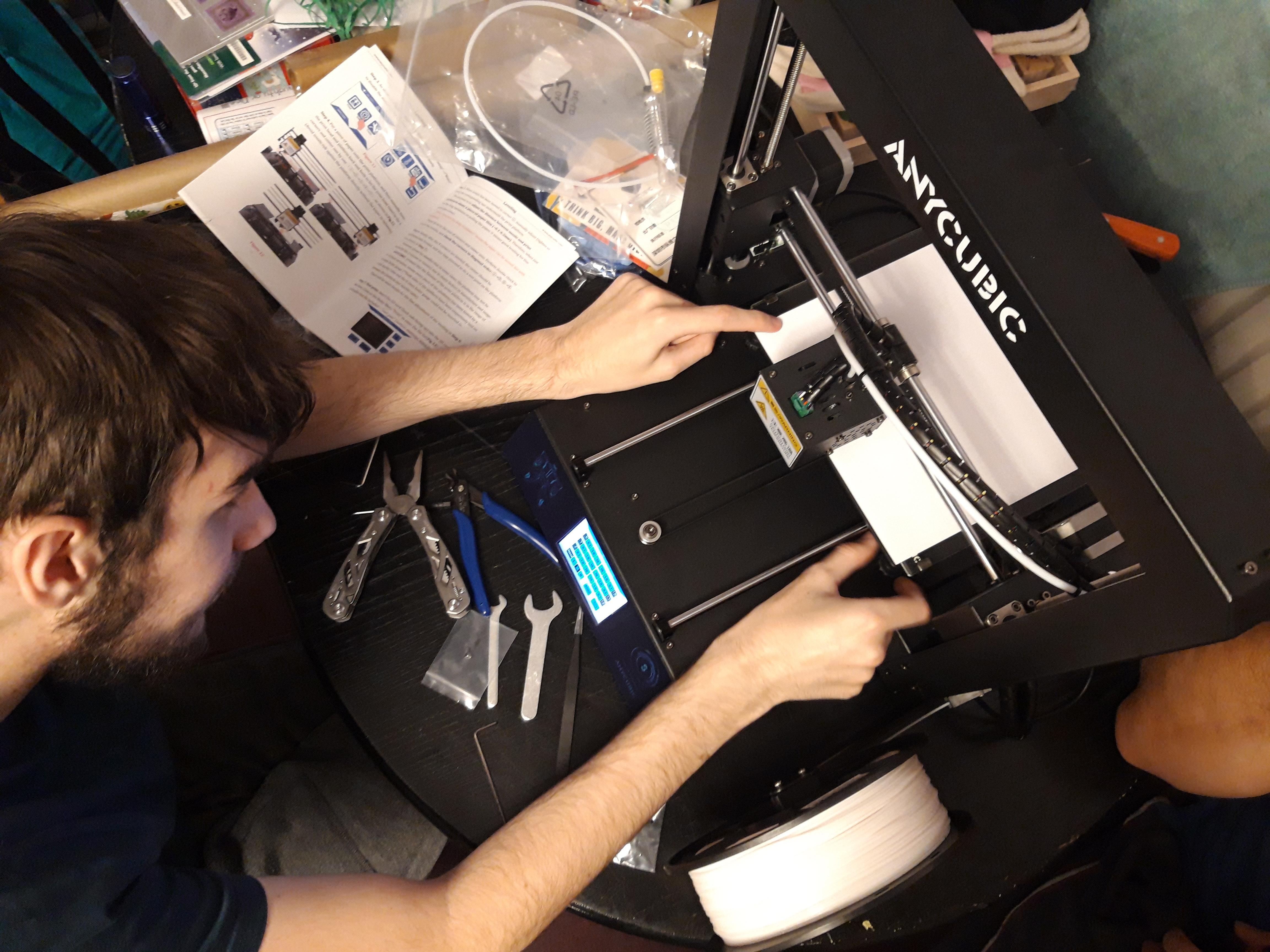

Onoff Posted December 21, 2019 Posted December 21, 2019 Thanks. Trying the test model, a "pair of owls" and he set it running and went off (to download Cura). I noticed that as it was printing the whole print was moving where it hadn't stuck to the bed I guess. This print was square to the bed then "slipped" like this. Just cleaned the bed with IPA and trying again but I reckon it's a bed level issue.
Jeremy Harris Posted December 21, 2019 Posted December 21, 2019 Not sure if it's the same for FDM printers as it is for resin printers, but I've found that levelling the build platform (bed for an FDM printer) is hyper critical. From what I've read, with FDM printers there are also other tricks to ensure that the base layer adheres well.

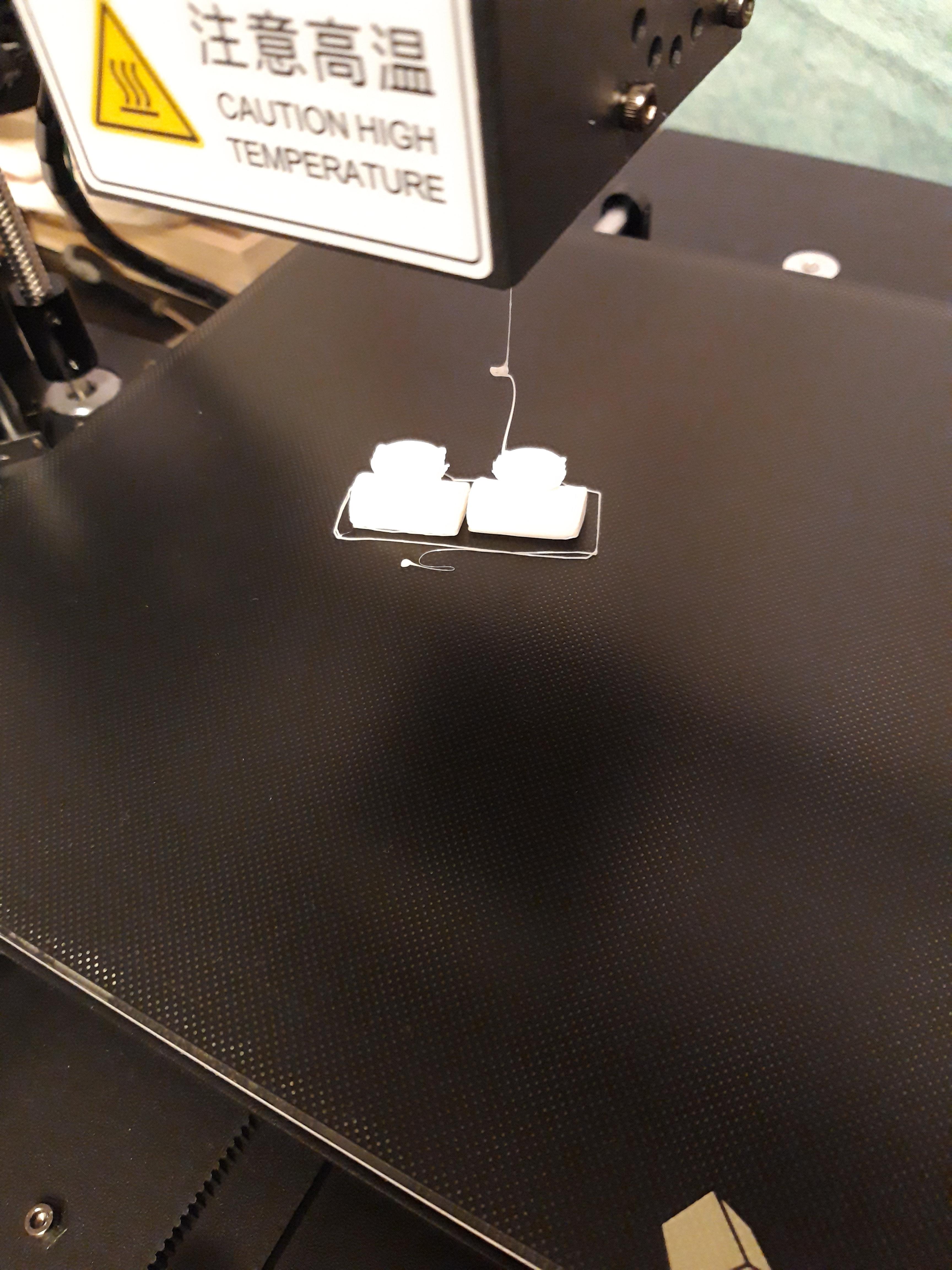

Onoff Posted December 21, 2019 Posted December 21, 2019 7 minutes ago, Jeremy Harris said: Not sure if it's the same for FDM printers as it is for resin printers, but I've found that levelling the build platform (bed for an FDM printer) is hyper critical. From what I've read, with FDM printers there are also other tricks to ensure that the base layer adheres well. I did read somewhere, maybe it was @Temp mentioned it, that some put masking tape on the bed. Says in the book for this one not to do that. He just tried printing that little switch bit you did for me but it looked dog rough ? What fill percentage did you use? At the moment the printer is sat on the dining room table and as it prints you can the vibration through the table. I wonder if that's an issue? Only took 1m25s though!
Onoff Posted December 21, 2019 Posted December 21, 2019 First two times he used generic, A4, "matt" inkjet printing paper, 0.1mm thick to level the bed. The owl pair didn't stick and the switch piece came out naff. Just used the glossy 0.1mm piece of A4 that came with the printer and looking much better. A little flash on the underside. Actually looks better than the photo.

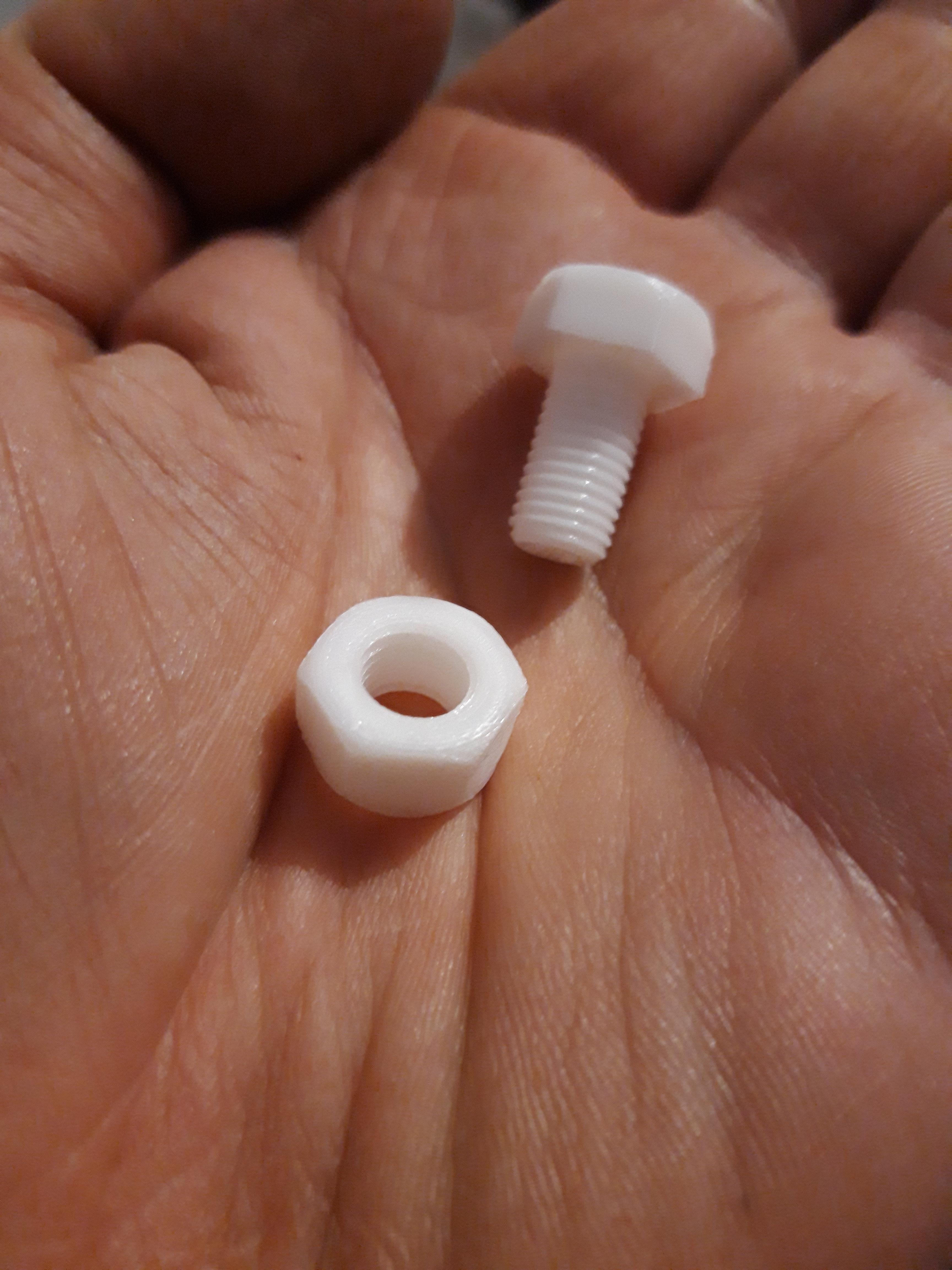

Onoff Posted December 22, 2019 Posted December 22, 2019 Another test piece. The fuzziness is the camera not focusing too well. 2

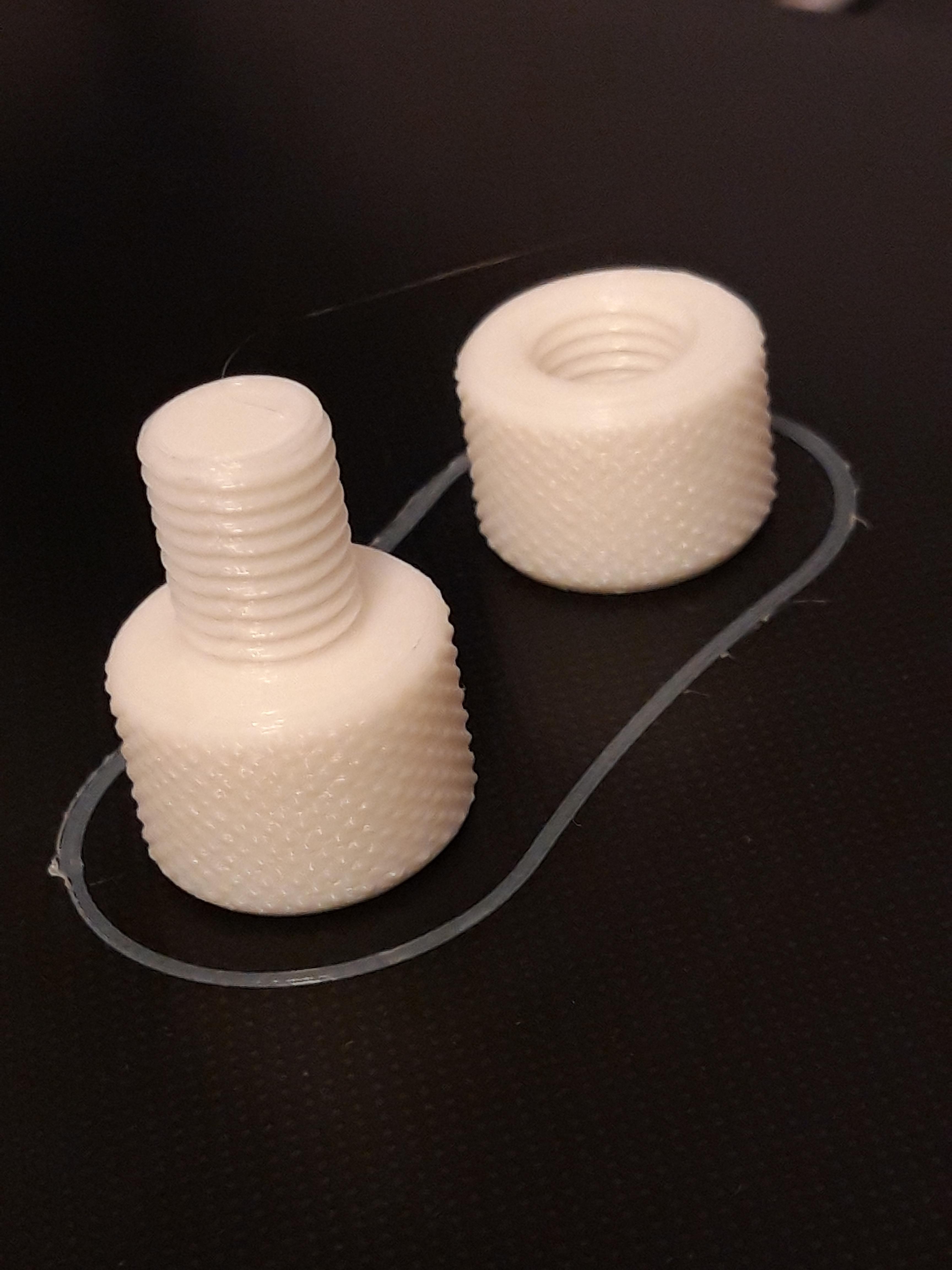

Temp Posted December 22, 2019 Posted December 22, 2019 Failure to adhere to the bed is a common problem and everyone seems to have their own favourite solution. The nozzle gap is critical and should be uniform across the bed. This is to ensure the first layer is squished down just the right amount. Feeler gauge recommended. Heating the bed seems to help, presumably by stopping the bottom layers shrinking as it cools and cracking off the bed. My printer automatically turns off the bed heater after completing a print and you can sometimes hear it crack off and come loose as it cools. Turning off the cooling fan for first layer or two in the slicer/cura can help adhesion. Many people (including me) put a toughened glass plate on the bed as this is flatter than the aluminium plate supplied. Helps maintain the nozzle gap constant as the nozzle moves across the bed. These are available on Amazon. Treating the glass bed can also help. Some people use Pritstick. You rub it on and then wipe the surface with a bit of wet kitchen towel lightly. This dissolves the Pritstick and when it dries it forms a uniform coating on the glass. The coating lasts many prints. I tried that and found it worked but it's time consuming and messy. Blue painters masking tape is what I'm currently using. It's much quicker than the Pritstick method and seems to work as well. Even when you get PLA to stick you can have issues with other materials. Sometimes the first few inches of filament get dragged all around the bed. To fix that I add a brim or similar which not only helps adhesion but also gives the extruder time to settle down before printing the real part. Sometimesine of holes fails to stick. I find slowing the print speed for the first few layers helps with that - sometimes go as slow as 20mm/second for first layer.
Temp Posted December 22, 2019 Posted December 22, 2019 That nut and bolt look pretty clean. Not tried printing a nut but I found an ordinary metal nut would fit onto a bolt I printed. Cura allows you to scale prints so adding a few % and reprinting the nut might work or run a tap through it if you have one.

Onoff Posted December 22, 2019 Posted December 22, 2019 31 minutes ago, Temp said: That nut and bolt look pretty clean. Not tried printing a nut but I found an ordinary metal nut would fit onto a bolt I printed. Cura allows you to scale prints so adding a few % and reprinting the nut might work or run a tap through it if you have one. It's adhering fine to the bed now. This one looks the part but it's M? ? Think he was messing with the scale. Doesn't screw together either, in fact I think the helix angle is different on each bit. Never mind he's having fun. The knurling's pretty good:

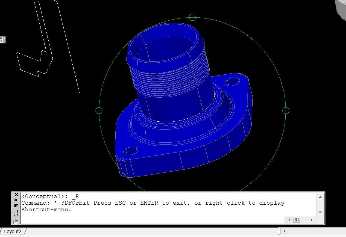

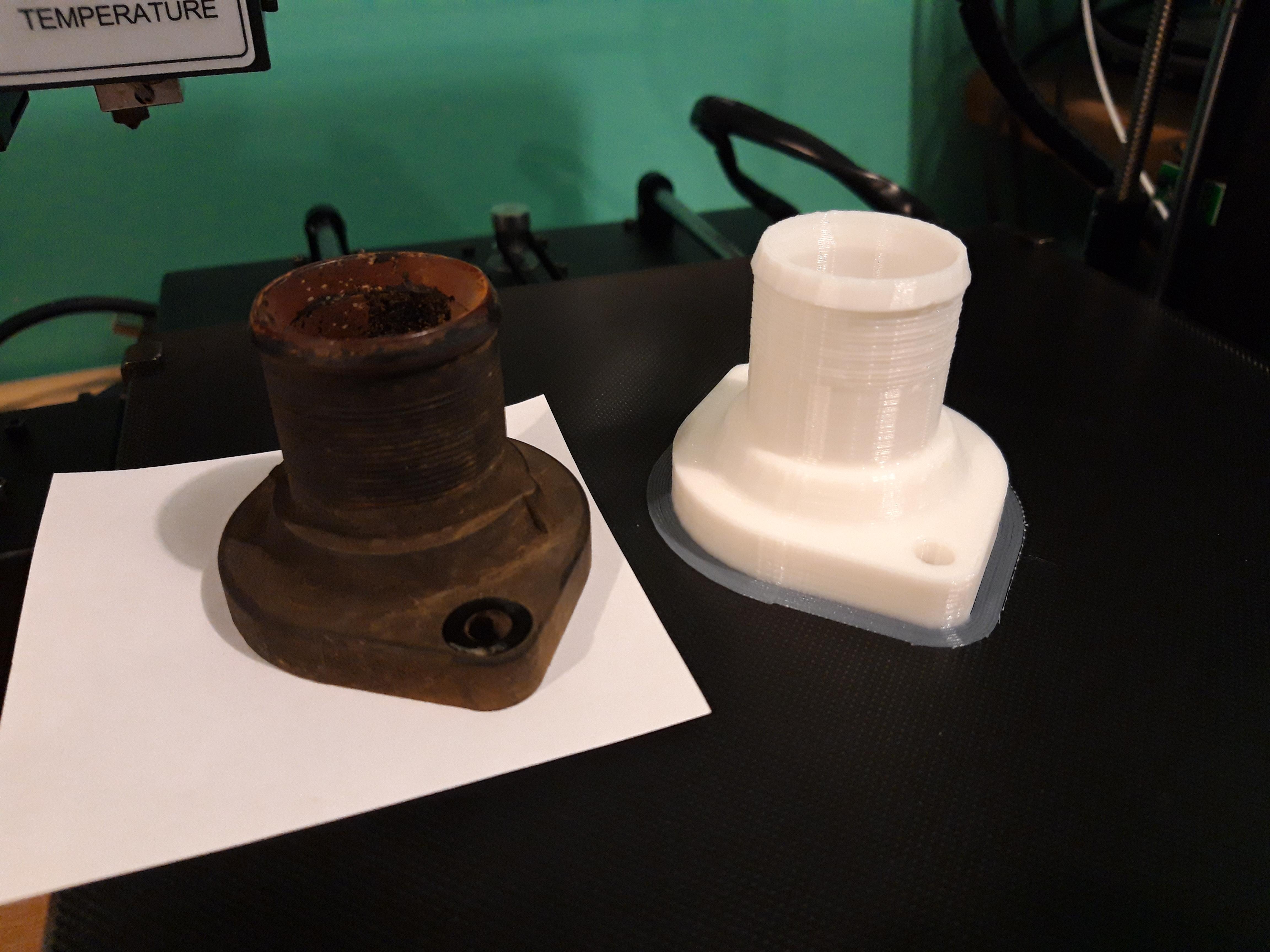

Onoff Posted December 26, 2019 Posted December 26, 2019 Thought I'd copy the thermostat housing I've just taken off the wife's car...as you do:
Onoff Posted December 26, 2019 Posted December 26, 2019 Not bad. Printed with speed in mind rather than anything else. Absolutely useless on the car as it would melt! ? 1

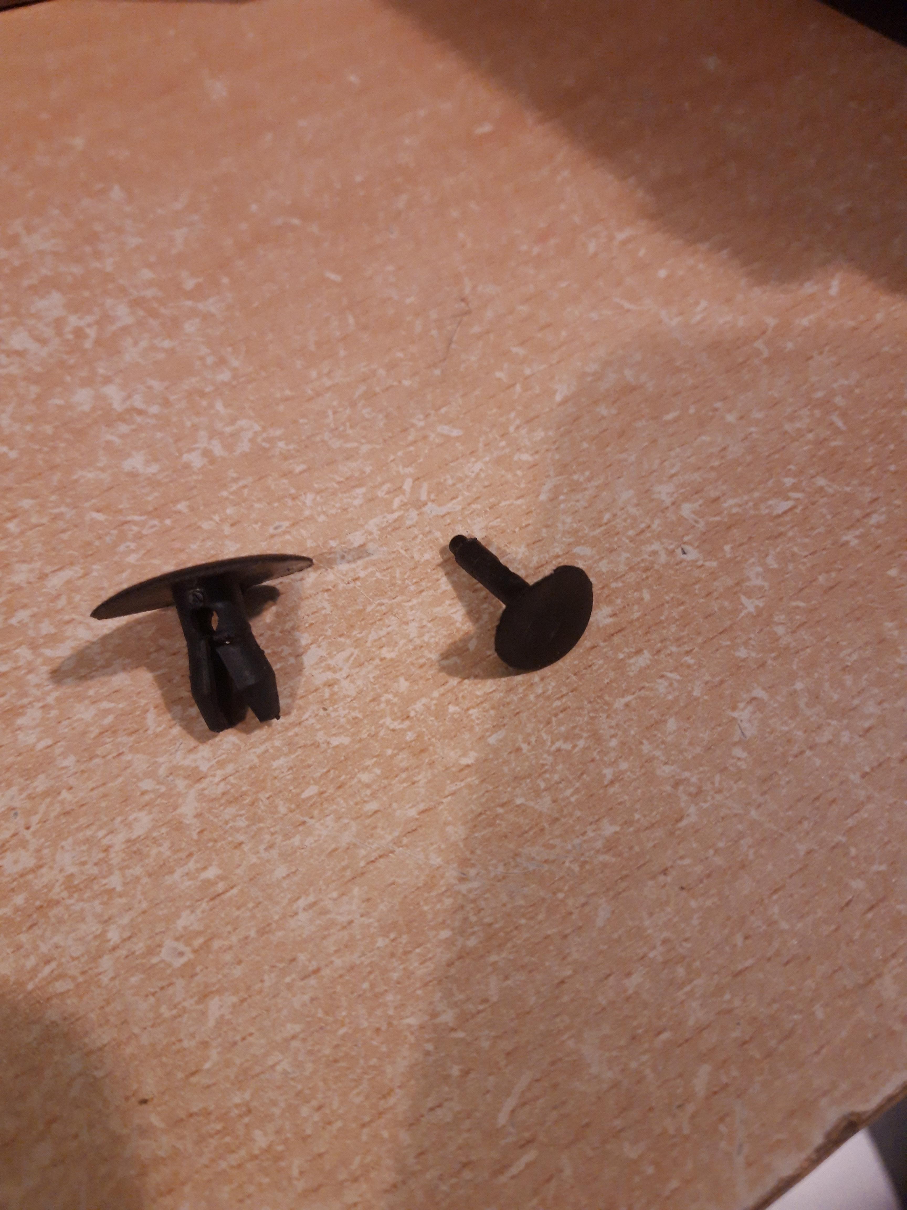

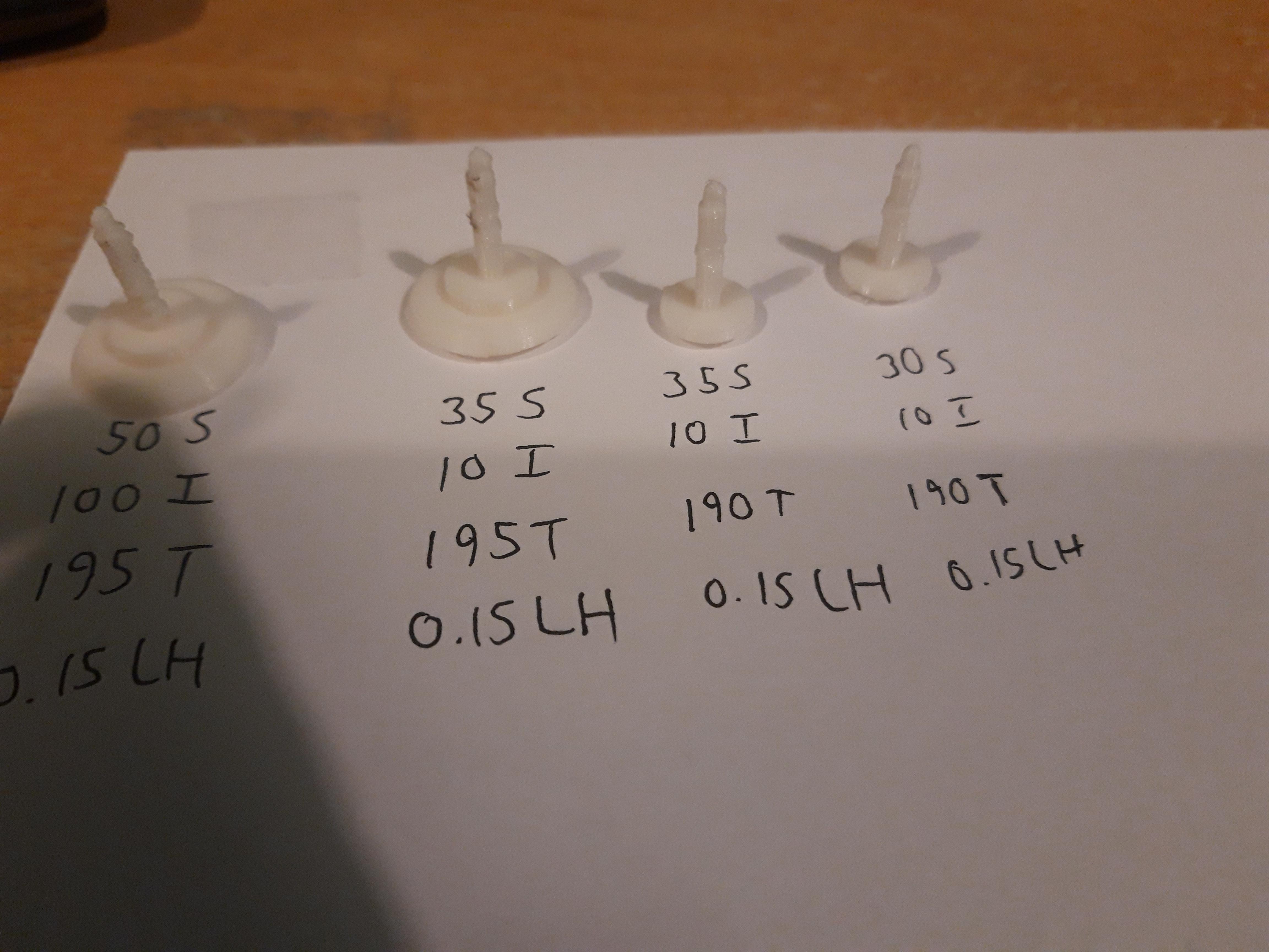

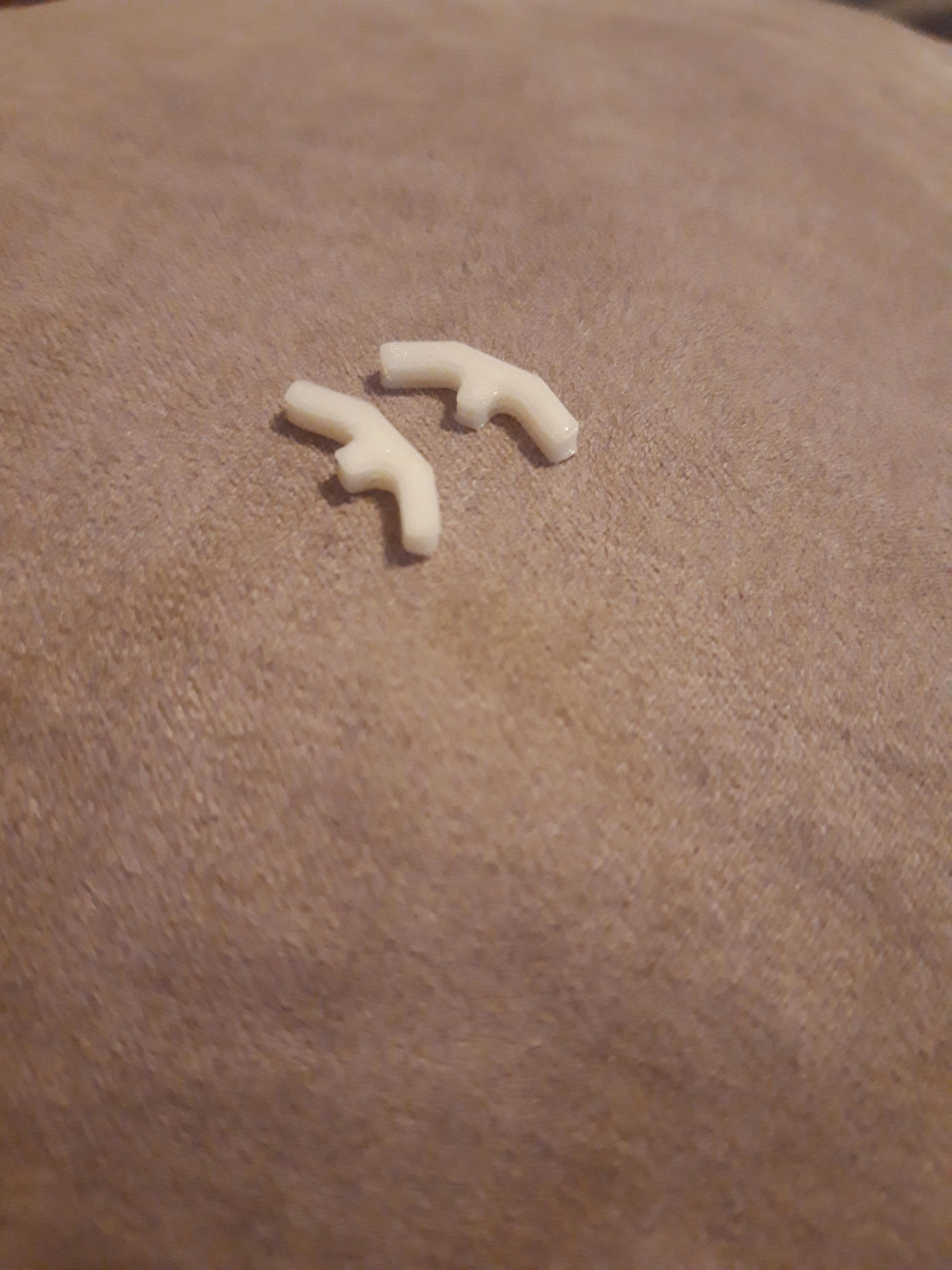

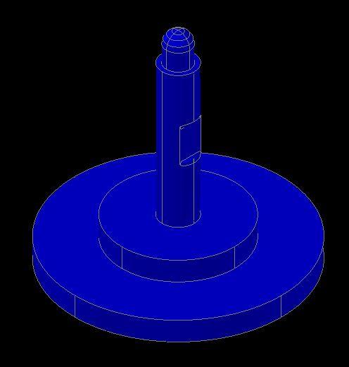

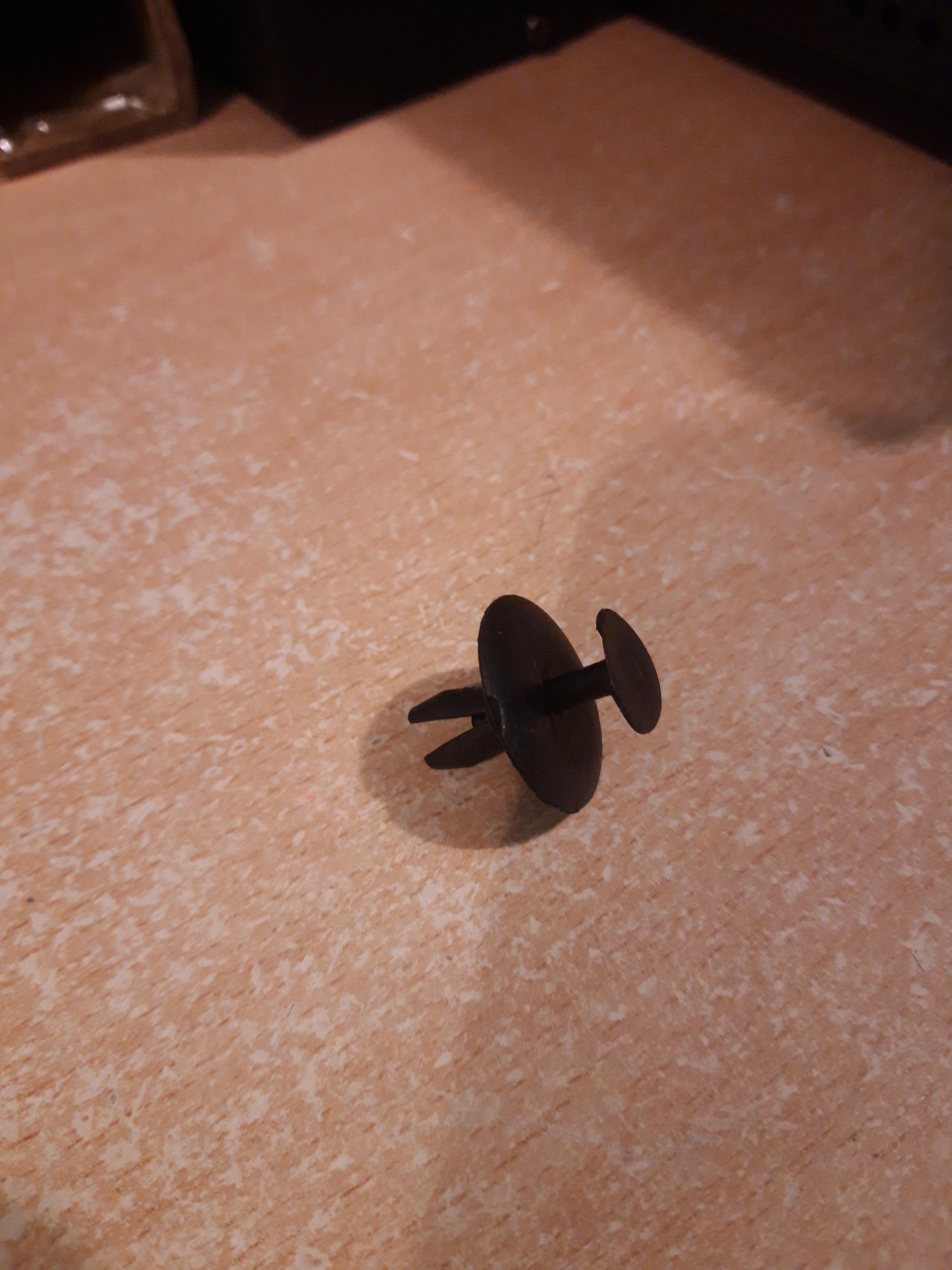

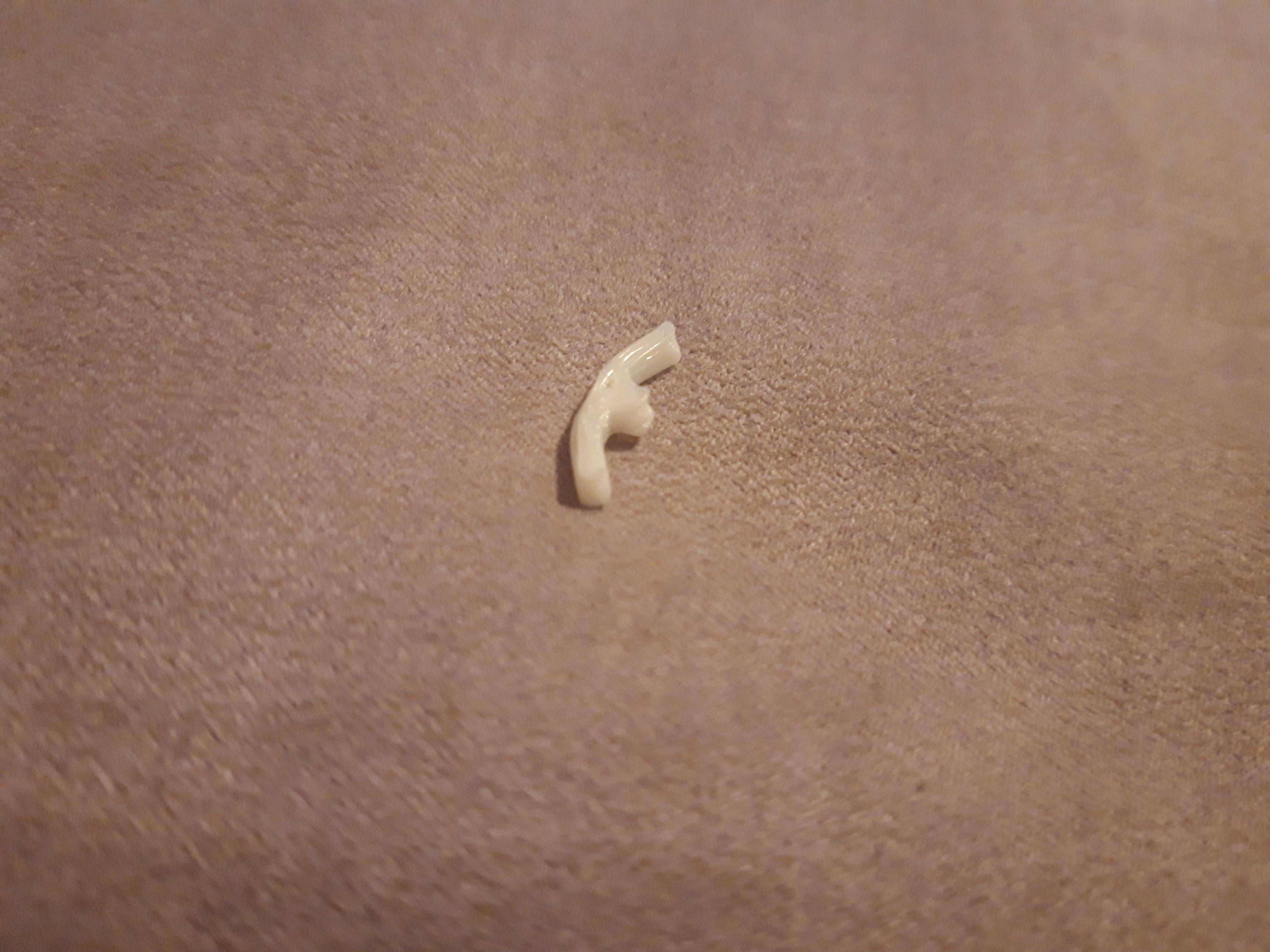

Onoff Posted December 28, 2019 Posted December 28, 2019 With the car in pieces thought we'd print some new trim clips for the wheel arch liners. CAD done by me then handed over for printing. Original 2 piece part: Trying the "pin" first. Not too good, any ideas? Seems as it increases in height it's still too "fluid" to resist the lateral force of the hot end as it extrudes the filament. Been experimenting with slowing things down.
Temp Posted December 28, 2019 Posted December 28, 2019 Cooling fan enabled? Try printing it horizontally with supports. Should be stronger that way as well.
Onoff Posted December 28, 2019 Posted December 28, 2019 It doesn't seem to like the recess halfway up the shaft for some reason. Throws it off all wobbly:
