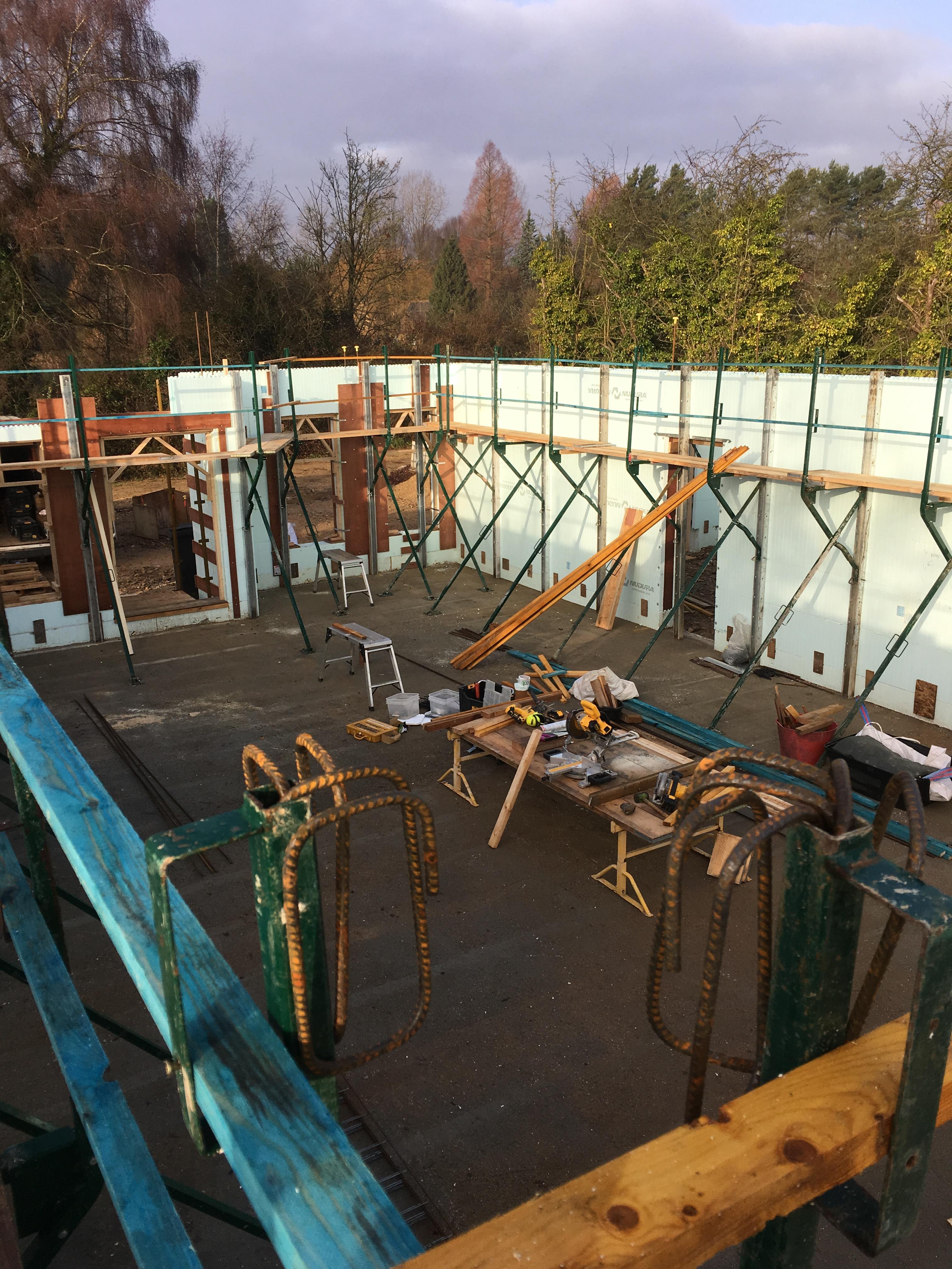

Big Neil Posted January 16, 2019 Posted January 16, 2019 IN relation to another thread on general build process, a quicker question here specifically about ICF. I'm reading with interest various ways people are going about theirs, just want to understand if the following is a reasonable option. with slab down, assemble first course and pour. Assuming UFH pipes aren't in the slab, lay insulation for this, cover, staple pipes and attach to temp board. Have self levelling screed poured then when set, carry on with the build. HOw does that strike people? Also, if you had a passive raft, could you get away with a much thinner insulation for the UFH in this scenario, say 25mm where if you had a suspended block and beam floor you might have 5 or 8 times that thickness?
Russell griffiths Posted January 16, 2019 Posted January 16, 2019 Nope. If you go beam n block you want to keep the ufh pipes out of the way, otherwise you will struggle to put your propping system up with all the screws in the floor. Each prop in the pic has 3 screws in it. If you go for a slab your pipes for ufh will be in that, @willbish came up with a method of fitting a scaffolding board to the floor, screwed in carefully selected ares to not hit his pipes and then the props sit on that. I do believe, please correct me if I’m wrong.
Big Neil Posted January 16, 2019 Author Posted January 16, 2019 I get that you would normally put the pipe in the slab if that's what you've got underneath you, but COULD you adopt the B+B approach of putting everything on top? @willbish - what is this here method for missing your pipes?

Big Neil Posted January 16, 2019 Author Posted January 16, 2019 Sorry Russell. What i mean is if you have a passive slab COULD you not put the pipes in the slab but just lay them on top in the sawe way as you would with a beam and block floor. Irrespective this not being normal just wonder if it is an option
Russell griffiths Posted January 16, 2019 Posted January 16, 2019 Tbh I suppose there’s nothing to stop you laying an insulated slab that is your structural element, then having a screed on top with you ufh pipes in.
Big Neil Posted January 16, 2019 Author Posted January 16, 2019 That's super stuff that - thanks. I know it's not normal, just helps my understanding. I know i's more money, just started thinking about various options.
willbish Posted January 19, 2019 Posted January 19, 2019 On 16/01/2019 at 13:10, Russell griffiths said: @willbish came up with a method of fitting a scaffolding board to the floor, screwed in carefully selected ares to not hit his pipes and then the props sit on that. I do believe, please correct me if I’m wrong. Yep that's what I'm planning. I have left an additional 75mm clear of UFH pipes around the internal leaf of ICF. I will fix a scaff board down and the fix prop to the board There will be some fiddly areas to address such as corners where props overlap and the small porch area. I might just chuck down two layers of 18mm OSB in these areas.
