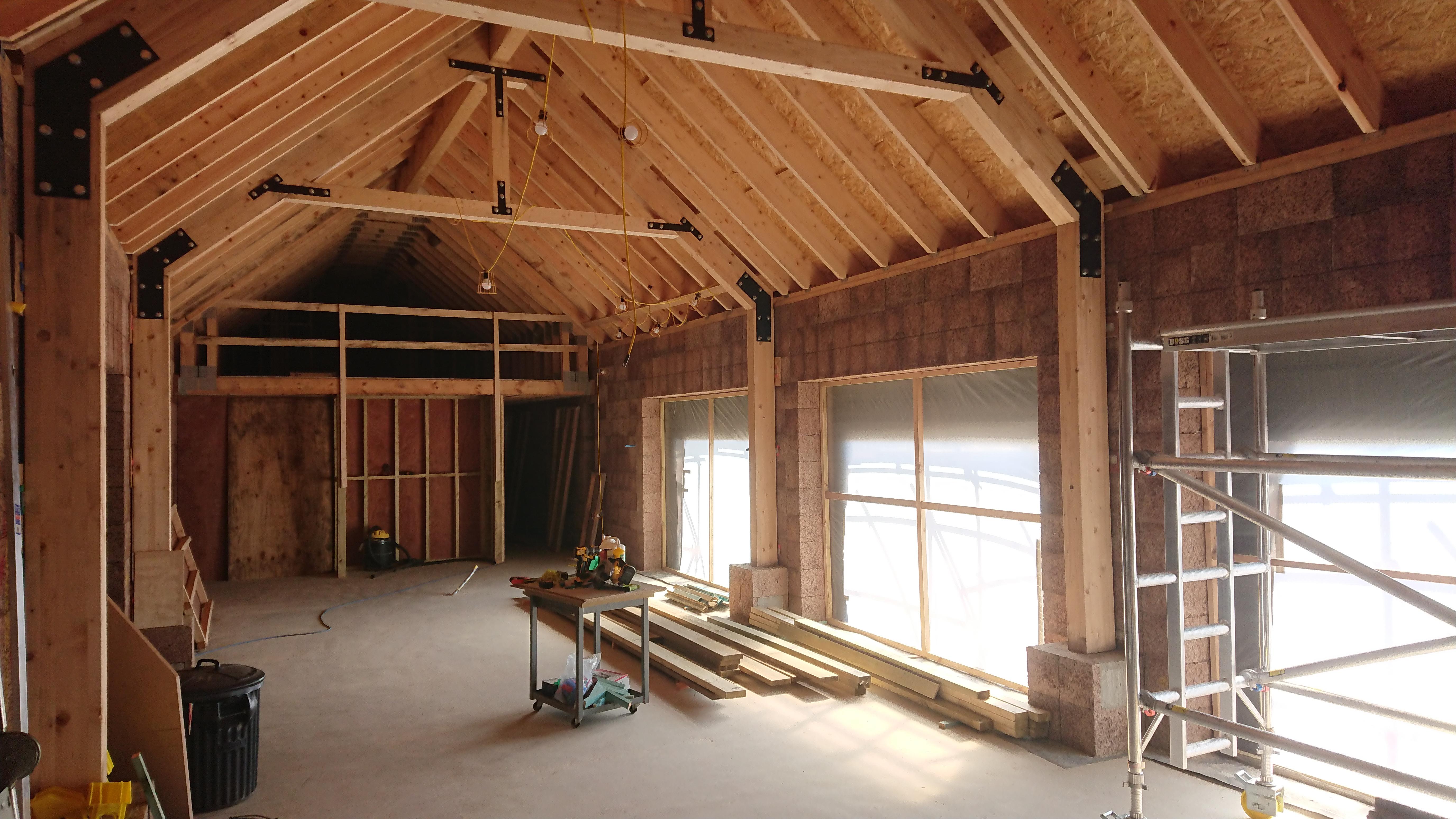

If anyone is interested in visiting just let me know. We will be on hold for a while whilst we try and sell our house to fund the remainder of the build. The Isotex blocks are very much on show internally - see attached picture.

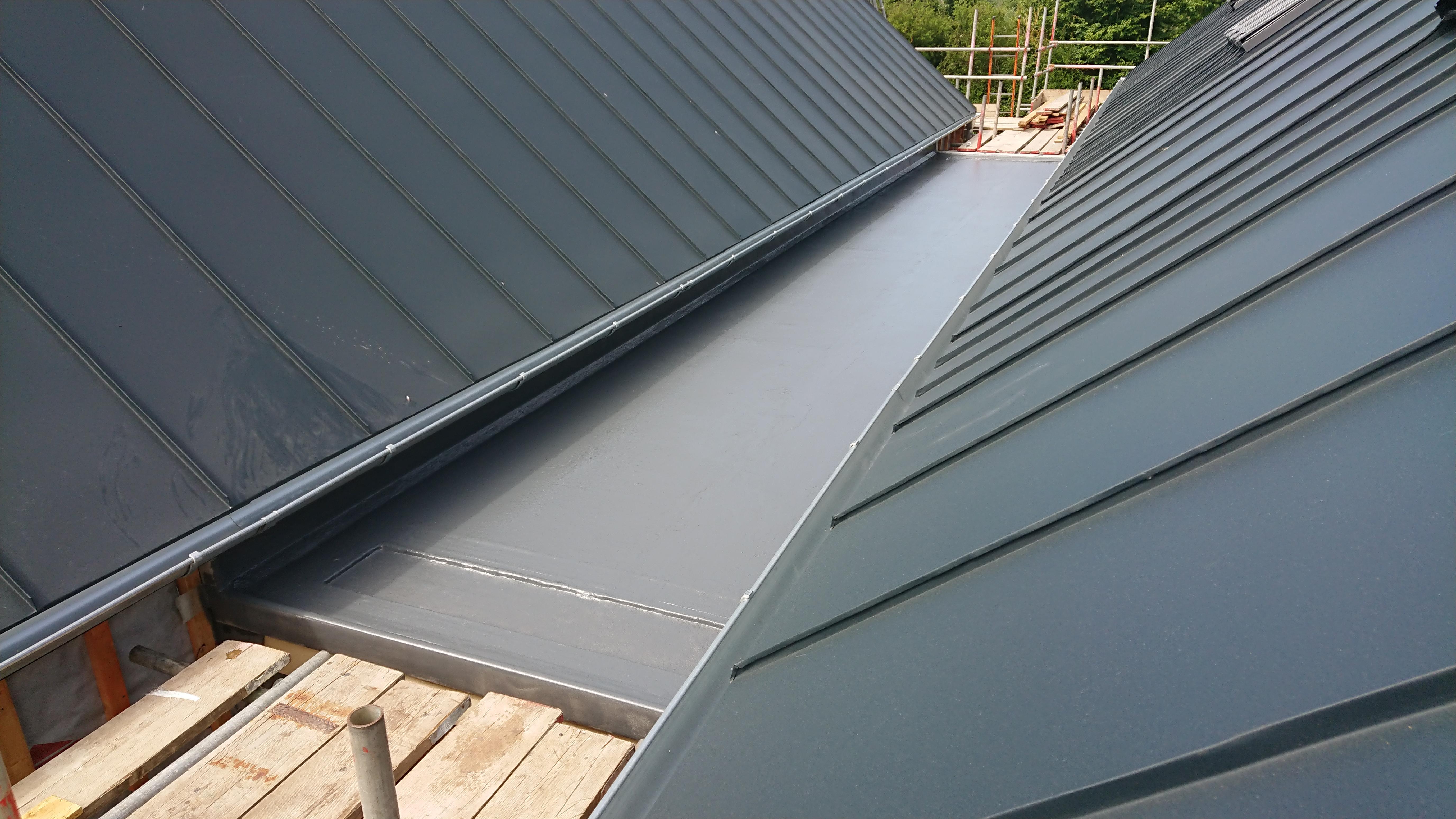

Also, I have dropped in a picture of a the largest box gutter roof I have ever built. The fibre glass is attached to a 36mm deck of OSB3 with a separating layer of VP400 (to reduce rain noise - separating the layers of board).

Hi Tom, Do the Isotex blocks fit flush with the cement foundations or do they straddle the foam block?
Hi Dave, they sit on the concrete slab mainly with the outer edge on foam. I hope that helps

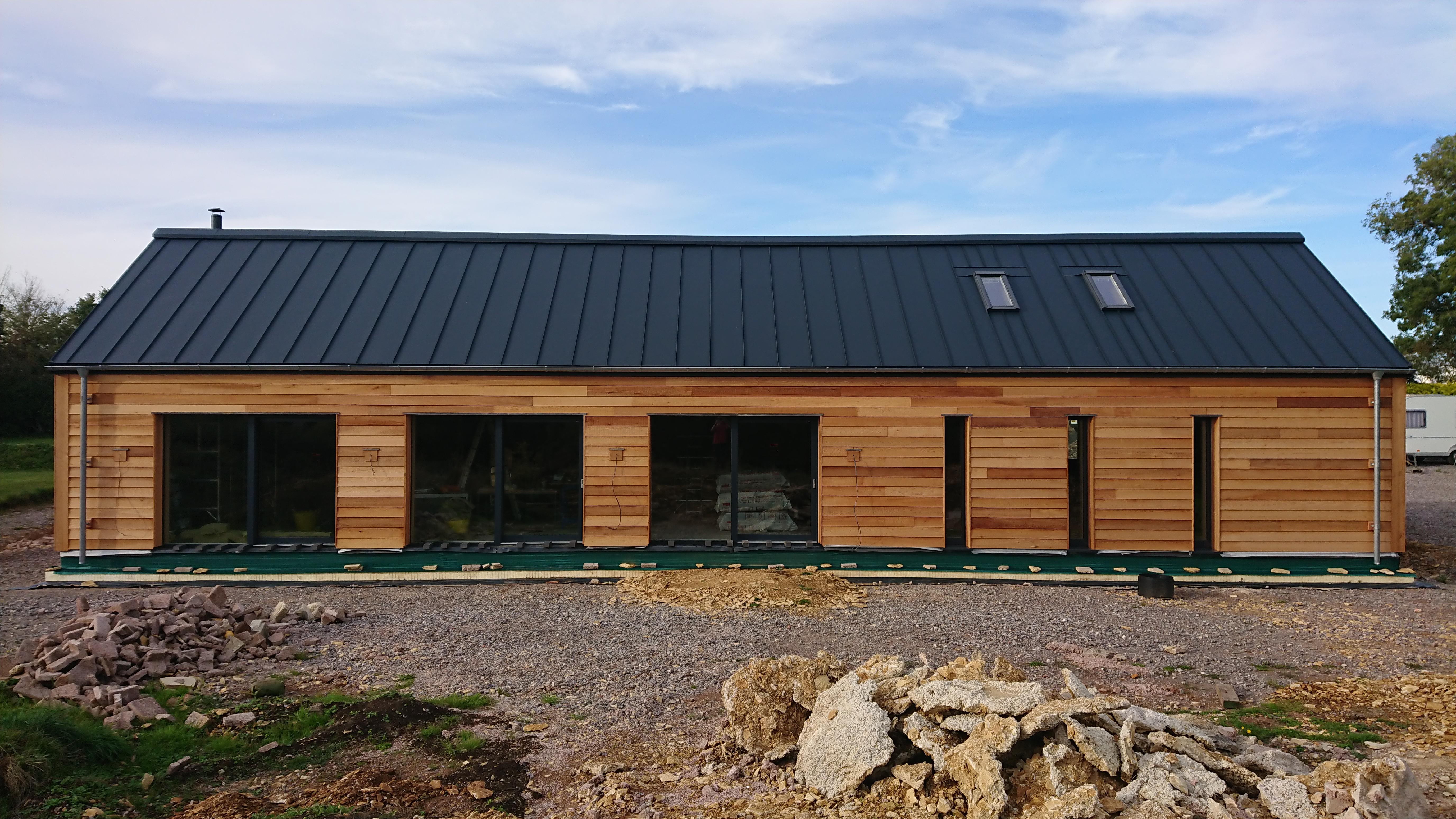

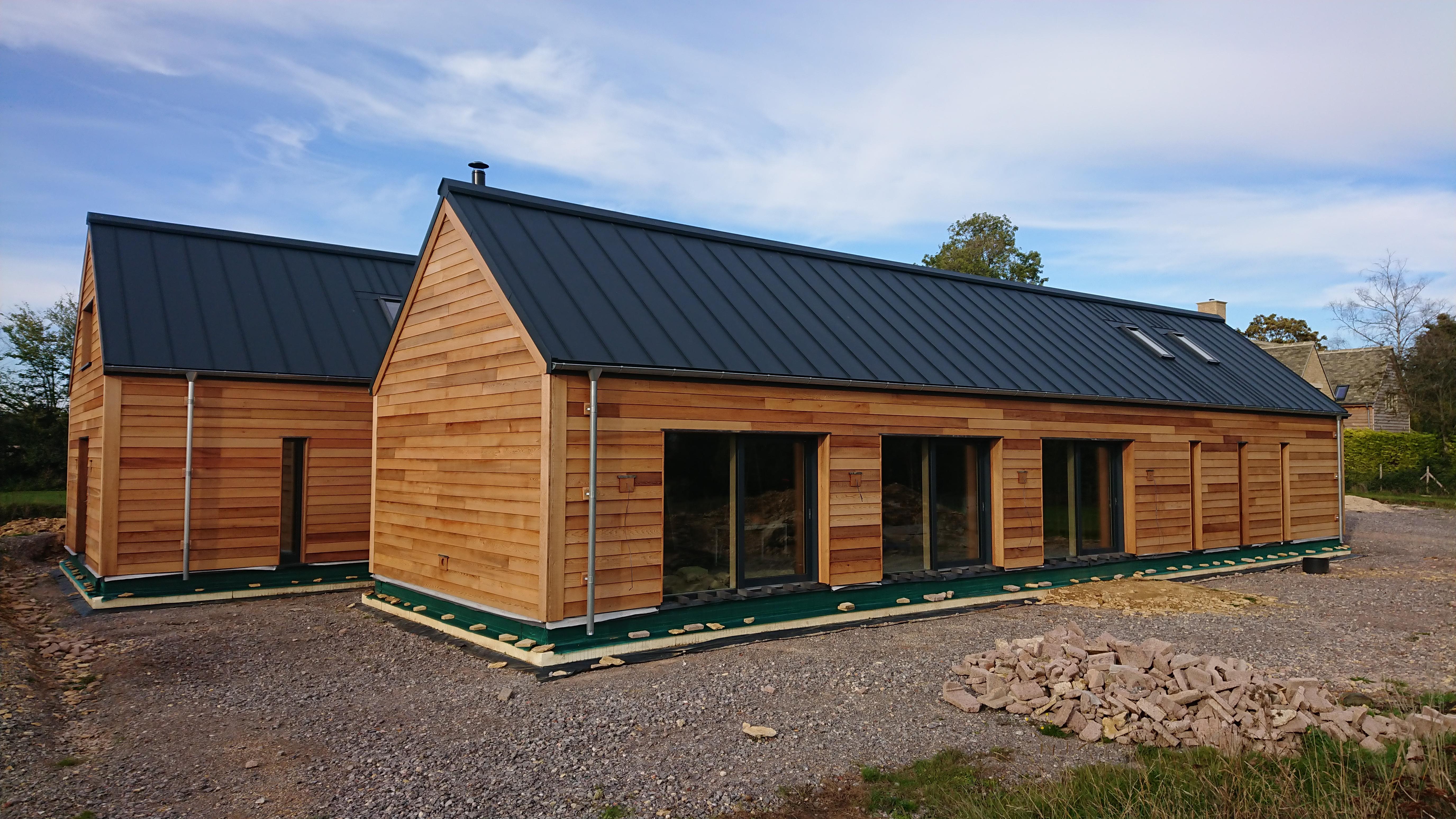

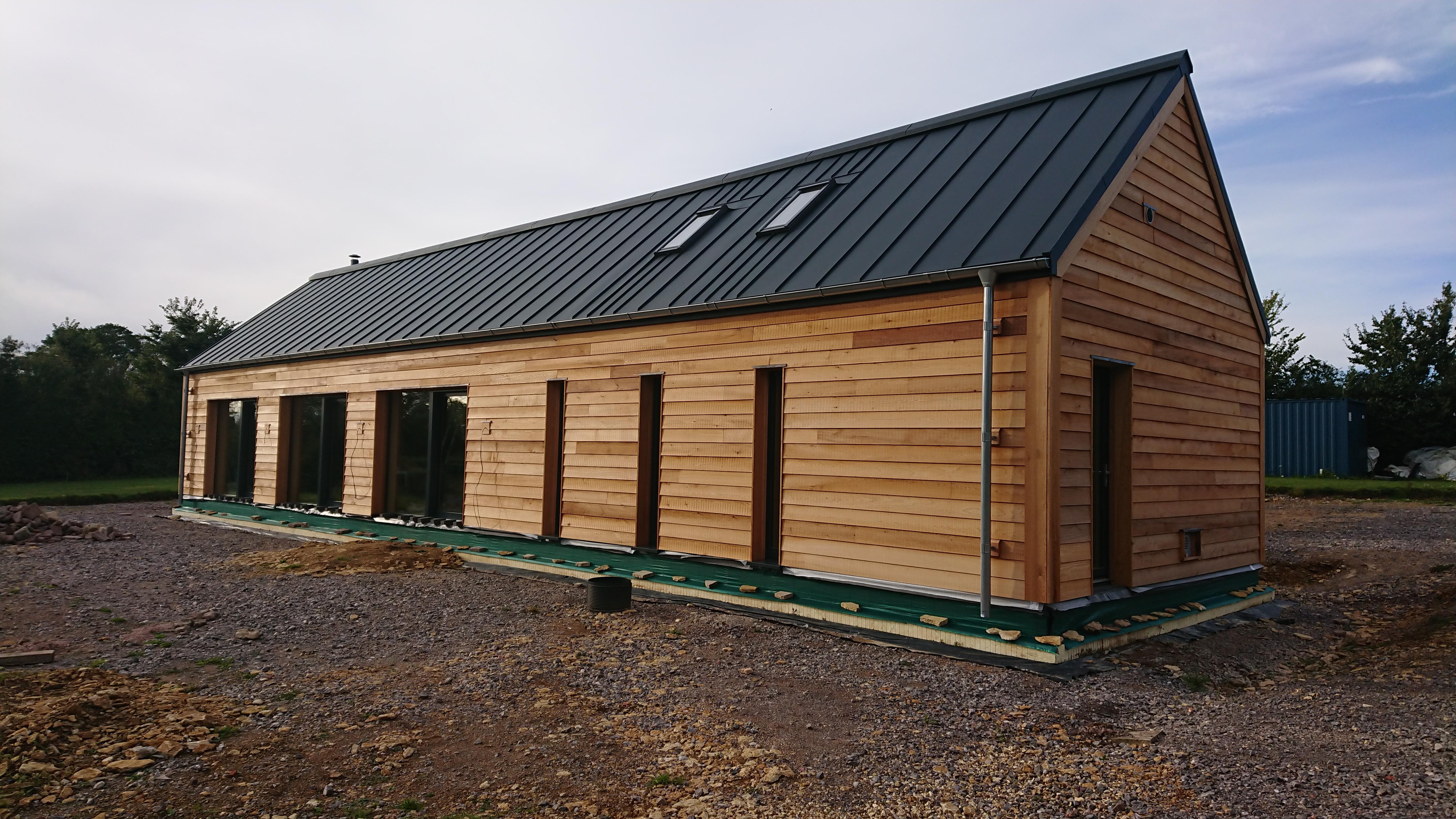

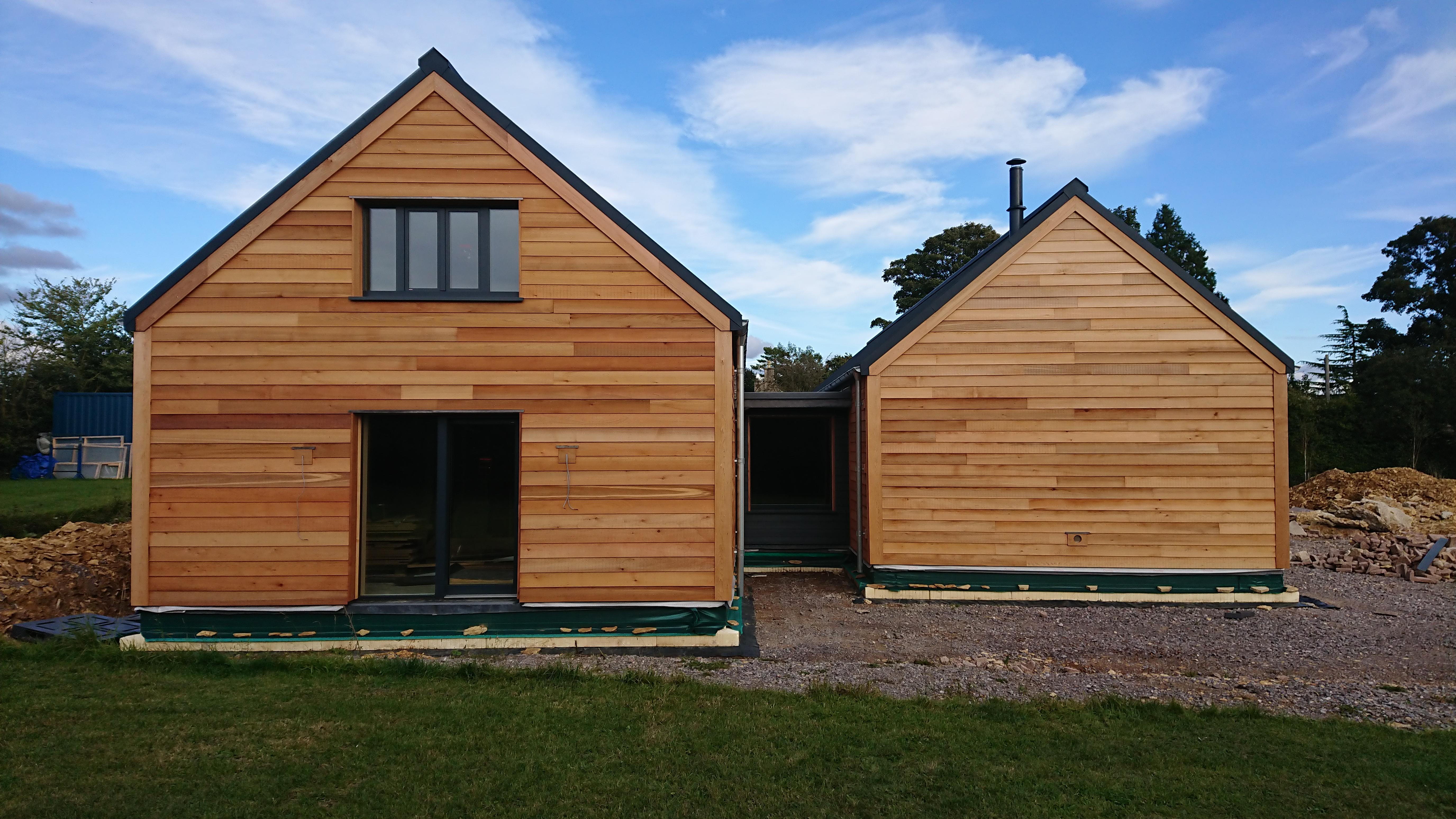

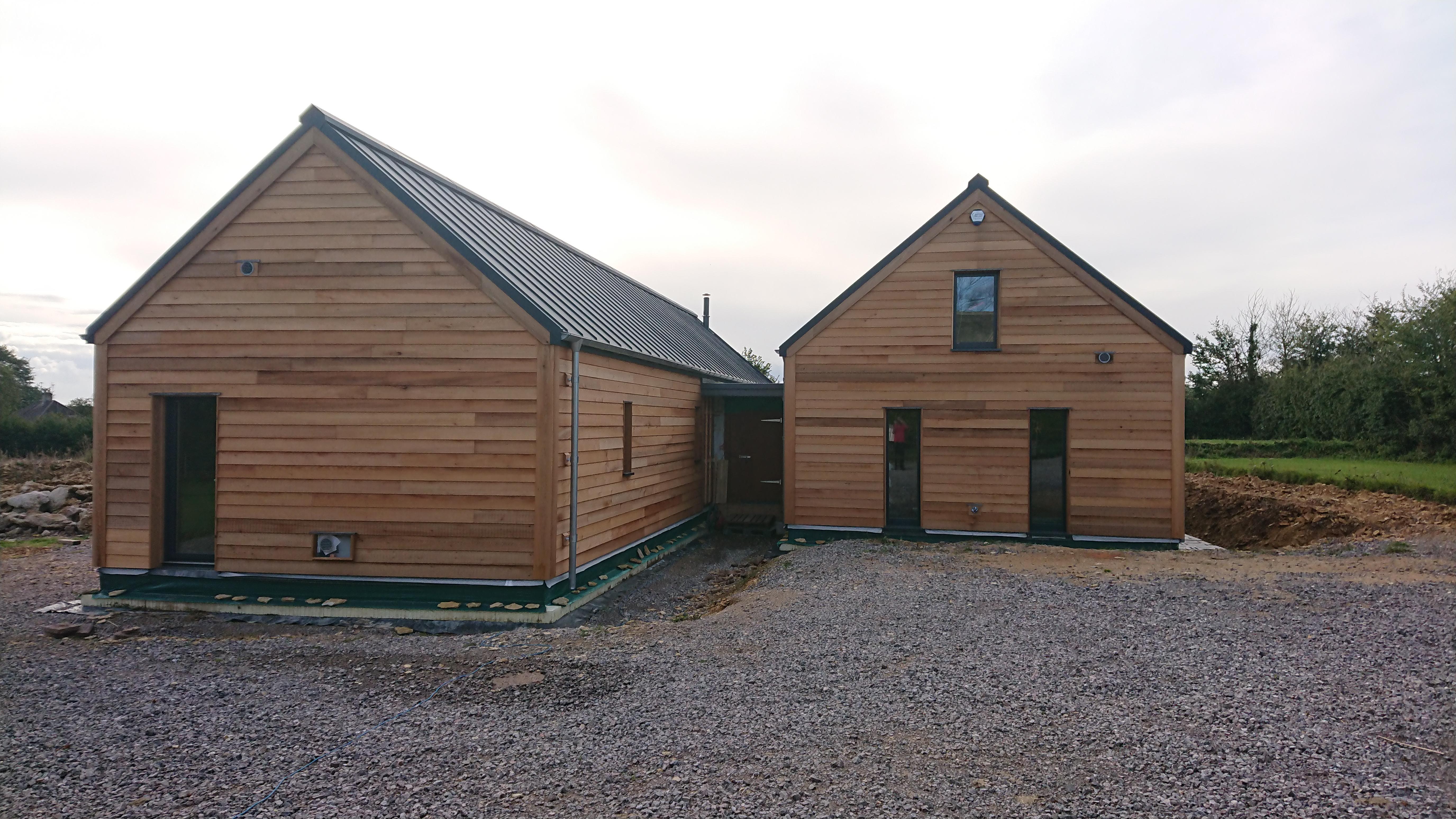

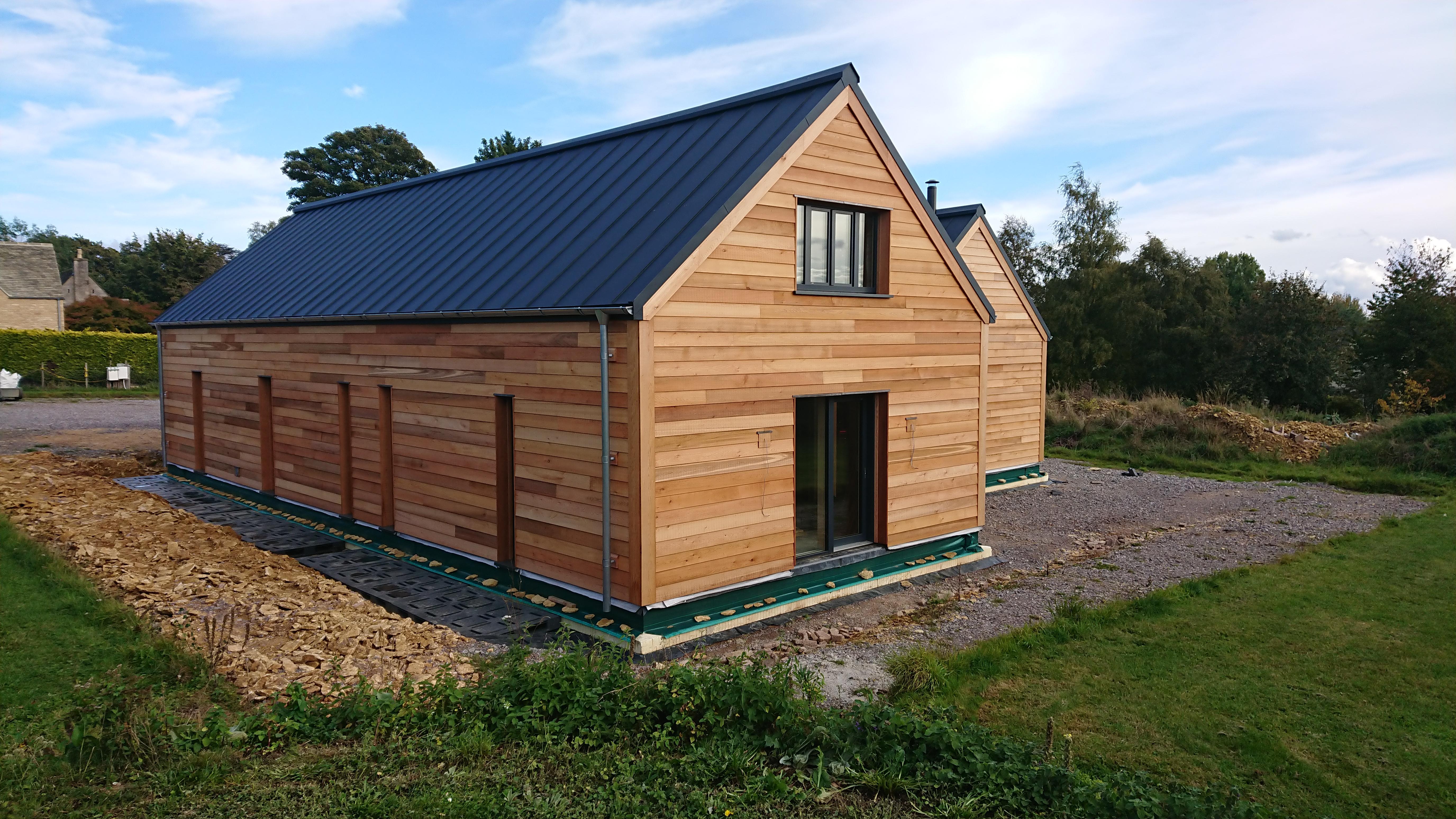

Ok a quick update.....the cladding is finally complete! We are just working on the first fix and internals now. The isotex is still very much on show internally if you would like to view. T

We're on the East London/Essex border. Have planning agreed to knock down our existing detached property and rebuild a new house with a basement. I started off wanting ICF but convinced myself to go traditional as I've worked on the tools before, although a very long time ago. After getting some pointers from the chaps on a different thread and seeing your posts and success, I'm swinging back to ICF.
I've seen a few post regarding bracing, did you use any?  Also did you use a vibrating poker ? when you poured the concrete?
Thanks
  • 4 weeks later...
Hi.....sorry no name....
Thank you for the feedback - a labour of love it was during construction and it will be for some time moving forward as we complete the fit out.
Bracing is required if you have about 6 to 8 courses to fill. However, with the onsite crane (the new approach) you can pour every 4 courses which means no bracing and less worry. The advantage of woodcrete over the plastic ICF is that it allows air and water to escape - leaving behind a strong concrete mix with no air gaps. Definitely the way to go.

We have been recommended to use PREFA aluminium for our single story low pitch (6 degree) roof. May I ask how, are you happy with the PREFA product, the quality and how its stood up to the winter?
Any thoughts much appreciated.
Graeme
Hi Graeme,
as per my personal note to you fully recommended but it is important to ensure you have someone who has worked with aluminium before because it is not like other metal roofing materials. It is as I said lightweight, durable, covered by a long manufacturer warranty, and easy work with.
One of the best features is the colour. No shine and 100% RAL 7016.
Everyone who has been passed the house has commented on how good the roof looks. I took the inspiration from many years in Austria - the home of Prefa.
Tom
