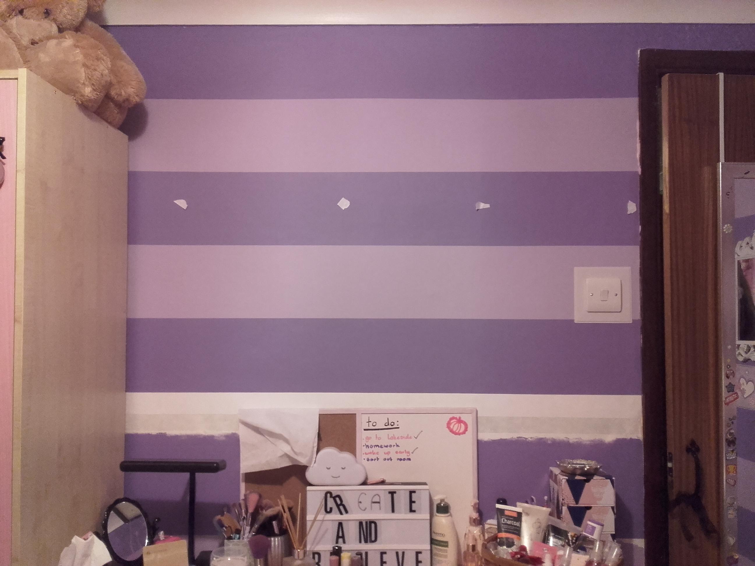

Hugely scientific this! By the heel of the palm method, 4x2 studs roughly where the white bits of paper are. Youngest wants me to mount her 32" LCD between wardrobe and light switch. I offered flat to the wall, she wants tilt and swivel!
Must be cheap!
Been looking at CPC but OMG the choice! Guessing I might have to affix say some thin Unistrut across 3 studs and fix the bracket to that?
Any suggestions?
