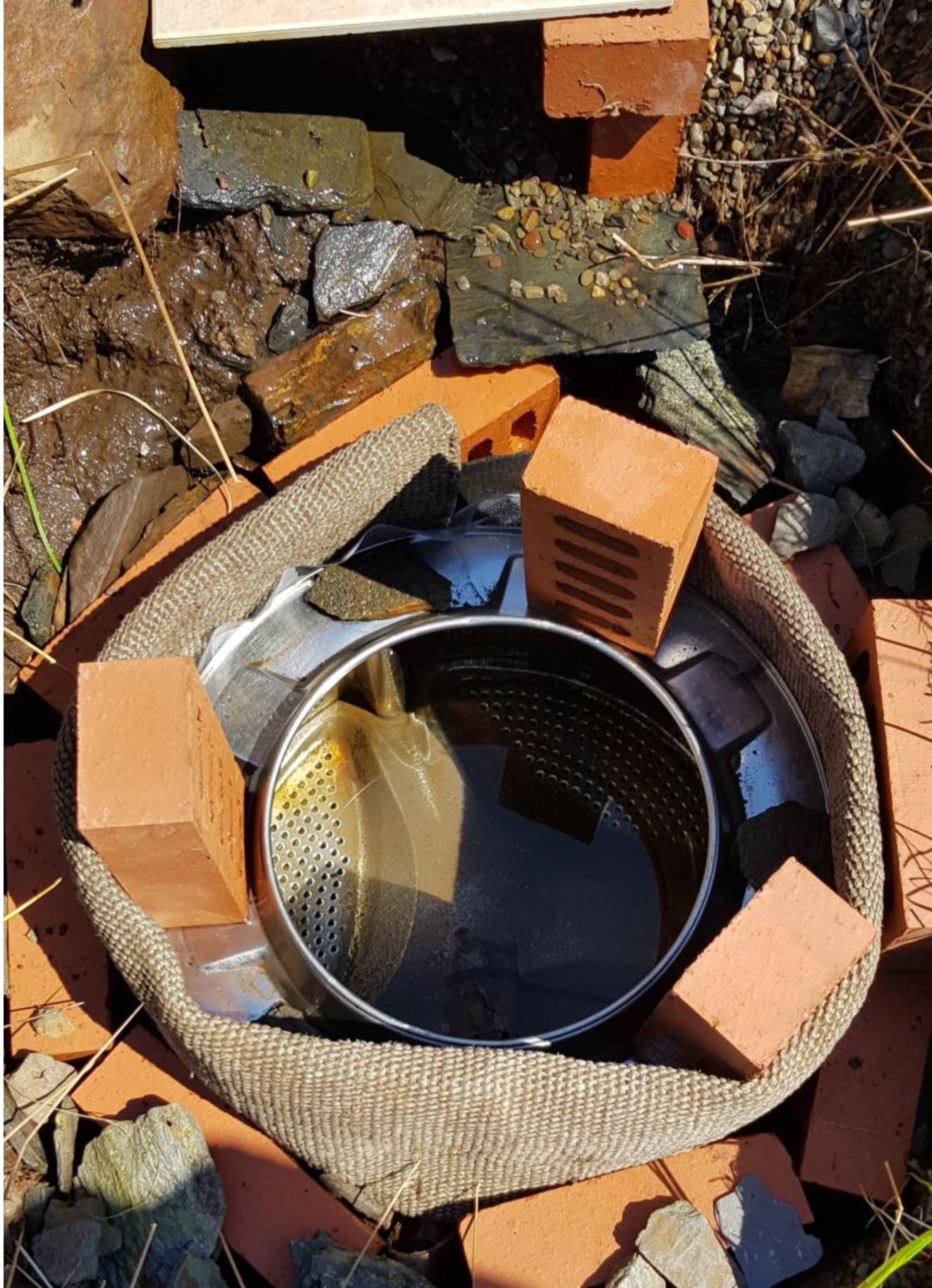

jamieled Posted January 7, 2019 Posted January 7, 2019 I'm currently looking at starting to install our water supply, and so ordering the bits and bobs I need. It will be fairly simple - a blue MDPE pipe from the burn to a storage tank above the house and then another MDPE pipe to the treatment for the house. I'm having trouble remembering the name of (and therefore sourcing) a bit for the intake. This will be the end of the submerged MDPE pipe in the burn. I know this as an intake rose, but builders merchants and an online search are not coming up with anything useful. It's essentially a perforated metal cylinder attached to the end of the pipe, to minimise vortexing, but mainly to minimise the ingress of any large debris. Has anyone got anything similar - if so by what name do you know it and where did you get it from?
Cpd Posted January 8, 2019 Posted January 8, 2019 Hahaha I used the inside of a washining machine drum ! Just drilled a hole for the pipe, I then put an additional home made stainless steel mesh filter over the end of the incoming pipe to stop other smaller particles getting in the pipe. Position the drum on top of a concreate slab or exposed bed rock to stop silt build up. I put a concreate slab on top (where the washing used to go in) so for maintenance I just lift up the slab pull off the mesh filter, pop a cork into the pipe pull out the drum and give it a good rinse. Put your intake hole about half way up the side. My water then goes into a sort of settlement / holding tank where I have the outfeed halfway up, overflow pipe at the top and a small hole in the bottom of one side so that there is a constant flow of water from the base of this tank, this stops sediment building up very well. I have not installed filters and uv yet but have been awarded a grant to do this in the next few months. The guy from council was totally impressed with my existing set up and told me to leave it all in situ as it was working very well. All my new fancy filters and stuff will be near the house. I am hoping that my washing machine drum and pre filters will prolong the life if the more expensive micro filter system still to be installed. Others with similar system complain about the cost of replacement filters all the time, this is because they take directly from a water source without pre filtration.
Miek Posted January 8, 2019 Posted January 8, 2019 (edited) Like this? I did the same a few years back for a private water supply. Been working for 4 years without a blockage. Looks a bit messy at first Edited January 8, 2019 by Miek 1
Cpd Posted January 8, 2019 Posted January 8, 2019 (edited) @Miek that’s axactly the thing, I lined my muddy hole with bricks, pea gravel and geo textile six years ago, yes it was a messy job to start with but the water is VERY clear and tastes GREAT I get no less than 8500 litres every 24 hrs from my supply. The guy from council said “Lovely spring water full of lovely things so passing except for the odd floating bit which filters will sort out.” Water with added fibre ! But in reality the floating bits were of no concern to him as the test results were so good but to meet best practice we need uv and very fine particle filters. Edited January 8, 2019 by Cpd
jamieled Posted January 8, 2019 Author Posted January 8, 2019 Thanks both, food for thought. I'd need to modify this a bit for working in our burn as it's quite flashy, lots of cobbles and boulder movement which will need considered as I think something that big will get a bit battered quite quickly. But the responses so far are making me think a DIY approach is the way I'll go.
Miek Posted January 8, 2019 Posted January 8, 2019 If you could completely bury the drum under the bed of the burn it might work, though appreciate that this could be difficult. If the burn is clean of debris or leaves I'd have thought a simple gauze strainer on the end of the pipe would suffice. If there is crap in it then this might get blocked. I hope you intend to treat the water in some way as surface water from streams can be nasty depending what's up stream, sheep for example, liver fluke and wot not..
jamieled Posted January 9, 2019 Author Posted January 9, 2019 It may well be possible to bury the drum so I'll have a think. Around here it's a condition of PP that treatment is installed and I think may well be the case nationally as I've done a few private water supply assessments in a professional capacity. In our case it will involve a three stage cartridge filter to remove the bits, an iron filter and a UV filter.
