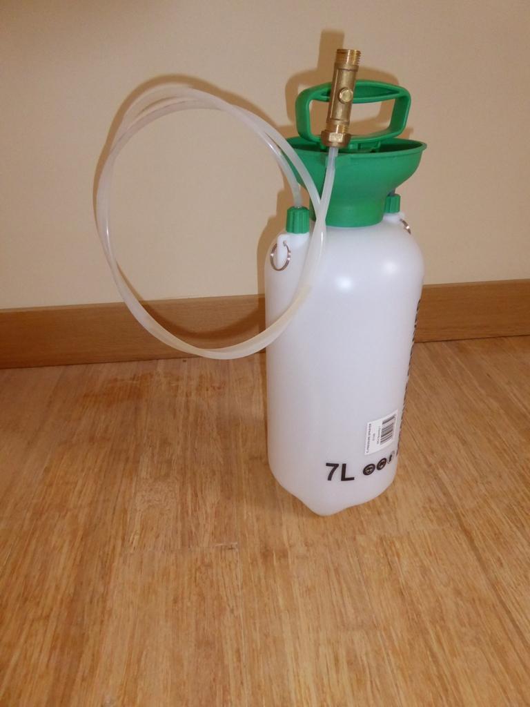

Jeremy Harris Posted November 23, 2018 Share Posted November 23, 2018 As long as the buffer tank is run indirectly (i.e. with a coil) then the antifreeze volume can be very small. I used about 5 litres of the stuff to get the right concentration in our ASHP, as the antifreeze inhibitor is only in the ASHP, buffer coil and UFH loops, so not a lot of volume. To pressurise the system I used a modified garden sprayer, fitted with a new 8mm LDPE pipe (luckily a perfect fit in the pump bottle gland) and terminated that with a 15mm double check valve, using an 8mm to 15mm compression adapter. This then fits directly to a standard flexible fill loop hose with fill valve: This will pump up to a few bar, so can be used for leak testing as well as filling and pressurising. Link to comment Share on other sites More sharing options...
