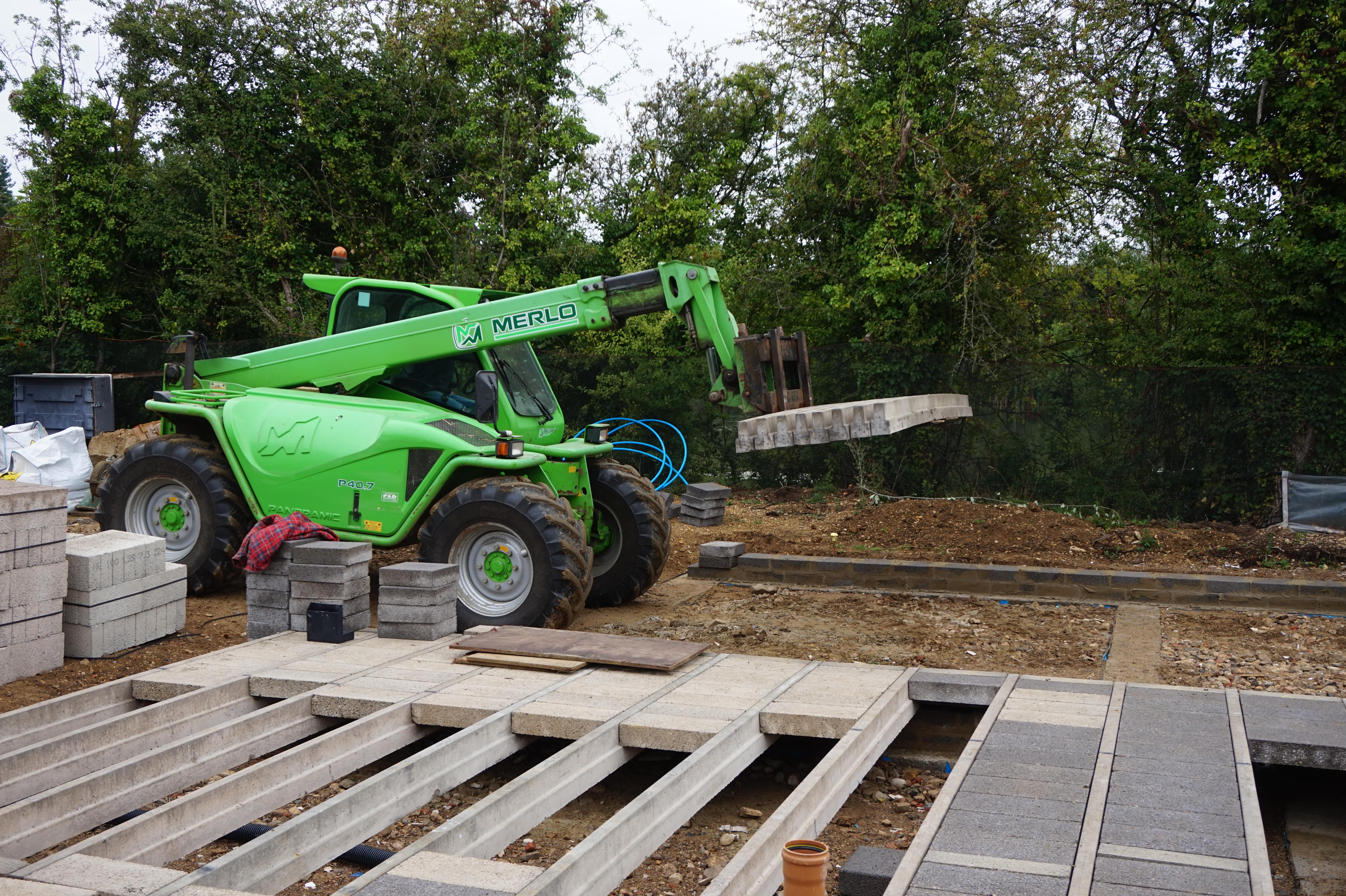

tomie2x Posted November 15, 2018 Posted November 15, 2018 This will be my second self-build. Having previously built with a suspend timber ground floor I am thinking about using a concrete block and beam ground floor construction, I hope to gain a more solid construction, this method also suits my resources just now. Can anybody give me any advice on building with these materials?
PeterW Posted November 15, 2018 Posted November 15, 2018 Welcome ..! What are the ground conditions below the floor and what foundations..? Any reason for not using a ground bearing insulated slab..??
Temp Posted November 16, 2018 Posted November 16, 2018 I persuaded my builder to use B&B on both floors. He'd never done a first floor but said he liked it as it went down quick and no issues with weather. Made tiling our bathroom easy.
Russell griffiths Posted November 16, 2018 Posted November 16, 2018 Ours went in a month ago and was very straightforward Things I liked. Pipe placement was easy and allowed me to move a pipe I wasn’t happy with, has given me a working platform that doesn’t contain any underfloor heating that could get damaged as I have a hundred fixings to go in the floor to hold up my bracing for the icf walls. Things I don’t like. large cold void under the floor, increased height of finished floor.
tomie2x Posted November 17, 2018 Author Posted November 17, 2018 Hi and thank for your reply. Can you tell me if you had to use a specialist company to design the layout of the beams and do you have a rough cost of materials for the concrete beams? Thank you.
Russell griffiths Posted November 18, 2018 Posted November 18, 2018 Hi block n beam company do the design, just send them a floor layout, I picked my company by location as I new delivery would be a large cost, I used rackam house floors. 160m cost about £2000 without blocks, lightweight blocks 70p each.
