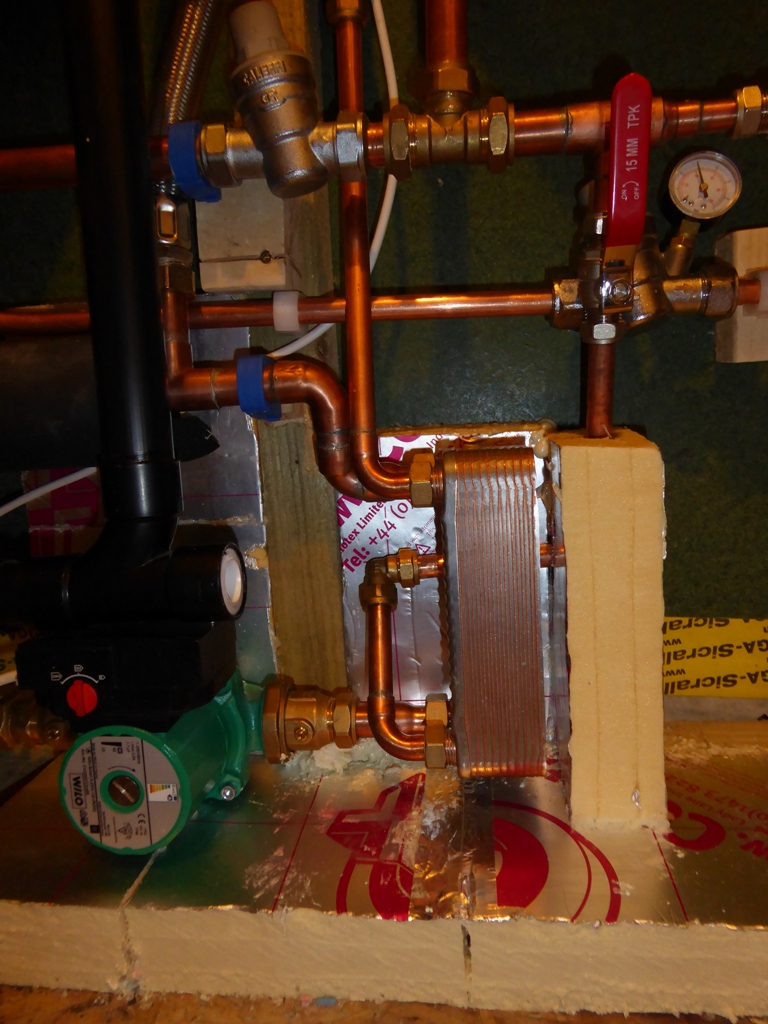

readiescards Posted October 11, 2018 Share Posted October 11, 2018 I have a Hrale Stainless Steel Heat Exchanger 30 Plates max. 125 kW Plate Heat Exchanger installed in a cupboard. However there seems to be no matching insulating kit available for this device. Any suggestions on how to insulate - or just live with a jolly warm cupboard? Link to comment Share on other sites More sharing options...

Jeremy Harris Posted October 11, 2018 Share Posted October 11, 2018 I made an insulated box for ours, using 50mm PIR foam and aluminium foil tape. Seems to work OK and wasn't hard to make. I glued the foam pieces together with low expansion gun foam, then neatened up the outside with the aluminium tape so it looked tidy: 1 Link to comment Share on other sites More sharing options...

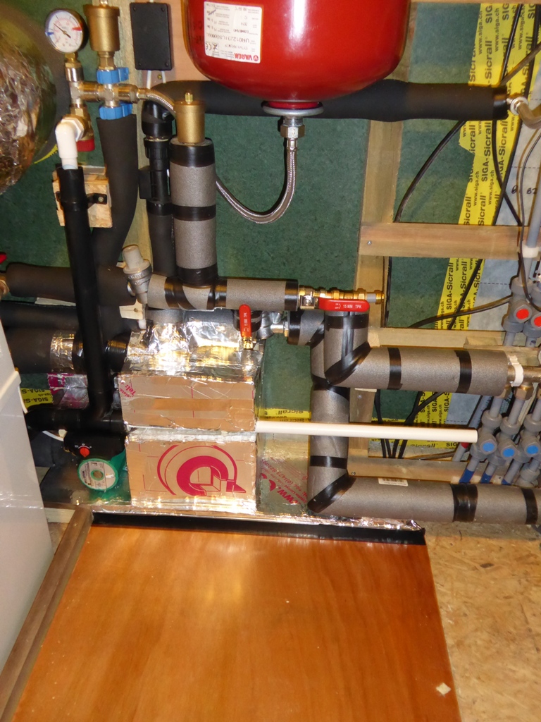

readiescards Posted July 2, 2019 Author Share Posted July 2, 2019 Transfers heat between two separate systems. I made an insulated jacket out of a bit of cast off under floor insulation. Amazing it helped get rid of a lot of noise too Link to comment Share on other sites More sharing options...
