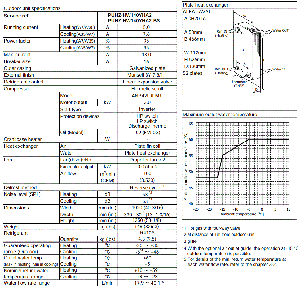

Jeremy Harris Posted October 9, 2018 Posted October 9, 2018 IIRC, the 3 phase models were late to shift to inverter control. This makes sense, as an inverter controlled unit has a three (sometimes more) phase motor. They rectify the incoming AC to DC, then drive the multi-phase motor with the inverter drive, which is really a variable frequency AC drive. For a 3 phase inverter controlled unit, the 3 phase would be rectified to DC, then used to drive the motor variable frequency inverter. From the symptoms described, with a shorted motor phase, it sounds like direct AC drive to me. One "feature" of variable frequency drives is that they rarely, if ever, damage the motor; the electronics in the drive unit tends shut down a hell of a lot faster than a motor under fault conditions, and will usually just instantly fail. I've built a lot of variable frequency motor drives, for things like my electric motorcycle, electric bikes and an electric boat and have yet to damage a motor (and all my motors are three phase machines in essence). I've blown a fair few motor controllers, though, until the current generation, where there is so much protection built in that the controller just shuts down within a µs or two if a problem develops (or if I do lunatic things on the motorcycle - hard not to when you have 100% torque at zero rpm...). 1
jack Posted October 9, 2018 Author Posted October 9, 2018 I got hold of the model number. According to the data sheet it's inverter driven (note: I may have been misremembered the comment about the short circuit being on one coil):
