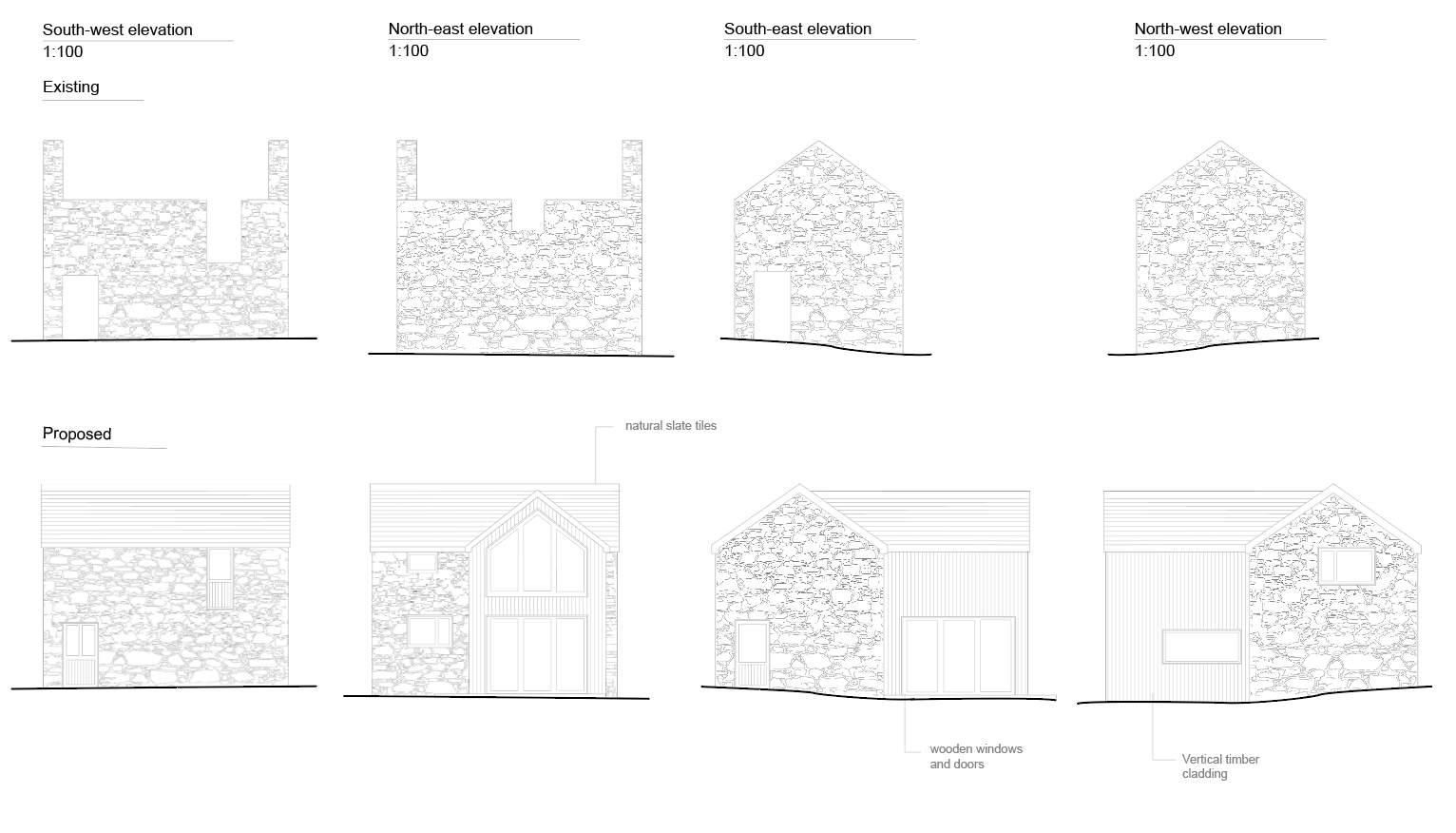

Roz Posted September 19, 2018 Posted September 19, 2018 (edited) Hi everyone, Realised I never did one of these intro posts so thought I should say hello and thank you for having me, seeing as it looks like I'll be having lots of questions! We're just waiting for our planning permission to come through (fingers crossed - planners have implied they support it) in a few weeks after lots of pointless surveys and delays, but hopefully we will get there in the end. We have a very small old granite barn, that looks a lot worse than it structurally is. We're hoping to convert and extend it into a 2 bed modest home, plus build an insulated workshop/office in the garden. Attached is a quick screenshot of our elevation plans! Would welcome any suggestions of suppliers and tradespeople in Cornwall. Thanks again for all your advice and support. Edited September 19, 2018 by Roz addition

PeterW Posted September 19, 2018 Posted September 19, 2018 @Roz how close is the studio to the house..? Could be a candidate for your plant room..?
Roz Posted September 19, 2018 Author Posted September 19, 2018 55 minutes ago, PeterW said: @Roz how close is the studio to the house..? Could be a candidate for your plant room..? It's about 5.5 metres. I was reading about having water tanks and boilers in garages etc and people kept recommending it was a waste of heat for the hot water to travel any distance. What do you think?
newhome Posted September 19, 2018 Posted September 19, 2018 5 minutes ago, Roz said: It's about 5.5 metres. I was reading about having water tanks and boilers in garages etc and people kept recommending it was a waste of heat for the hot water to travel any distance. What do you think? Not sure about the travelling aspect but I find that any heat losses from the hot water tank in my house directly contribute to the temperature of the house so it’s not wasted. Depends what system you have but I would definitely notice the difference if my thermal store was outside somewhere.
PeterW Posted September 19, 2018 Posted September 19, 2018 5.5m is nothing - I've seen internal garages wider. You just use an insulated buried pipe and for hot water you use a bronze circulation pump.
