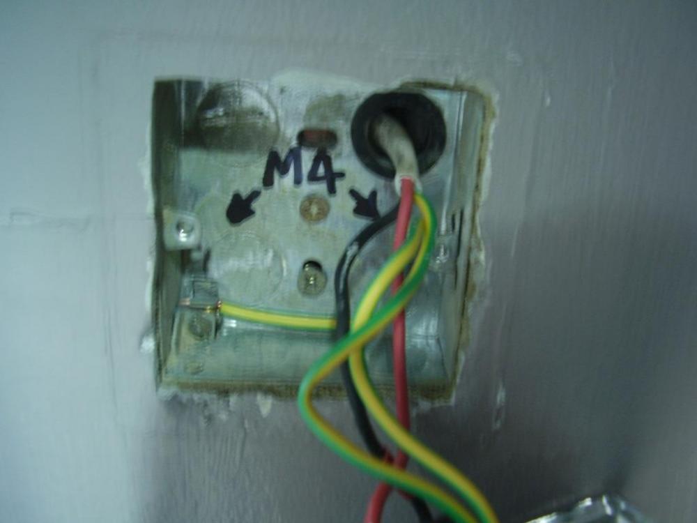

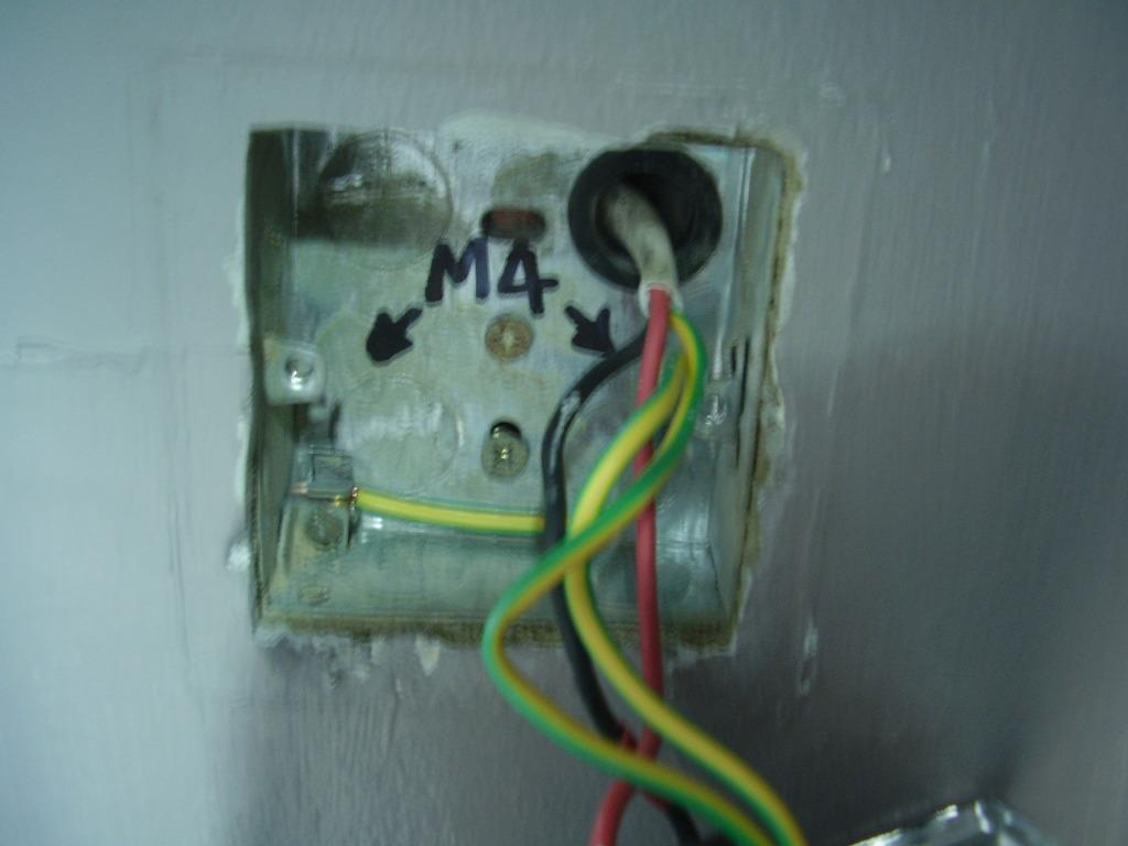

Onoff Posted September 17, 2018 Posted September 17, 2018 You might have to drill out slightly the face plate / countersink a bit deeper if using M4 screws as the heads can be bigger than M3.5 electrical screws. Otherading tools are available: https://cpc.farnell.com/draper-tools/37924/rethreading-tool-m4-0-x-0-7/dp/TL04580 Crap pic but I Sharpie the back of the box if I do it so the next person is aware:
