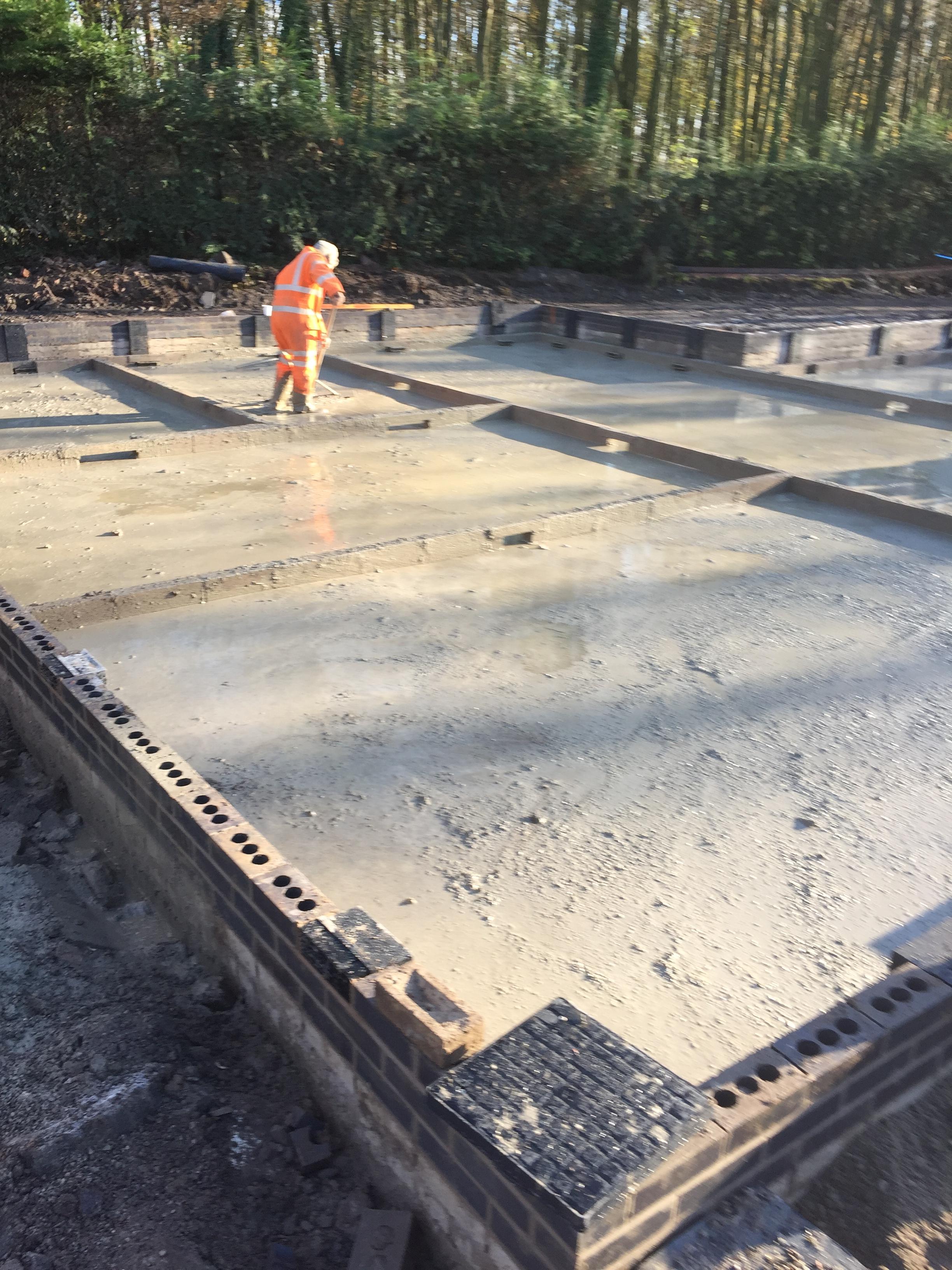

epsilonGreedy Posted August 29, 2018 Share Posted August 29, 2018 I am about to lay the inner wall telescopic portions for my suspended floor ventilation. Should I think ahead and ensure that when these vents are mated with airbricks the positioning of airbricks occurs at whole brick boundaries in the outer wall? Link to comment Share on other sites More sharing options...

epsilonGreedy Posted August 29, 2018 Author Share Posted August 29, 2018 1 minute ago, Mr Punter said: Can you leave a wider gap on the inner leaf so you have a bit of room for adjustment? Not sure I am following this advice. The problem as I see it is that the block & beam floor will be down before the outer wall reaches dpc height and it is time to fit the airbricks. Link to comment Share on other sites More sharing options...
nod Posted August 29, 2018 Share Posted August 29, 2018 It’s much easier to build your outer skin up before the B&B goes in I set mine every eight bricks But moveved around a bit to keep them looking uniform near corners etc Link to comment Share on other sites More sharing options...
epsilonGreedy Posted August 29, 2018 Author Share Posted August 29, 2018 3 minutes ago, nod said: It’s much easier to build your outer skin up before the B&B goes in Ok. My thinking was a higher outer wall would be at risk from collision as beams are maneuvered plus if this is done manually the beams need to be lifted higher. I am not committed either way yet. Are there other benefits for doing the outer skin first up to dpc which in my case is 300mm aove ground rather than a standard 150mm. Link to comment Share on other sites More sharing options...

nod Posted August 29, 2018 Share Posted August 29, 2018 20 minutes ago, epsilonGreedy said: Ok. My thinking was a higher outer wall would be at risk from collision as beams are maneuvered plus if this is done manually the beams need to be lifted higher. I am not committed either way yet. Are there other benefits for doing the outer skin first up to dpc which in my case is 300mm aove ground rather than a standard 150mm. We did the in and outer to dpc level and simply lifted the beams in and lowered them onto the inner skin None of the face work was disturbed Two hours and they were all in 1 Link to comment Share on other sites More sharing options...
epsilonGreedy Posted August 29, 2018 Author Share Posted August 29, 2018 2 minutes ago, nod said: None of the face work was disturbed Two hours and they were all in Good to know, I suppose outer-first will be kinder to the brickie's back if the outer engineering face bricks can be laid while standing on the lower ground oversite. Link to comment Share on other sites More sharing options...

epsilonGreedy Posted August 29, 2018 Author Share Posted August 29, 2018 54 minutes ago, Mr Punter said: We put lintels over the vent gaps on the inner leaf. Ok I can picture this now, something to consider. Is it common practice to take special measures when beam ends are sited near air brick vents? Underfloor void ventilation building standards must cope with terraced houses, I wonder if the whole issue can be sidestepped by fitting air vents on opposing walls at 90 degrees to the beam orientation. Taking into account all responses here I reckon I will put in the first two courses of below dpc facing bricks. This will then provide a gauge for positioning the inner ducts and in addition I will ensure the ducts are positioned within the 500mm pitch of the beam spacing. I might even take the facing bricks up to 6 courses high before swinging the beams into position because having laid 80 trench blocks for the garage I am full of empathy for the brickie's back. Link to comment Share on other sites More sharing options...
