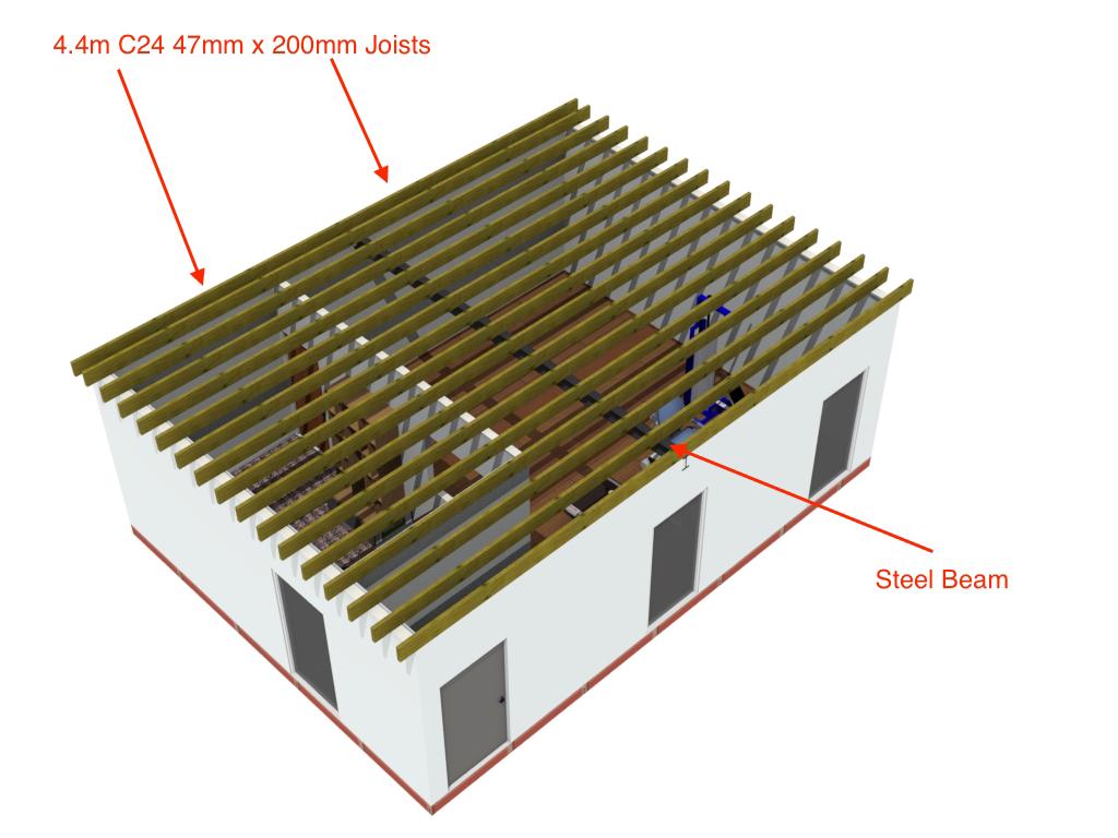

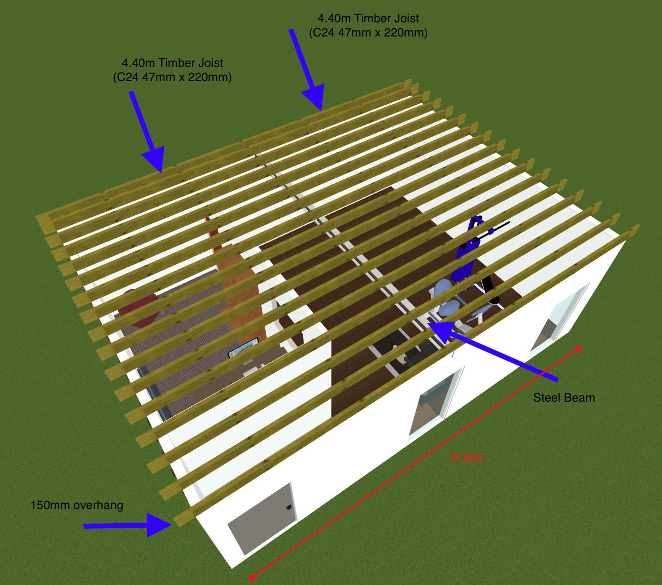

hmpmarketing Posted August 15, 2018 Author Share Posted August 15, 2018 (edited) So right now this is the idea for the flat roof joists (joists 47mm x 220mm max span 4.91m) + steel/flitch beam, 400mm spacing, looks good? Edited August 15, 2018 by hmpmarketing 1 Link to comment Share on other sites More sharing options...

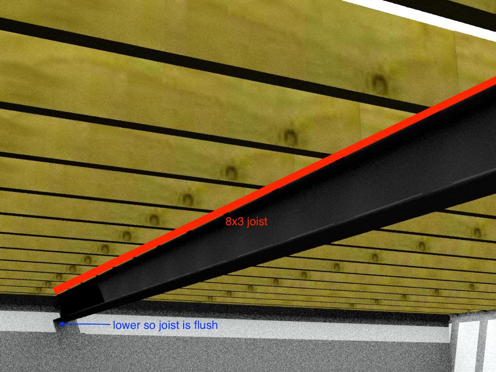

Nickfromwales Posted August 15, 2018 Share Posted August 15, 2018 For the joists to stop / start over the flitch you'd need a 8x3" joist above the flitch ( running in line with it ) and the timber ends would need to be mechanically fixed to the extra joist. You'd then have to noggin between the ceiling joists near to the beam to keep things true. Link to comment Share on other sites More sharing options...
Nickfromwales Posted August 15, 2018 Share Posted August 15, 2018 You'd have a deep void between joists for lights ! Keep the ceiling high IMO. Link to comment Share on other sites More sharing options...
hmpmarketing Posted August 15, 2018 Author Share Posted August 15, 2018 7 minutes ago, Nickfromwales said: You'd have a deep void between joists for lights ! Keep the ceiling high IMO. Sounds interesting, just trying to understand the joist ends that meet the left/righ walls would need to be raised too (another 8x3 running along the wall line)? Link to comment Share on other sites More sharing options...
Nickfromwales Posted August 15, 2018 Share Posted August 15, 2018 Raised ? What for ? Link to comment Share on other sites More sharing options...
hmpmarketing Posted August 15, 2018 Author Share Posted August 15, 2018 (edited) maybe Im misunderstanding.... so the flitch/beam would not be flush to the wall, but the 8x3 joist above? Edited August 15, 2018 by hmpmarketing Link to comment Share on other sites More sharing options...

hmpmarketing Posted August 15, 2018 Author Share Posted August 15, 2018 1 minute ago, Nickfromwales said: Already suggested but issues with the cold bridge unless a lot of insulation goes over it. So @Nickfromwales my drawing above is exactly what you suggested with the 8x3? Link to comment Share on other sites More sharing options...
Nickfromwales Posted August 15, 2018 Share Posted August 15, 2018 1 hour ago, hmpmarketing said: maybe Im misunderstanding.... so the flitch/beam would not be flush to the wall, but the 8x3 joist above? Ok. Your pic shows 2x 4m timbers making up the 8m span. That I assume means your showing the break in the run on top of the 6m steel ? You cannot have the break there unless the joints are mechanically fortified. Regs will ask for a certain distance for the joists to sit on the steel so the ends on the joists don't compress under the weight. The 8x3" would be in the middle of the steel, sat on top, running along its length and positioned vertically. The joists would then be made off into joist hangers affixed to the 8x3. Clear as mud ? I'll do a pic if your not sure. Link to comment Share on other sites More sharing options...
