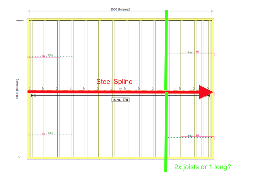

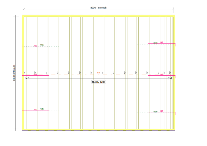

hmpmarketing Posted August 14, 2018 Author Share Posted August 14, 2018 (edited) Also @PeterW where do you get off the shelf JJI-Joists to cover that 6m span + overhangs? I was quoted £1,539 (ex vat) from FForest TImber (21 joists ) and Minera quoted me £1,421 (ex vat) (15 joists) but these are either in-built or need hangers, dont take into account the overhangs required Edited August 14, 2018 by hmpmarketing Link to comment Share on other sites More sharing options...
PeterW Posted August 14, 2018 Share Posted August 14, 2018 Garrards hold them but they may be a bit far for you. You could go with a standard joist but would need a steel across the middle to split it to two 4m spans - 8x6m is a big problem with standard timber ! 1 Link to comment Share on other sites More sharing options...
hmpmarketing Posted August 14, 2018 Author Share Posted August 14, 2018 On 14/08/2018 at 11:48, PeterW said: Garrards hold them but they may be a bit far for you. You could go with a standard joist but would need a steel across the middle to split it to two 4m spans - 8x6m is a big problem with standard timber ! Expand I see, well, delivery charges down to chichester would not be that much? standard timber to cover the 6m length would be too heavy as well! Link to comment Share on other sites More sharing options...
Nickfromwales Posted August 14, 2018 Share Posted August 14, 2018 I was just going to say steel spine and normal joists but @PeterW beat me to it. Steel will be better and quicker IMO with no need for extra detailing with the pozi joists required. Just drop them in as your building the walls up. Cheap enough and logistically simpler. Link to comment Share on other sites More sharing options...
Nickfromwales Posted August 14, 2018 Share Posted August 14, 2018 I'd go for the deeper thermalite and 75mm insulated stud work with 30mm insulated plasterboard over the studs. Warm as toast. Link to comment Share on other sites More sharing options...
hmpmarketing Posted August 14, 2018 Author Share Posted August 14, 2018 (edited) Like this @PeterW @Nickfromwales ? Steel spline sitting or inbuilt into blockwork? Long timber joist or 2x shorter ones? (need overhangs of 150mm sides and rear, 500mm front) Edited August 14, 2018 by hmpmarketing Link to comment Share on other sites More sharing options...

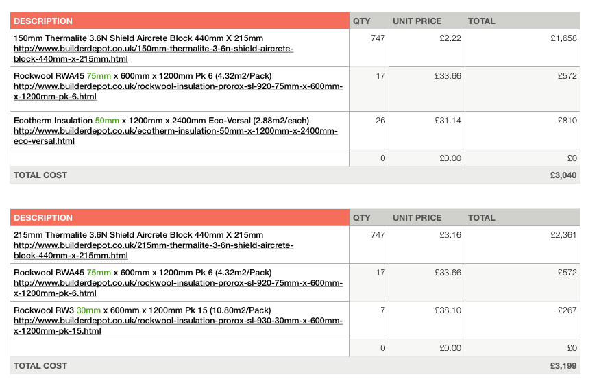

Declan52 Posted August 14, 2018 Share Posted August 14, 2018 Anything over a 150mm wall won't need any piers so that's your starting point. Price up standard 150mm block and 75mm insulation between the stud and 50mm over the studwork. Then price up the thermalites with 75mm and 25/30mm and see what suits the wallet best. How are you finishing the outside. Sand cement and painted white or something like krend to give the white look. Link to comment Share on other sites More sharing options...
hmpmarketing Posted August 14, 2018 Author Share Posted August 14, 2018 On 14/08/2018 at 15:30, Declan52 said: Anything over a 150mm wall won't need any piers so that's your starting point. Price up standard 150mm block and 75mm insulation between the stud and 50mm over the studwork. Then price up the thermalites with 75mm and 25/30mm and see what suits the wallet best. How are you finishing the outside. Sand cement and painted white or something like krend to give the white look. Expand Thanks for the tips, will work on numbers and post here. Plan is sand cement render (my brickie mate did it last year for the entrance walls and they look fabulous) painted in white Link to comment Share on other sites More sharing options...
hmpmarketing Posted August 14, 2018 Author Share Posted August 14, 2018 (edited) @Declan52 and everyone, quick price up (with VAT) from Builder Depot (perhaps I can find some other BM that is cheaper?) Assuming total wall area of 75m2 (28m perimeter @ 2.7m high) Have not included sundries (joint, adhesive, etc) Feedback on the choices are welcome Edited August 14, 2018 by hmpmarketing Link to comment Share on other sites More sharing options...
Declan52 Posted August 14, 2018 Share Posted August 14, 2018 On the bottom price why have you Rockwool type insulation going over the stud work. In between is fine but you will need the 50mm type pir that you have on the top price. Link to comment Share on other sites More sharing options...
PeterW Posted August 14, 2018 Share Posted August 14, 2018 Pointless using aircrete really - just use normal mid or heavy blocks as they are cheap. Link to comment Share on other sites More sharing options...

hmpmarketing Posted August 14, 2018 Author Share Posted August 14, 2018 On 14/08/2018 at 20:19, Declan52 said: On the bottom price why have you Rockwool type insulation going over the stud work. In between is fine but you will need the 50mm type pir that you have on the top price. Expand Oops, I got the wrong one I guess....will correct On 14/08/2018 at 20:24, PeterW said: Pointless using aircrete really - just use normal mid or heavy blocks as they are cheap. Expand Okie..I thought there were thermal advantages to it, so just snake oil? On 14/08/2018 at 20:26, Nickfromwales said: Just trying to work out how to kill off the cold bridge where the steel meets both ends of the building. For the front, drop back to regular thickness blocks to get a 100mm deep pad stone, prob 600mm wide sat on the under-laying full depth blocks and then the outer edge will be the thinner course of thermalite ( eg so the steel stops 100mm into the 215mm deep wall ). Expand confused heheheheh Link to comment Share on other sites More sharing options...
PeterW Posted August 14, 2018 Share Posted August 14, 2018 On 14/08/2018 at 21:25, hmpmarketing said: Okie..I thought there were thermal advantages to it, so just snake oil? Expand there is but it’s negligible and those blocks are double the price of ordinary ones so you would need to spend a lot on heating to make that difference up ..!! You may also find 140mm cheaper and again they don’t need a pillar Link to comment Share on other sites More sharing options...
