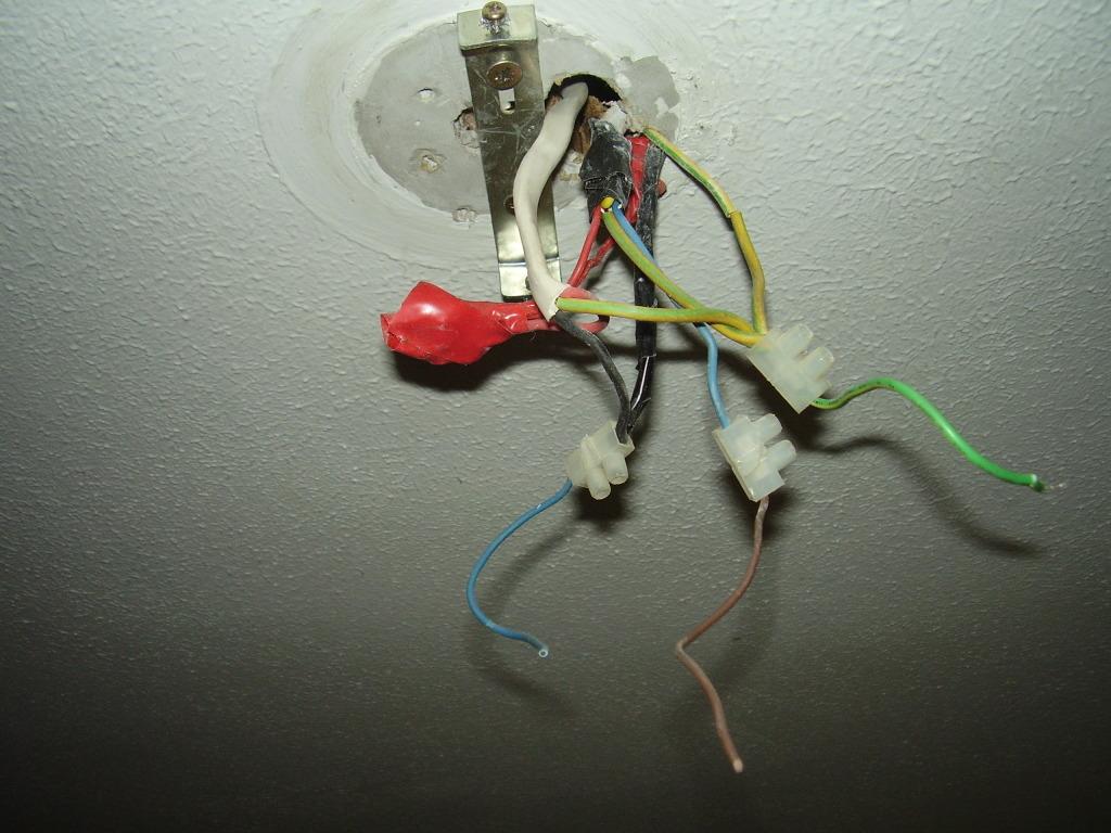

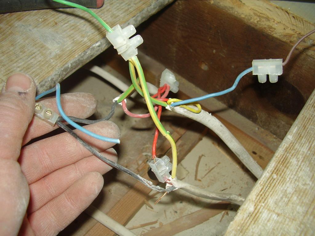

Onoff Posted August 14, 2018 Share Posted August 14, 2018 @Wes, any of these your handiwork? 1 Link to comment Share on other sites More sharing options...
