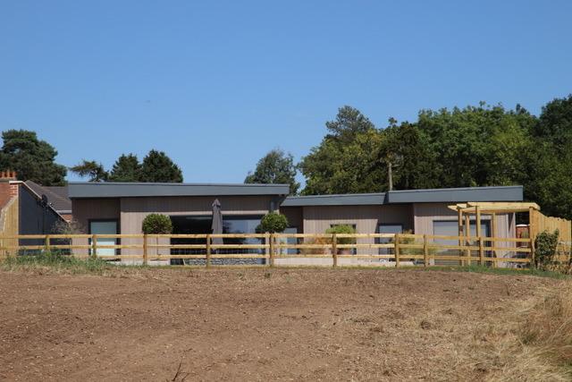

I was totally set on cedar, had samples from everyone, looked at untreated and the sioo from Russwood.
I did a last minute swerve into siberian larch after being sent a random sample.  It was sivalbp with the sacrificial coating so no uneven weathering.  I had larch with new age gris so already greyish and it will just weather evenly.  I swerved to the larch as the grain was so beautiful on the sample I got. Sivalbp only available from Vincent timberin Birmingham. My carpenter said it is some of the best cladding he has fitted no waste or rubbish pieces every length inspected for quality before they delivered it.  I am delighted, they do cedar too.

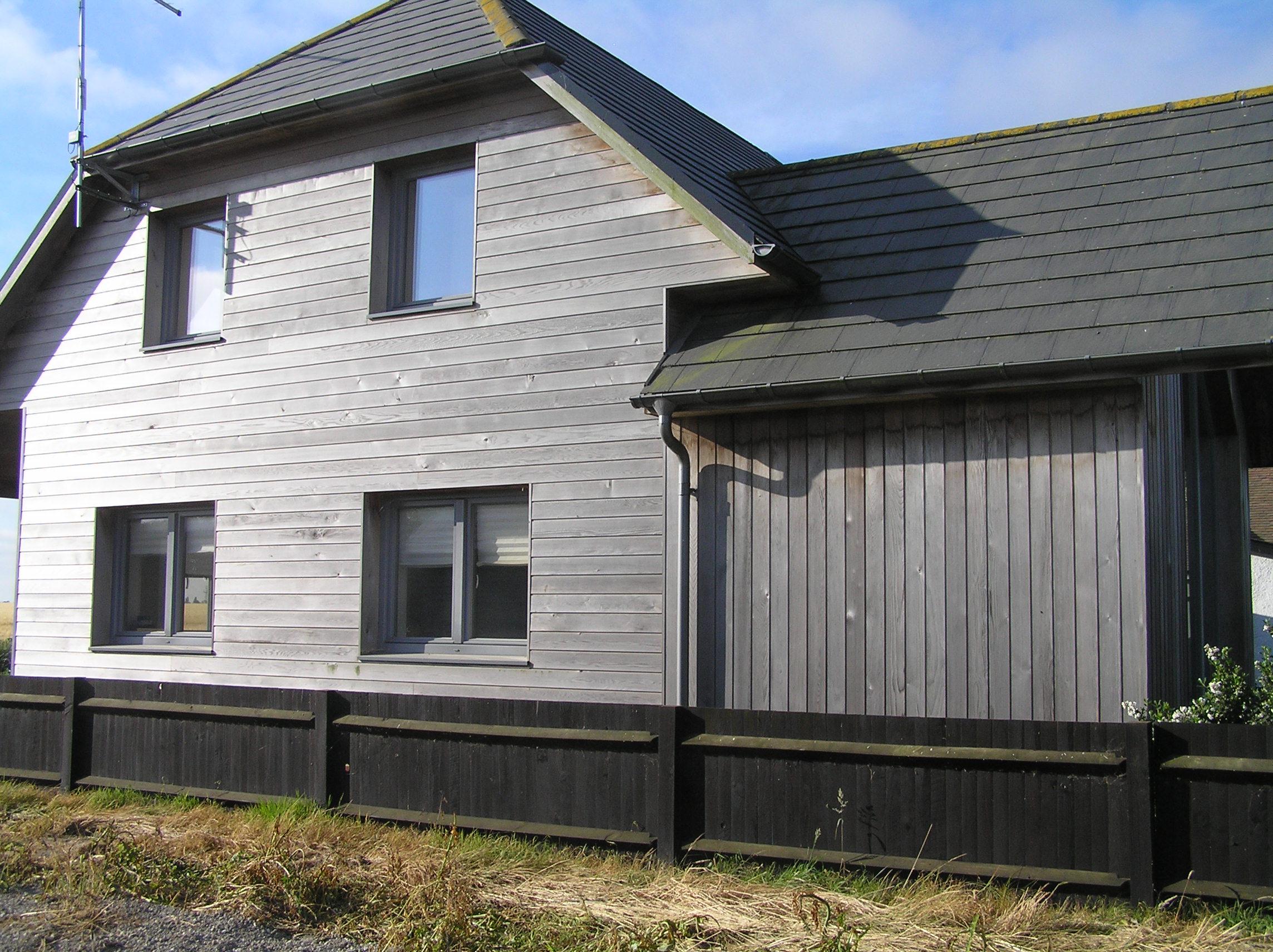

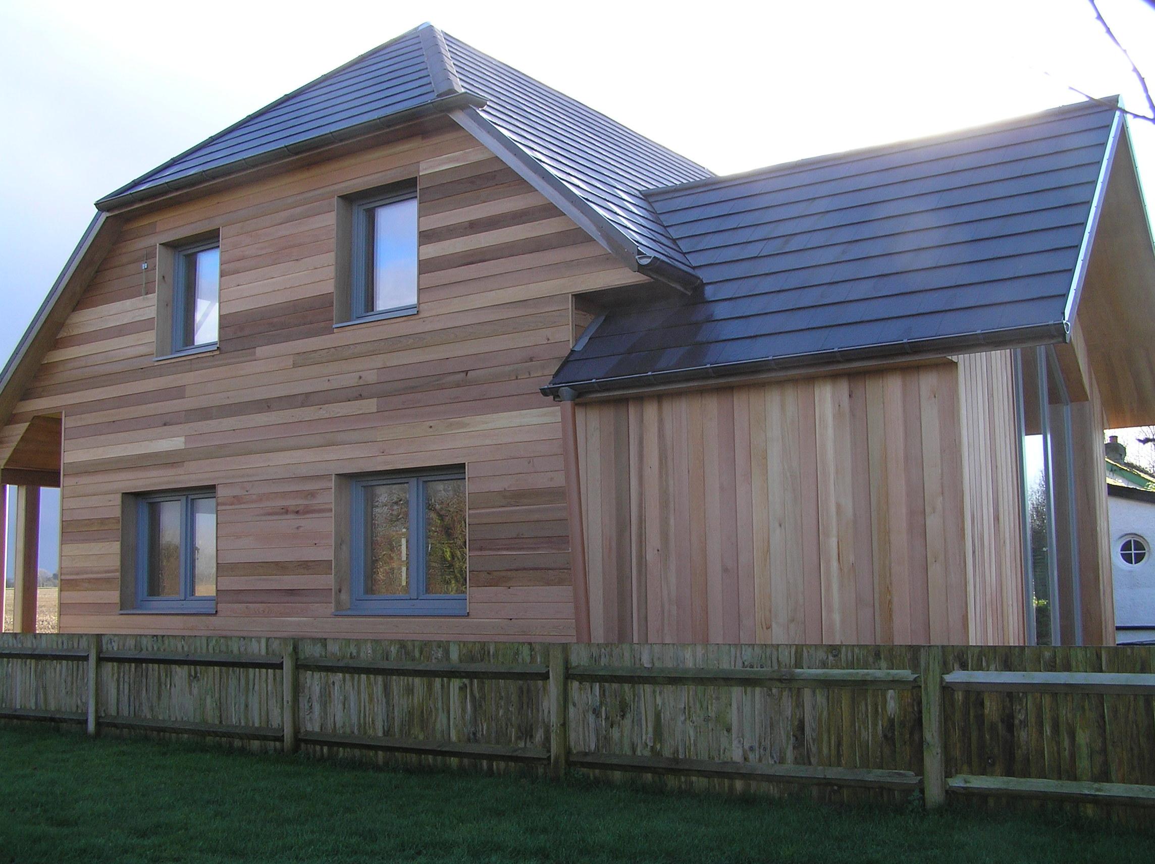

I clad my house with cedar. I used grade no. 2 clear and better which had no knots. These pictures are of the north side of the house with a gap of around five years between them. We bought the cladding from the local timber yard who machined it to my specifications.
