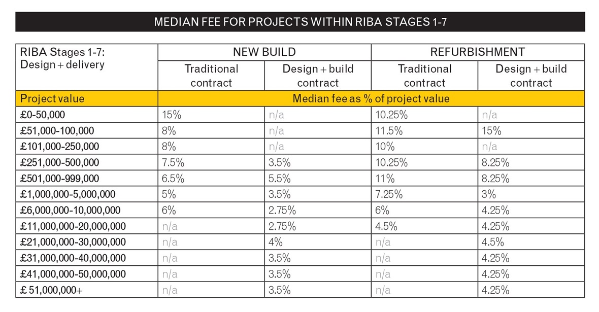

Median architects fees are shown here, from The Architects Journal.
Assuming that your 4-5 bedroom house is around 2500 square foot, that might have around a £400,000 build cost, so I would expect an architect to charge around £25,000 to take you right through to the end of the build. I think when I was pricing it up we saw fees ranged from 6-9% of the build cost.
There are well defined stages of the build that have expected percentages of the cost. You can stop earlier to save money,
