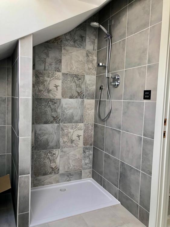

I need a custom sized shower screen for one of the bathrooms which is in a dormer room.
Can anyone recommend a supplier? Plenty of choice online but I’d rather go with a recommendation.
Also a few suplimentary questions:
Which thickness glass. It’s 1000mm wide so I was thinking 8mm?
How do the frameless designs seal to the wall? Is it just a clear mastic bead?
Picture below:

I started a thread on this and it petered out because I have not got round to it yet.
I identified some hinges you can buy on ebay, but there was a bit of doubt which one to buy as I want it to open both ways.
The glass will come from a local window company who will cut it to size, drill the holes to suit the hinges, and then toughen it. I had an initial price but never firmed up on the details. I was planning 8mm glass. 1800mm tall by 900mm wide and 3 hinges.
The glass won't "seal to the wall" in my case. The 3 hinges will fix to the wall and there will be a small gap between the glass and the wall as there will be between the glass and the floor, but mine is a wet room.
Posted
Local glass company should be your first port of call, with some online prices in the back of your mind for comparison, but the delivery cost shouldn't be so steep
