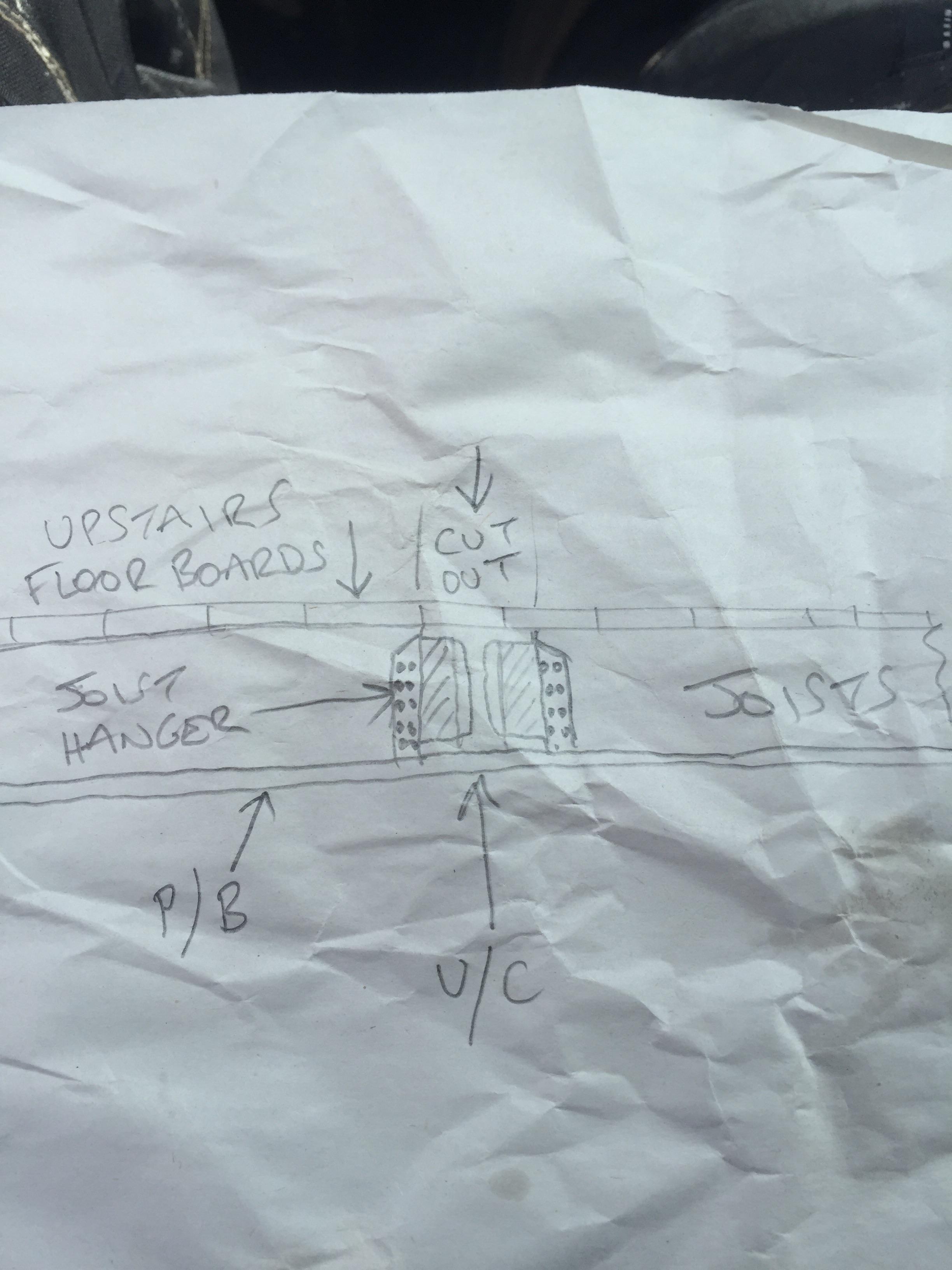

If no walls etc above then why not go for steel, load the webs with 6x2" joists planed to make them fit flush, cut the existing floor joists out to the width of the steel, and push the steel up into the 1st floor joist void? Flush ceiling down below, and then if you want you can make a false oak beam that's purely cosmetic.

Drawn on a chip wrapper.........that I borrowed off someone.
The joists need bolting into the webs. Then you retrospectively add the joist hangers to connect the existing joists to the joists in the web.
