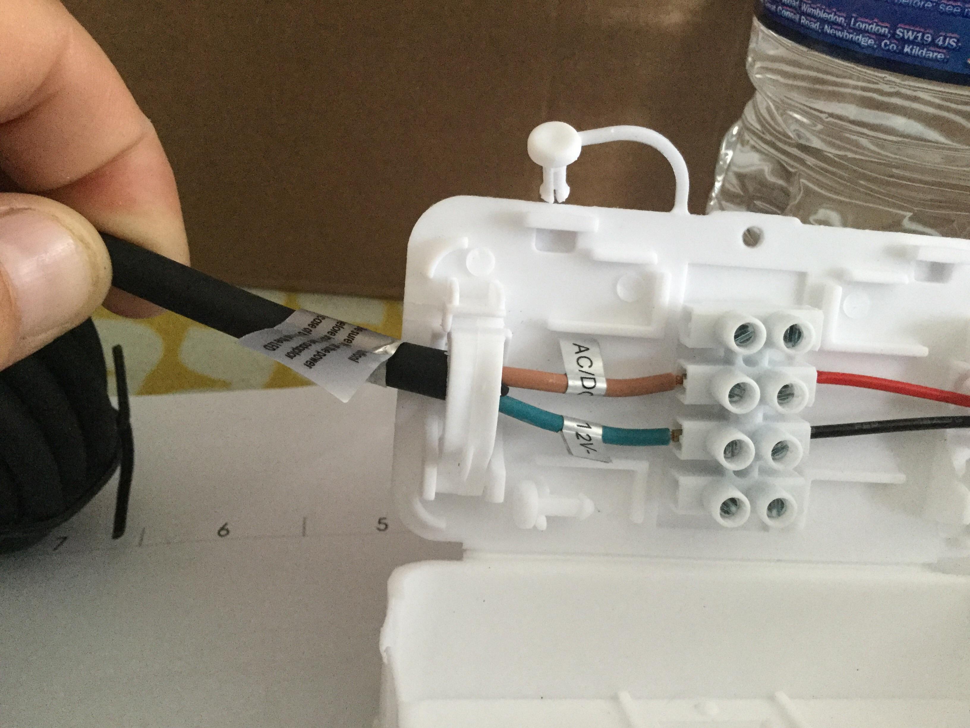

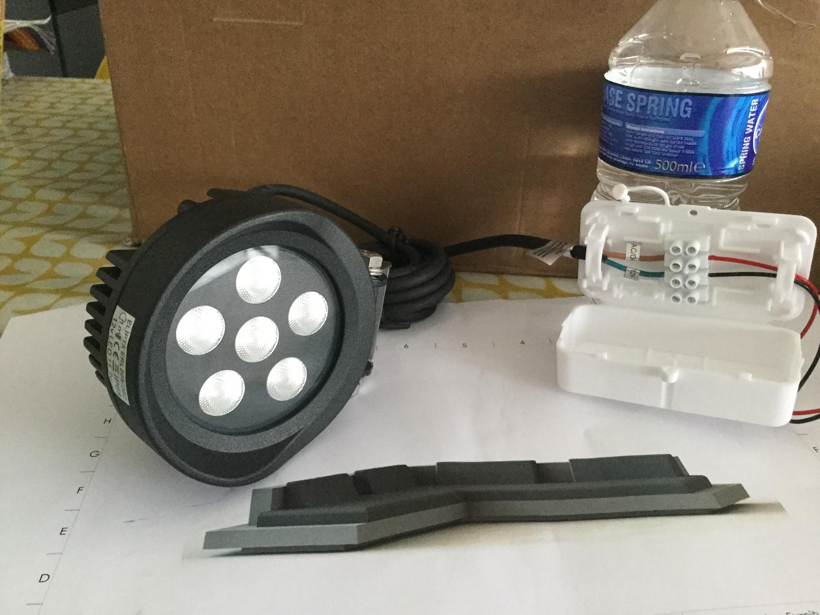

Trw144 Posted May 25, 2018 Author Share Posted May 25, 2018 (edited) So, some help needed from the sparkies out there. The techmar lighting uses a 12v ac transformer. There seems to be no issue on the polarity in these light fittings as you can fit them into the two pronged connector either way around, and they still work. However, I have a couple of non techmar lights which also need 12v ac, but they do have a marked positive and neutral wire, suggesting they can only be connected one way? If this is the case, how do I determine which is the 12v live and which is negative coming out of the transformer? Hopefully this makes sense, if not I ll add some pictures which may help. Edited May 25, 2018 by Trw144 Link to comment Share on other sites More sharing options...
Onoff Posted May 25, 2018 Share Posted May 25, 2018 If something's marked + and - then it's DC or cheap crap marked wrong! There is no positive and negative coming out of an AC transformer, it's alternating current. Pictures pls and close ups of anything written on the lights or connectors. Link to comment Share on other sites More sharing options...
Trw144 Posted May 25, 2018 Author Share Posted May 25, 2018 (edited) @Onoff Looking at the lights they are actually marked 12v ac/dc. Is this possibly why it is marked up and on an ac circuit just does nt matter? Pics following Edited May 25, 2018 by Trw144 Link to comment Share on other sites More sharing options...
