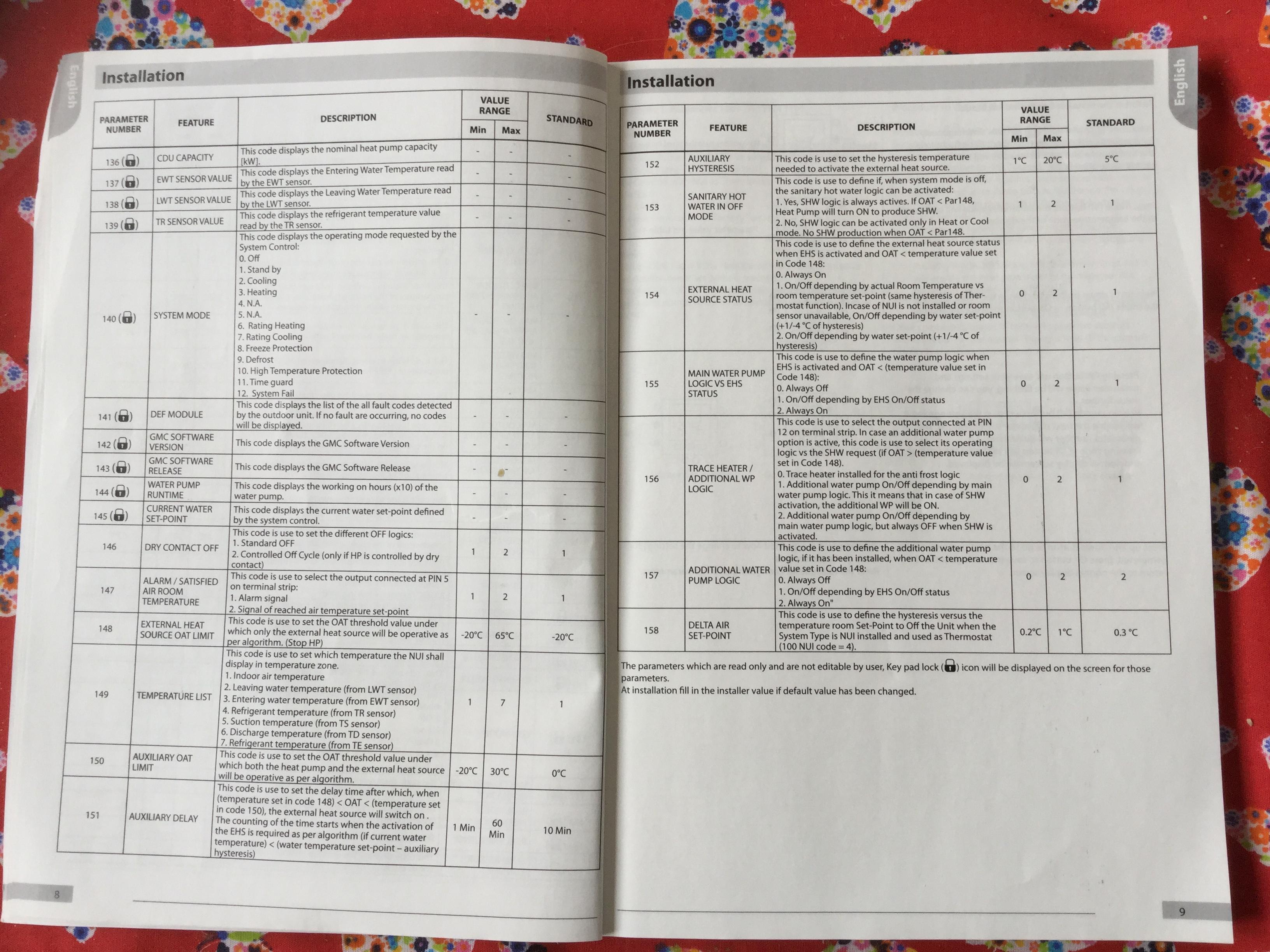

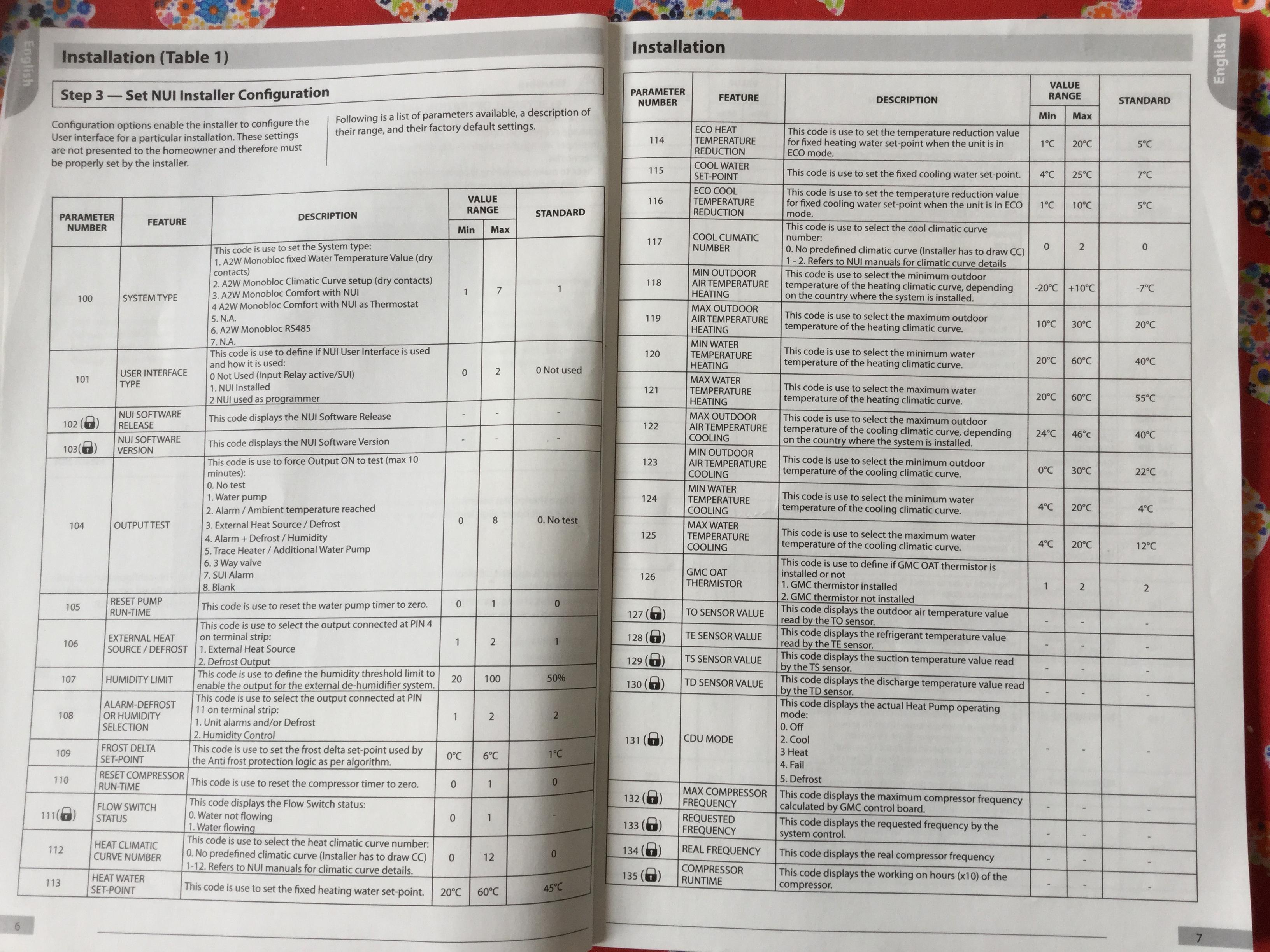

joe90 Posted September 4, 2018 Author Posted September 4, 2018 (edited) Right, after putting it off I finally got round to reading up and understanding what I need to do, but this has led to even more questions. The carrier user interface installation and user manual only talks about heating, cooling, sleeping or away modes (no DHW mode) but the front screen has a “sanitary hot water” symbol?. Also the user interface has timers and thermostats that are programmable so presumable I don’t need the single channel timer but I guess I still need the UFH room stat?. I was interested to see it dealt with cooling as others have said they needed to reverse engineer theirs to do this. Frankly I am right out of my depth with this so would appreciate some guidance. Here are the two installation pages ? Edited September 4, 2018 by joe90
Jeremy Harris Posted September 4, 2018 Posted September 4, 2018 If you install the control unit where it can work as a room stat, then you can also use it as the only heating programmer/stat, as it's got normally heating programming capabilities and a room temperature sensor. If you don't want to use the control unit as a programmable room stat, then you can ignore all the time/day programming stuff and just use another method to control the heating (which is what I've done). Sanitary hot water is DHW as far as we are concerned, and the ASHP has relay outputs to drive motorised valves to switch from heating to hot water mode and the heat pump can control the hot water temperature without a tank thermostat because it just limits the flow temperature to either 50 or 55 deg C in sanitary hot water mode, and has enough hysteresis to not need anything else to maintain hot water at that temperature without anything else. It's a bit either/or, in that if you opt to position the control unit as the main programmable thermostat, then you can set everything from there and only need to add a motorised valve to switch the flow from the UFH to the hot water system (if you're using it for hot water). If you're only using the heat pump for the UFH, then you don't need the motorised valve and you can ignore the sanitary hot water bit. Setting the temperature curves for the flow temperature is a bit of a pain, but worth doing if you want best efficiency from the thing. Depending on what you want to do I can give you settings for doing that, using the custom curve option. You can leave most of the installer settings at their default values, as there are only a handful that may need changing.
joe90 Posted September 4, 2018 Author Posted September 4, 2018 Thanks JH, I think I need to get it fired up using factory settings (as SWMBO keeps telling me it’s Septemberish, I.e. chilly) and see how it goes, I may pick your brains regarding curves once we settle down to using it. I will also consider using E7 or E10 once we know how the house performs.
Jeremy Harris Posted September 4, 2018 Posted September 4, 2018 Happy to talk you through changing the settings as needed. The manual isn't as clear as it could be, IMHO. There may be a slight delay whilst I get back up to speed on the settings, as it's a while since I've played with ours - I got the settings right and have just left it alone since! 1
