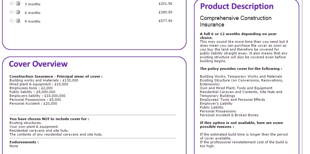

anna Posted July 13, 2016 Share Posted July 13, 2016 (edited) Got a price from Buildstore £430.61 for a year or £775.52 for 2 houses I Edited July 13, 2016 by anna Link to comment Share on other sites More sharing options...

PeterW Posted July 14, 2016 Share Posted July 14, 2016 Wait til you try and claim.... I've noticed some of them are vague - I am trying to get the definition of "site hut" confirmed, and what they will and won't pay out for if I use a secure container for storage. Its taken 2 weeks, and I'm still no closer !! 1 Link to comment Share on other sites More sharing options...
ToughButterCup Posted July 14, 2016 Share Posted July 14, 2016 Here's just one: (PM me for the company name if you like) Tucked away in a corner words to the effect; If we choose to use piles as a foundation, then the policy will be cancelled or otherwise varied ( = price increase). And I had to decide whether I would to use piles before the SE had decided. I pointed that out. Oh, that's OK.... just give us £600 for the year and we'll look at the contract again later if you use piles. I read and re-read five quotes, and highlighted sections I felt were dubious. I was and still am unhappy with the quote I accepted; but it was the least bad option. I don't mind companies making money. But I do mind what appears on the face of it to be border-line sharp practice. As standard. 1 Link to comment Share on other sites More sharing options...
