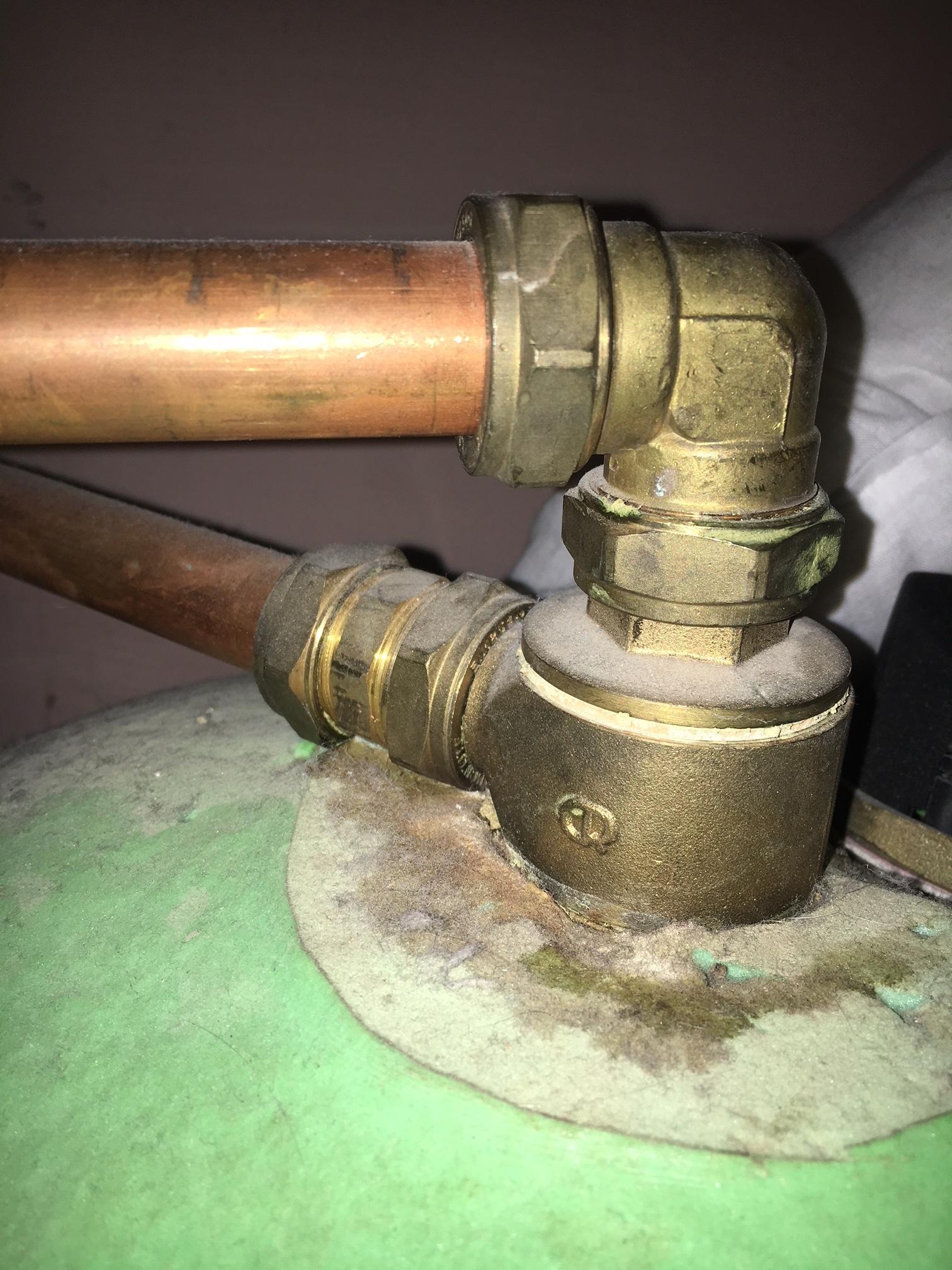

bissoejosh Posted May 4, 2018 Share Posted May 4, 2018 My parents house has a pumped shower setup (Salamander ESP50CPV) running an ensuite and the main bathroom. Header tank up in the loft and hot water cylinder next to the pump in an airing cupboard. For some reason the pump occasionally primes during the day but I thought this was due to the mixer being incorrectly calibrated. Yesterday the showers in both rooms stopped working other than when set on cold and the pump makes a noise very similar to cavitation - airlock? Youtube suggests a number of tricks to clear the block but I'm not having much luck and can get a trickle of hot water at either shower at best. Any advice greatly welcome! Link to comment Share on other sites More sharing options...

PeterW Posted May 4, 2018 Share Posted May 4, 2018 Is it an Essex flange on the tank for the shower..? Link to comment Share on other sites More sharing options...
Nickfromwales Posted May 4, 2018 Share Posted May 4, 2018 Have the filters been cleaned ( ever ) ? Has the pump ever been run until the water in the header tank ran out ? That lifts up some real grot and it stays in the filter/s. Link to comment Share on other sites More sharing options...
bissoejosh Posted May 6, 2018 Author Share Posted May 6, 2018 On 04/05/2018 at 22:17, PeterW said: Is it an Essex flange on the tank for the shower..? Not sure? The fitting in photo below is directly on the top of the tank. The upper pipe goes off to the shower pump which is at floor level in the same space, the other pipe goes to the bath taps and wash basins (no issues with either). On 04/05/2018 at 22:18, Nickfromwales said: Have the filters been cleaned ( ever ) ? Has the pump ever been run until the water in the header tank ran out ? That lifts up some real grot and it stays in the filter/s. Don't believe the filters have been cleaned but also don't think the header has ever been run dry. The hot feed from the pump is getting lukewarm at best but the hot feed to the pump is piping. Is it worth taking the hot side of the pump off and seeing if their are filters etc to clean? Would adding an inline air valve at the highest point after the pump be useful? Link to comment Share on other sites More sharing options...
Onoff Posted May 6, 2018 Share Posted May 6, 2018 (edited) That's a Surrey flange imo. The lower pipe will be the hot feed to to shower pump. I think. There's little mesh filters on my shower pump. Also in the bar mixer valve. Edited May 6, 2018 by Onoff Link to comment Share on other sites More sharing options...
PeterW Posted May 6, 2018 Share Posted May 6, 2018 Sounds like the pump is either blocked or jammed. Is it a single or dual impeller..? Link to comment Share on other sites More sharing options...
Nickfromwales Posted May 6, 2018 Share Posted May 6, 2018 Could be a knackered / failed impeller or just a blocked filter. Strip, check, report. If its worked before reliably then a vent shouldn't be necessary. Link to comment Share on other sites More sharing options...
