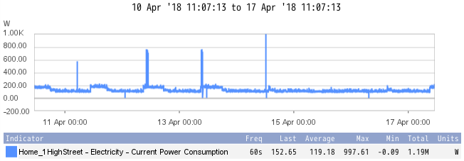

I recently ordered a 3 channel board from this place - http://lechacal.com/wiki/index.php/Main_Page - works really well. You still need to write your own code to 'do something' with the data that comes out of the sensor board but theres some examples on their wiki on how to do basic integrations. They do a 7 channel version for £35 (ex clamps).
Still uses the same CT clamps from the beginning of this thread so not ideal for stuffing inside a consumer unit.
This one is monitoring my garden office/shed at the moment -

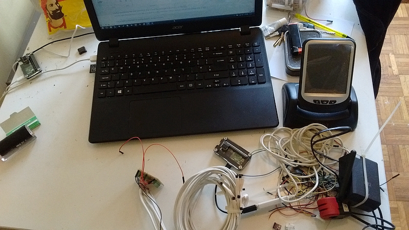

Just cobbling together an energy monitor at the moment.
These are some of the bits.

@MrMagicThat's very close to what I'm looking for - what's the lowest power you can realistically measure with this ?
@Alphonsox Good question - Just been trying to think of anything low power with a live wire that I can clamp... not sure I've got anything readily available at the moment, sorry.
Perhaps try contacting the vendor? I'll have a dig around and see if I can find something that I can modify to test with...
EDIT: The folks over at OpenEnergyMonitor look to have done some low current testing using similar hardware - general consensus seems to be that anything <50w may be incorrectly reported.
https://github.com/openenergymonitor/emontx2/blob/master/accuracy.md
https://learn.openenergymonitor.org/electricity-monitoring/ct-sensors/measurement-implications-of-adc-resolution-at-low-current-values
That is my experience when using CTs.  Though I found, on average over the whole range things tend to sort themselves out.
The only large inductive loads I have are the washing machine, vacuum cleaner and the bathroom fan.  They are no used that much in the scheme of things.
