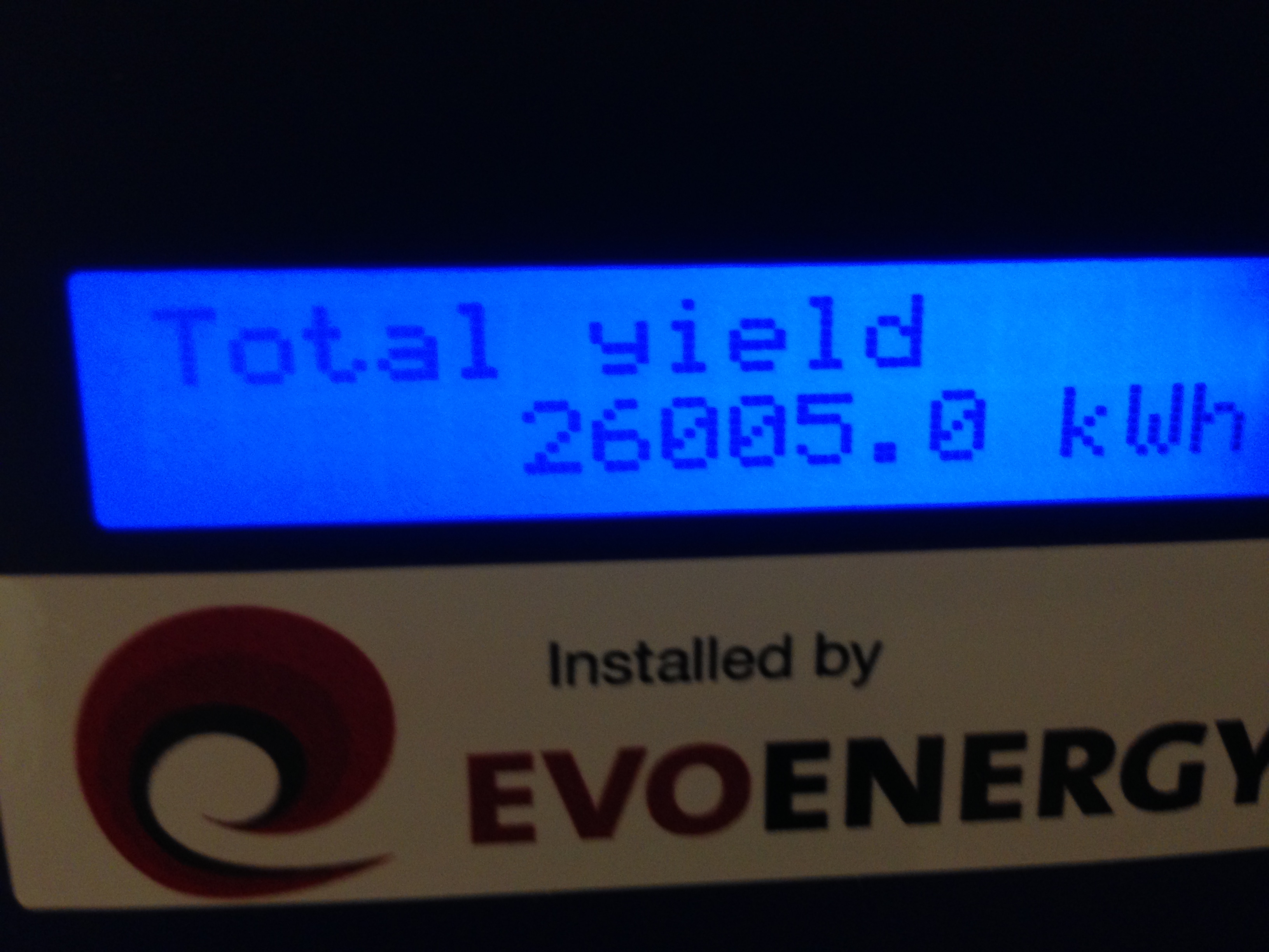

April 1, 20188 yr Hi Just took a reading from my solar PV for the start of the month. Just gone through 26,000kWh of generation since 21st November 2011 - thats 2,323 days or average of 11.19kW per day.
April 1, 20188 yr So about 1170 kWh/(kWp.Year) That is quite high, but then you are only 1.5° North of me. Having 20, 175W modules seems odd now as 250W is about the minimum fitted. We got offered a container worth of them a few years back from a company that had miss ordered. They were a good price back in 2011 I seem to remember.
