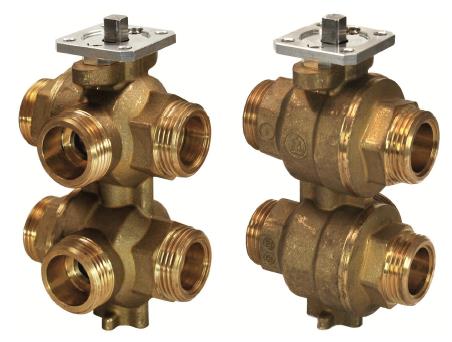

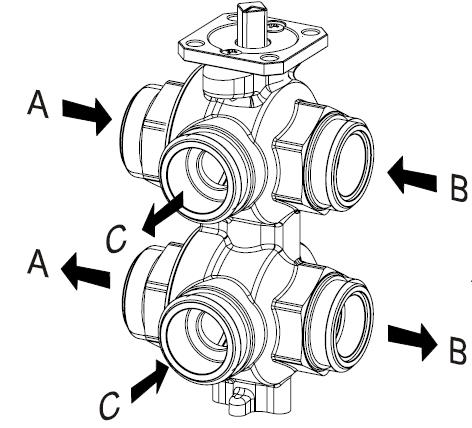

A follow on from my previous question:
Has anybody had experience of these 6-port Ball valves?
It is designed to switch a radiant panel between a heating source to a cooling source and I was considering using it in reverse to switch the ASHP between the 2 destinations in my design.  I am considering it because it is a ball valve which completely isolates and can have equal flow between outputs:
I would have to put in a bypass into the ASHP supply as it takes 80-90 seconds to change and has a dead (no flow point).
This one is the Siemens VWG41.20-4.25-4.25 (20mm connection 4.25m3/h through each way)

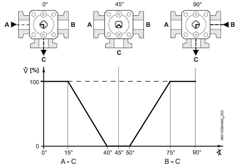

Most Siemens Building Systems stuff has very good interface control - I expect the motor head has control switches that indicate its position so a bypass wouldn't be needed as you could shut off any pumps if the switches weren't open.
I'd expect no change from £2-300 ...

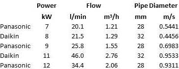

Jeremy,
The 28 and 32mm was from the water out from the ASHP’s.  The 2 manufacturers I am currently looking at have a 28mm (1-3/32”) or 32mm (1-1/4”) connection for water supply and return so I just went with that.  That was agnostic of power or flow rate, 7-12 kW and 21.1 – 46.0 l/min max flow rate (interestingly the highest is for an 11kW version that also supports a 16kW unit).  This gives me a flow rate (basic no account of pressure loses) of 0.44-0.95 m/s. (Calculations below)

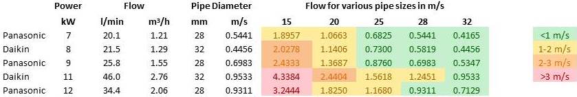

If I extend this to work out flows in various pipes I get:
So it depends on the ASHP I use.
My house need 4kW of heat (worst case) add in DHW pre-heat and a spare so it doesn’t run at full power (defrost issues) 8-9kW is probably more than enough so 25mm keeps me below 1 m/s and 20mm in the 1-2 m/s range, that reduces the price of my original Class VI valves to £108 and £83 but still expensive.

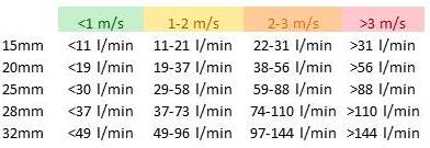

I also did some generic flow calculations to show volume range through various pipes at various velocities, may be useful to some people:

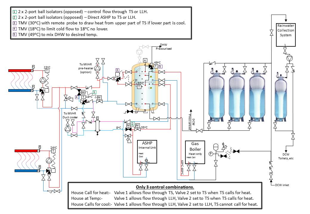

So here is my latest update of the system:
A higher quality .pdf version: Heating-DHW-Design(2-port).pdf
There is a lot but you can break it down into constituent parts by:
1. ignore the UFH manifolds and see the supply-flow to them.
2. Ignore the Cold water side.
3. MVHR pre-heater is just thinking aloud (probably won't happen).
Some explanations:
TMV 3 prevents the UFH drawing heat from the top of the TS unless the bottom is cool (ASHP failure....)
TMV 4 allows the ASHP to provide the duct-cooler with 8C water but limits the UFH to about 18C.  When warm (20C) water is circulating it will try and draw through the cold side (LLH), the alternative is all the way through the LLH, ASHP and TS (highly unlikely)
I think it all makes sense and I am using just 4 motorized valves, the remainder and mechanical (on way) or thermo-mechanical (hopefully).

That's similar to the logic I have, except that I allow the hot water pre-heat to have priority over cooling.  Our buffer tank is only used to store warm (35 to 40 deg C) water, and I allow the thermostat on that to over-ride the house call for cooling, so if that thermostat calls it turns the ASHP off, switches the ASHP to heating mode, closes the UFH valve, opens the buffer tank valve and then turns the ASHP on again, to bring the buffer tank back up to temperature.
My thinking was that hot water was more important than house cooling and was likely to only be for a relatively short duration, so the effect on the house temperature would be small (it takes a while for the UFH to warm up and it will carry on recirculating cool water for some time).
Link to comment
Share on other sites
My thoughts for hot water were that the boiler could cope if there is DHW whilst there is a cooling call as during the cooling season the DHW demand is lower (incoming cold is warmer) but nothing is set in stone so I could easily change the control strategy to prioritise hot water.

I arrived here looking for information on the same application that OP was interest in.
I came across a new Johnson Controls six-port valve that would appear suitable. I know the OP will have solved their problem by  now, but wanted to leave some details here in case others found it useful.
The valves are VG1611BL (3/4")  and VG1611AF (1/2"), and the actuator is VA9905-KGA-1. www.hvac-sanitary.co.uk have them in stock, and the price for the 3/4" valve and actuator is about £450 (inc VAT).
This valve is somewhat novel in that it rotates 270 degrees to switch between the sources/destinations. Johnson Control have a video on YouTube that explains how this allows them to get more flow through the valve than competitor products. Not cheap, but a good solution if you need to switch both the flow and return lines of your heat pump between two destinations.
  • Like 1
Link to comment
Further to my post, anyone seeking to use a six port valve to switch a heat pump between differnent destinations also needs to consider the pressure in the pipework as the valve effectively creates two seperate systems (with some common pipework that includes the heat pump). Normally a single expansion vessel would be used to accomodate the expansion and contraction of the circuit operating through the heat pump. While there is a single circuit, a single expansion vessel (if appropriately sized) will be fine, but using a six port valve would seem to need at least one appropriately-sized expansion vessel per seperate system.
The Johnson Controls valve lacks a seal at the OFF position that can be used for isolation, and this provides a degree of protection against over-pressure. In theory, this would allow any overpressure at the heat pump to be disippated to a expansion vessel in either of the two systems, but this only works when the valve is used to isolate the heat pump from both systems. For safety, I am inclined to add a third expansion vessel on the common piping to the heat pump.
