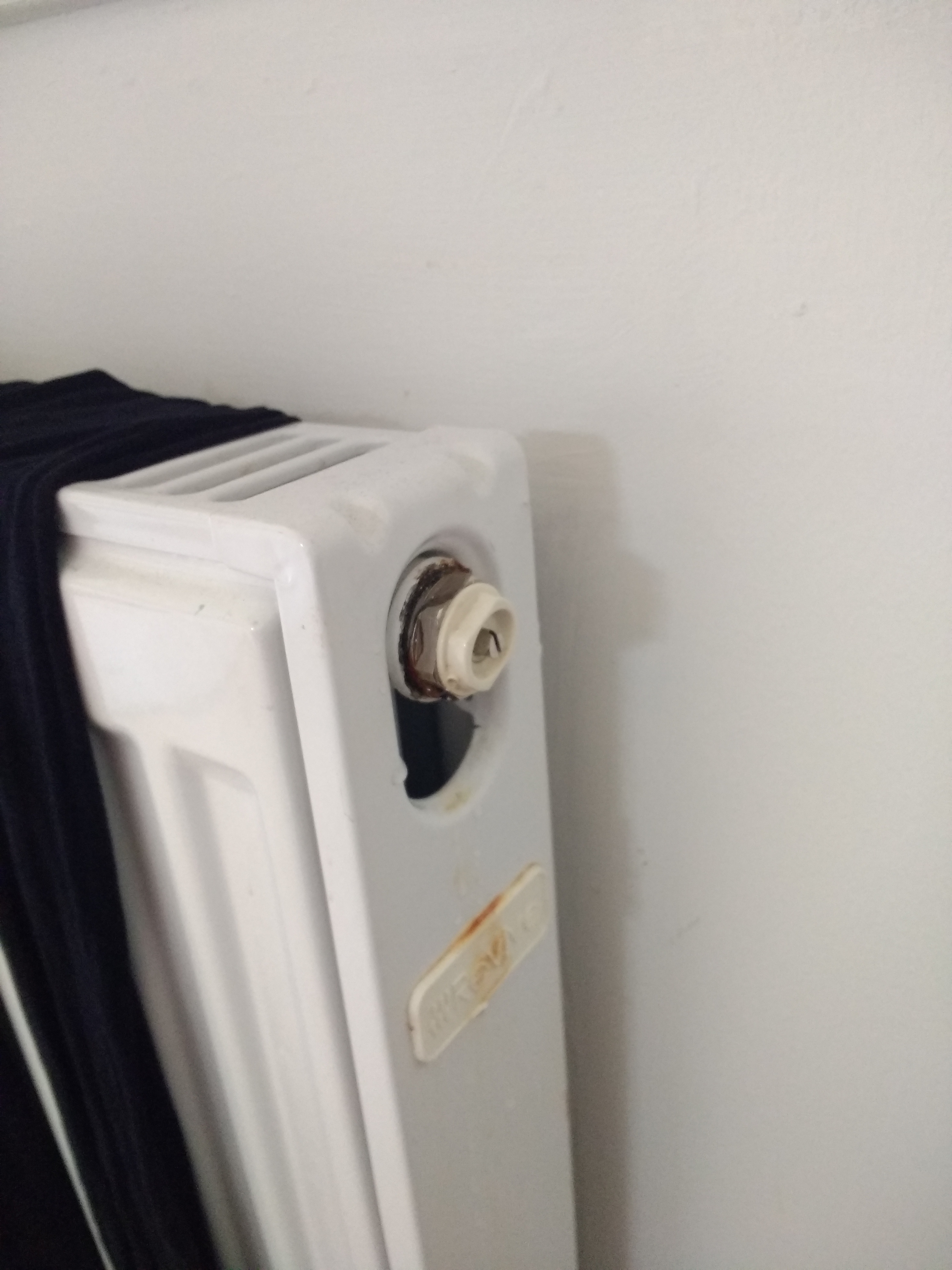

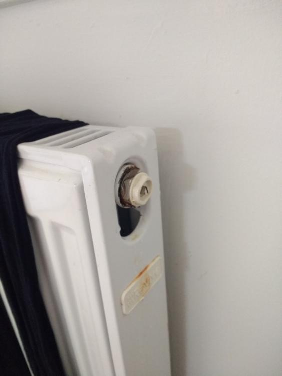

Tennentslager Posted March 11, 2018 Share Posted March 11, 2018 Tighten it up first then if that doesn't work drain and try again with a few turns of tape on it? It's a little rusty... Link to comment Share on other sites More sharing options...
Onoff Posted March 11, 2018 Share Posted March 11, 2018 Tape I think would be my first choice. Link to comment Share on other sites More sharing options...
dpmiller Posted March 11, 2018 Share Posted March 11, 2018 those vents have an O-ring IIRC. Link to comment Share on other sites More sharing options...
Onoff Posted March 11, 2018 Share Posted March 11, 2018 Lidl were doing some cheap as chips O ring kits the other day. Link to comment Share on other sites More sharing options...
Pete Posted March 11, 2018 Share Posted March 11, 2018 5 minutes ago, dpmiller said: those vents have an O-ring IIRC. +1 Link to comment Share on other sites More sharing options...
