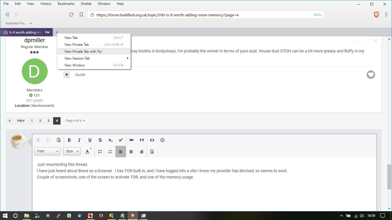

SteamyTea Posted July 1, 2018 Share Posted July 1, 2018 (edited) Just resurrecting this thread. I have just heard about Brave as a browser. It has TOR built in, and I have logged into a site I know my provider has blocked, so seems to work. Couple of screenshots, one of the screen to activate TOR, and one of the memory usage. Bit slow to upload stuff, but that is not unusual when using TOR. Edited July 1, 2018 by SteamyTea Link to comment Share on other sites More sharing options...
