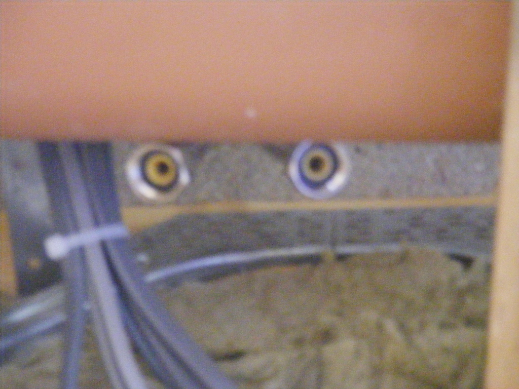

what fittings for flexi tap tails?
Floor mounted bath tap. Terminates in the ends of two flexi tails emerging through the floor.
What fitting to join these to copper pipe.
They are a perfect fit onto a straight or elbow 15mm compression fitting but I am sure I have read that is wrong as it would only present a narrow edge to the rubber washer in the flexi fittings.
Preferably a right angle fitting, flexi in, an copper out at right angles.
Sorry about lousy photograph.
Thanks.
But on the basis what I have seem to fit a 15mm compression fitting are they not 1/2" rather than 3/4?
