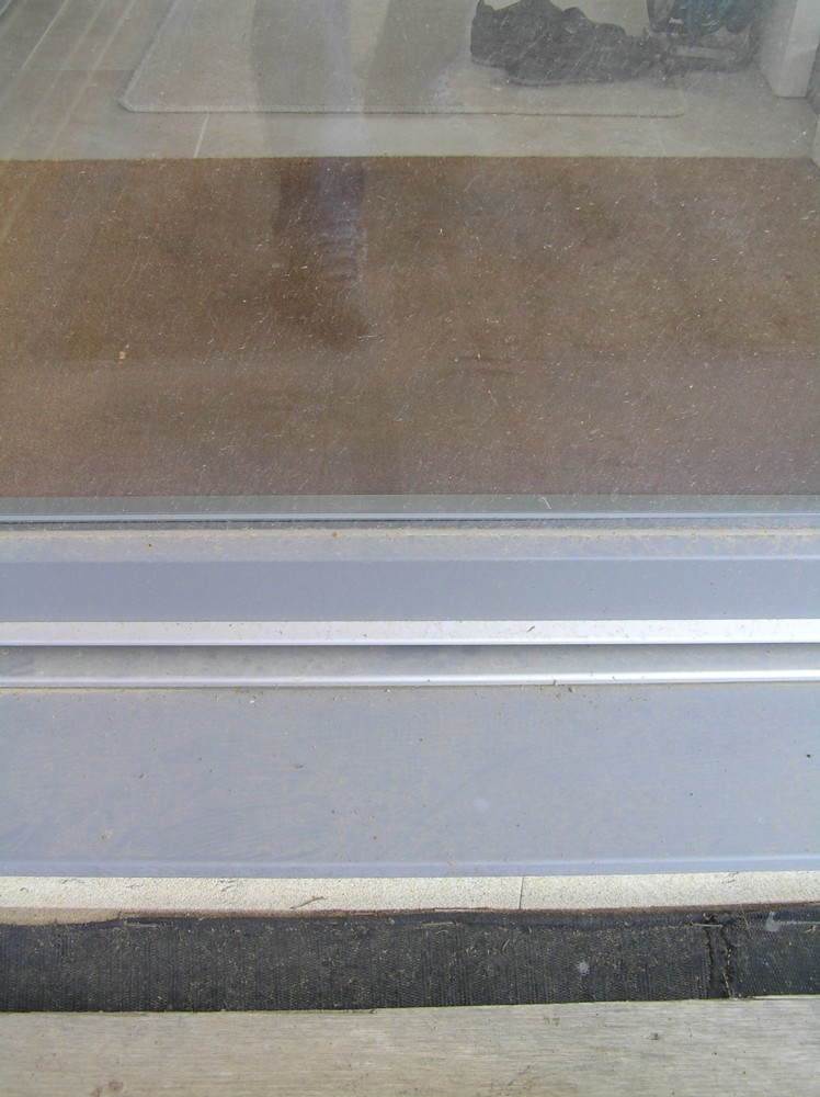

Stones Posted June 26, 2016 Author Share Posted June 26, 2016 Thanks, very similar to what I need. I note from your blog that you used cills on the patio doors / full length windows. What did you do at your main entrance door threshold? Link to comment Share on other sites More sharing options...
Gone West Posted June 26, 2016 Share Posted June 26, 2016 26 minutes ago, Stones said: Thanks, very similar to what I need. I note from your blog that you used cills on the patio doors / full length windows. What did you do at your main entrance door threshold? On the outer porch door I made an oak sill which the low threshold door sill sits on. The inner door into the hall is an Internorm low threshold sill. It's the door etc that's dusty not the camera lens! Link to comment Share on other sites More sharing options...
