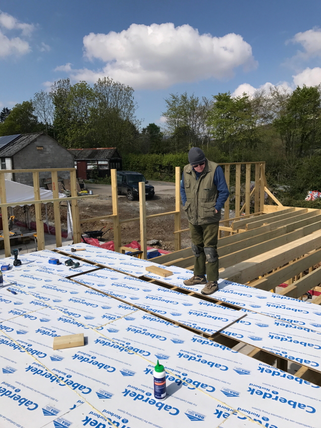

jpinthehouse Posted February 19, 2018 Posted February 19, 2018 1st floor Timber frame will be sitting on flooring what have others used, was looking at osb flooring or the chipboard with plastic wrap John
Nestor Posted February 19, 2018 Posted February 19, 2018 (edited) I used this. Caberdek Film coated P5 T&G 22mm + D4 glue. Screwed down as well. 2400x 600. Paid £9.75 sheet +vat. Excellent product. Edited February 20, 2018 by JamesP More info.
PeterW Posted February 19, 2018 Posted February 19, 2018 Used Egger Protect P5 bonded to the posijoists and it was out in the elements for a fair while with no real issues. It was specified as part of the posijoist system as that is how they get the strength.
Gone West Posted February 20, 2018 Posted February 20, 2018 We used 22mm Caberdek as well, glued and nailed. The plastic coating is tough and being out in the rain didn't affect it.
