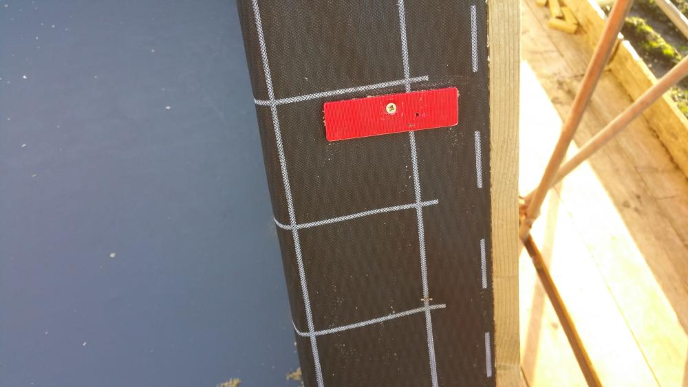

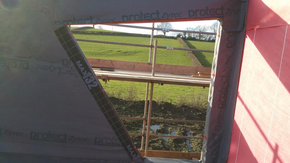

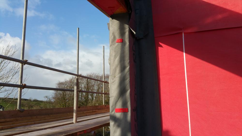

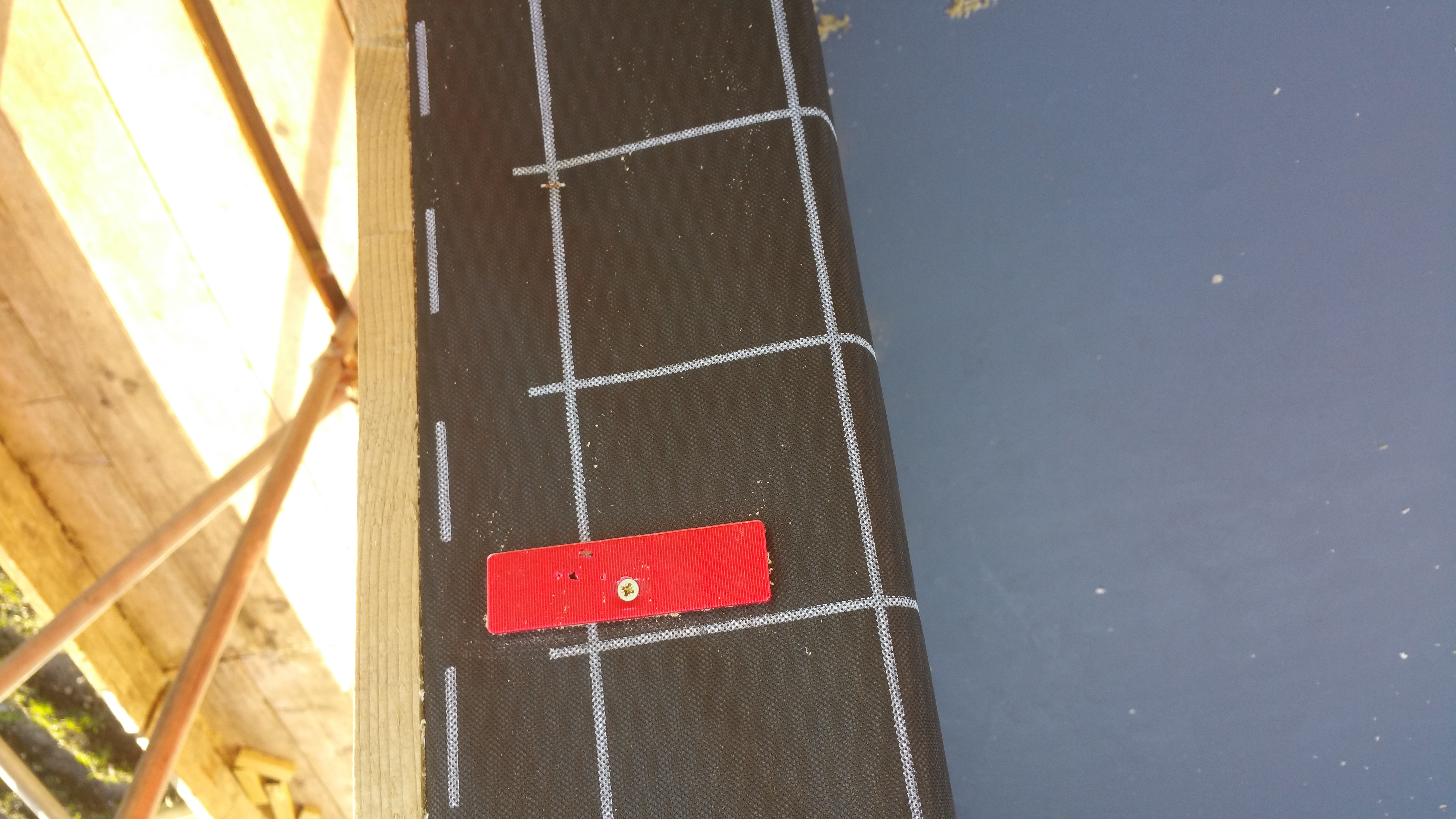

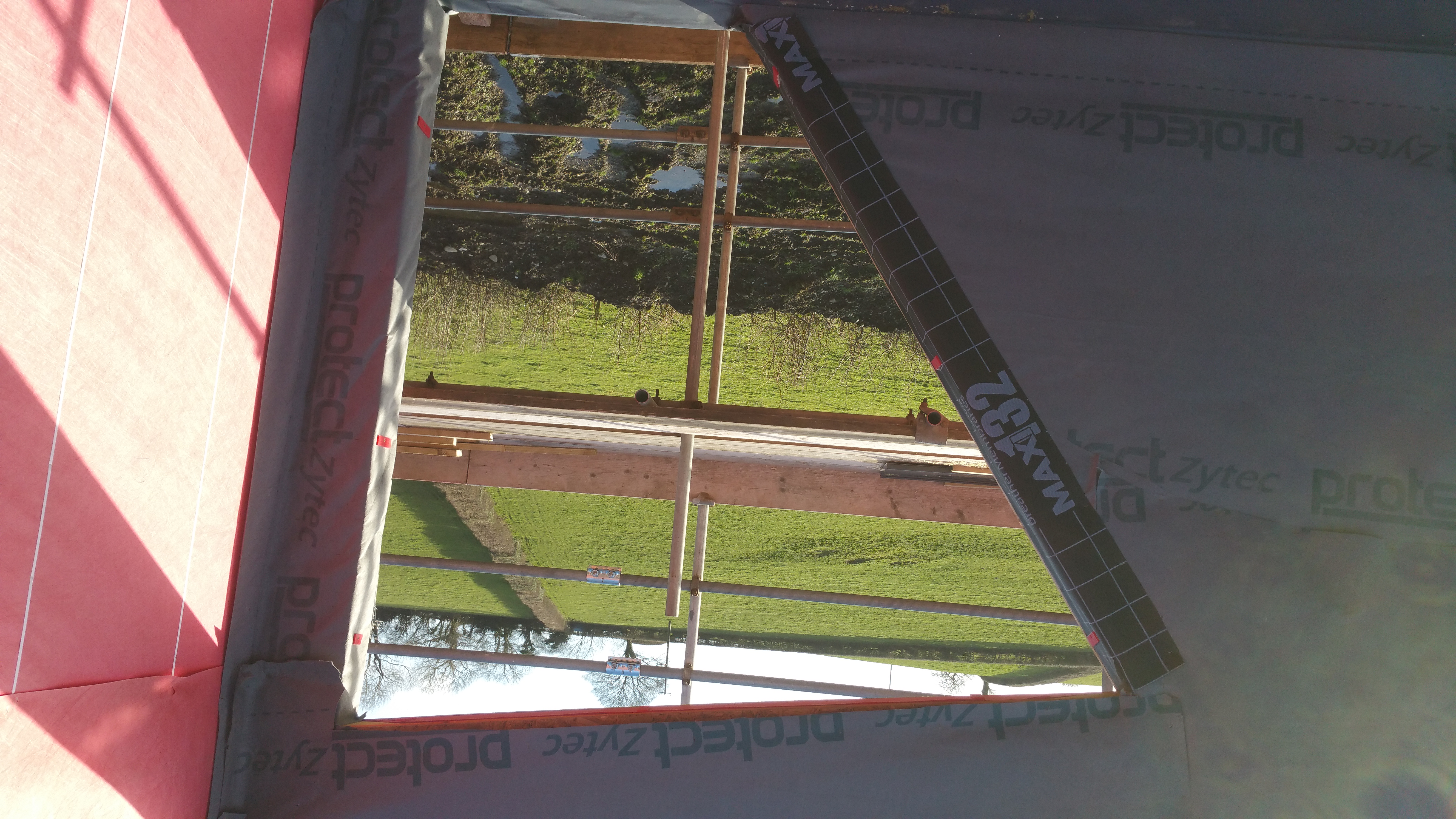

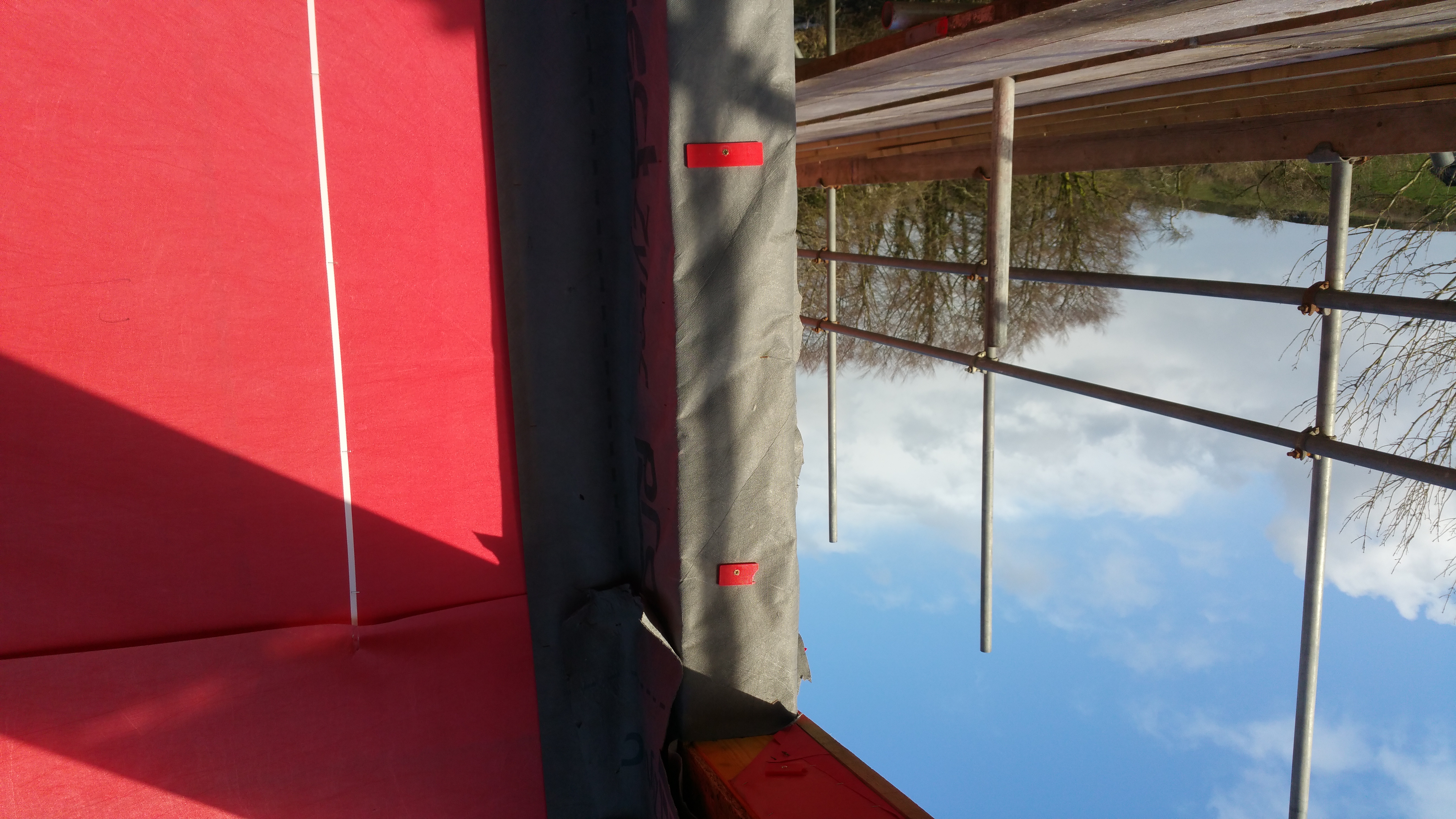

Pete Posted February 15, 2018 Share Posted February 15, 2018 Has anyone any advice on fitting structural glazing? This a single piece of toughened glass that will be fitted to an external wall on our roof terrace. At the moment my idea is to leave a 5mm gap to aid fitting which will be filled with glazing silicone afterwards. Once the glass is in place there will be a 25 x 100mm batten either side to hold it in place with window tape between the glass and the wood. Then there will be render board on top of that and then rendered. Underneath the render board will be a dpc and the Sika roof deck was fitted so it passed right under the glazing just in case of water penetration. Hope the pictures help. TIA Link to comment Share on other sites More sharing options...

Yzzy Posted February 15, 2018 Share Posted February 15, 2018 That's awesome.... So you are sliding an oblong in to an romboid frame? Or is your glass cut to shape too? Link to comment Share on other sites More sharing options...
Pete Posted February 15, 2018 Author Share Posted February 15, 2018 Glass will be cut to size 1 Link to comment Share on other sites More sharing options...
craig Posted February 15, 2018 Share Posted February 15, 2018 (edited) 5mm glazing packers, silicone, battens either side, will do the job well. Done similar on a few projects in the past. Just make sure the fixings for the beadings are strong and long enough. It might also be worthwhile to run some compriband between the bead and glass for protection or silicone. Edited February 15, 2018 by craig Link to comment Share on other sites More sharing options...
Pete Posted February 15, 2018 Author Share Posted February 15, 2018 40 minutes ago, craig said: 5mm glazing packers, silicone, battens either side, will do the job well. Done similar on a few projects in the past. Just make sure the fixings for the beadings are strong and long enough. It might also be worthwhile to run some compriband between the bead and glass for protection or silicone. Thanks for the vote of confidence Craig 1 Link to comment Share on other sites More sharing options...
