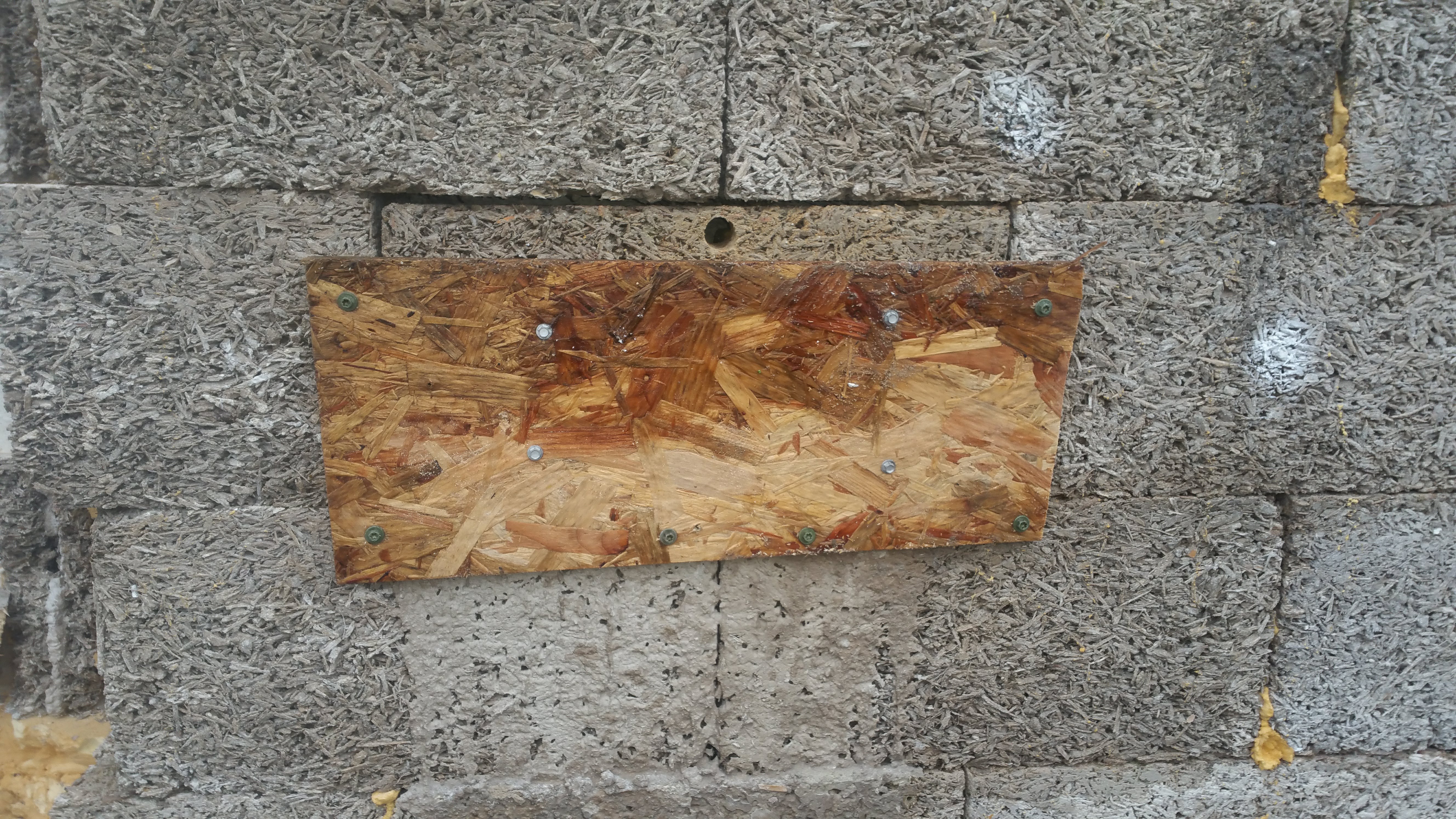

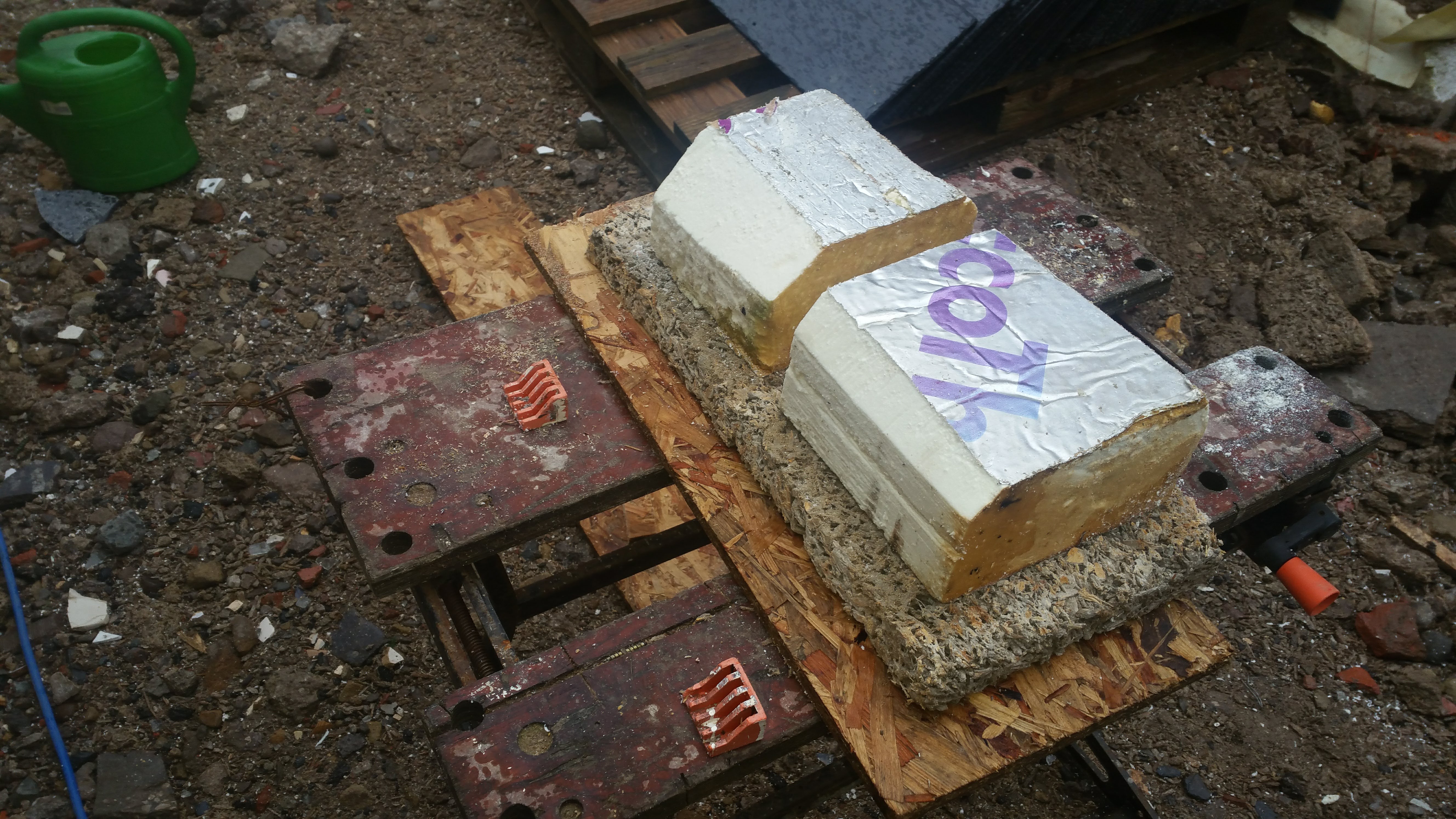

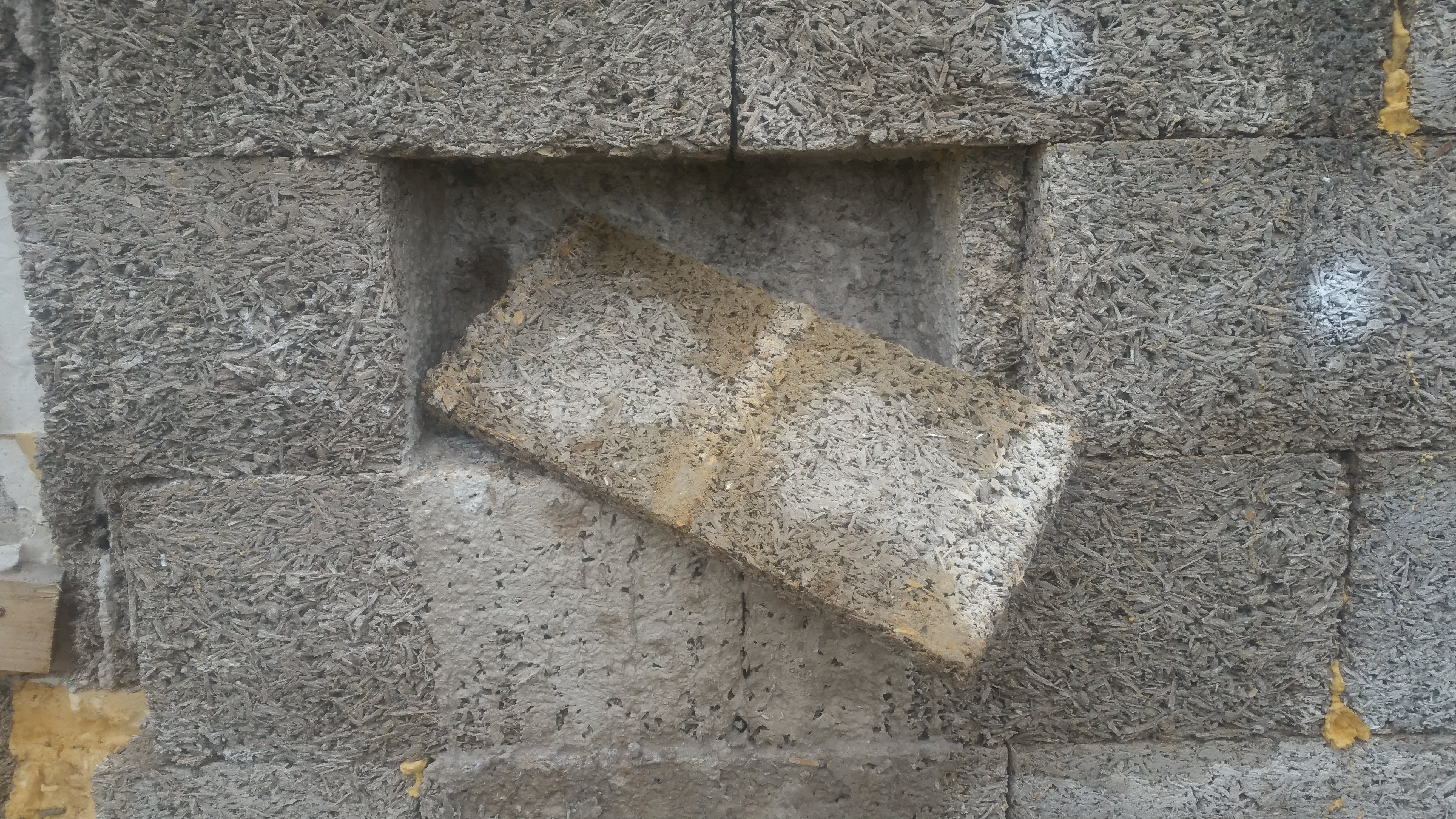

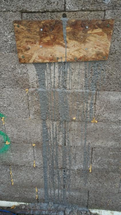

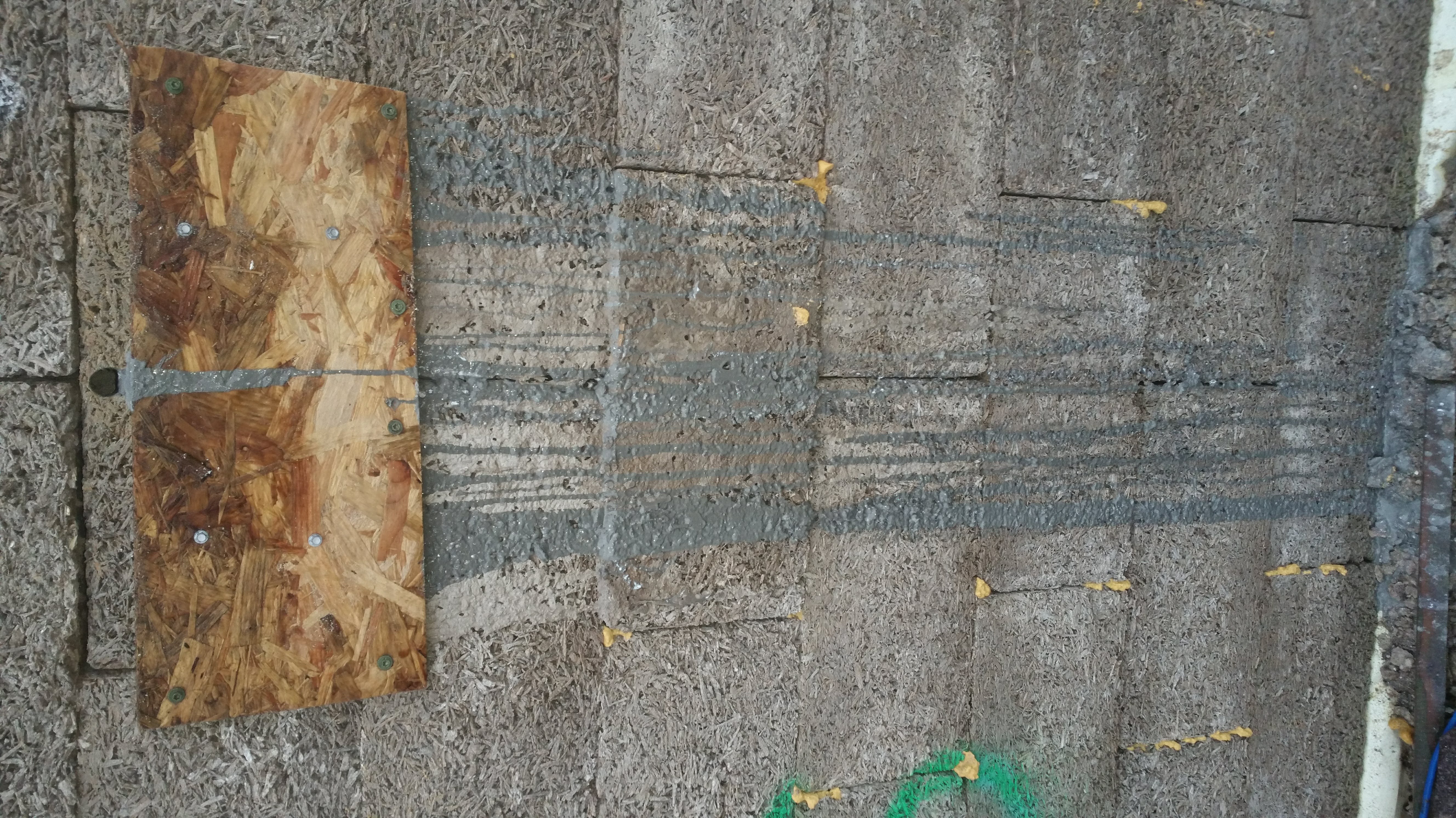

ToughButterCup Posted February 14, 2018 Share Posted February 14, 2018 Oh dear, what a shame, never mind. I'll try again on Friday. This is the problem. Talking to Durisol about it: ' just back-fill it with some slurry. Cement, PVA, water mix' Tickety Boo. Let's get on with it then. So I made this (chopped up block) as a face-piece. and put this on the back of it (the insulation) and mounted that on a piece of OSB. I cut the corners so that I could guarantee the insulation didn't catch on the corners of the hole. So far so good. Now let's screw the lot to the wall, and drill the hole for the 'slurry' Now, just pour in some slurry. Whassat? Water, cement, PVA And I pour it in and it comes straight back out Oh dear, never mind. What a shame. Link to comment Share on other sites More sharing options...
Jeremy Harris Posted February 14, 2018 Share Posted February 14, 2018 Might have been an idea to foam around the edges before squirting in the slurry, perhaps............... 1 Link to comment Share on other sites More sharing options...
Construction Channel Posted February 14, 2018 Share Posted February 14, 2018 beat me to it. or grout it in first with a less sloppy mix Link to comment Share on other sites More sharing options...
Onoff Posted February 14, 2018 Share Posted February 14, 2018 Deffo foam the join. Also funnel and pipe poured from up higher. Link to comment Share on other sites More sharing options...
ToughButterCup Posted February 14, 2018 Author Share Posted February 14, 2018 1 hour ago, JSHarris said: Might have been an idea to foam around the edges before squirting in the slurry, perhaps............... OK boys, tomorrow. Link to comment Share on other sites More sharing options...
TerryE Posted February 15, 2018 Share Posted February 15, 2018 I would have been tempted just to bung the insulation block into the hole and foam it into place, and with some drizzle foam zig-zagged on the front to act as a keying surface. Then when dry, tossed in a snotty mix and tapped the front Durisol plate onto it and banged a few 6" nail through to keep it in place, whilst the snot went off. But liquid does tend to flow through holes unless you plug 'em. Link to comment Share on other sites More sharing options...
