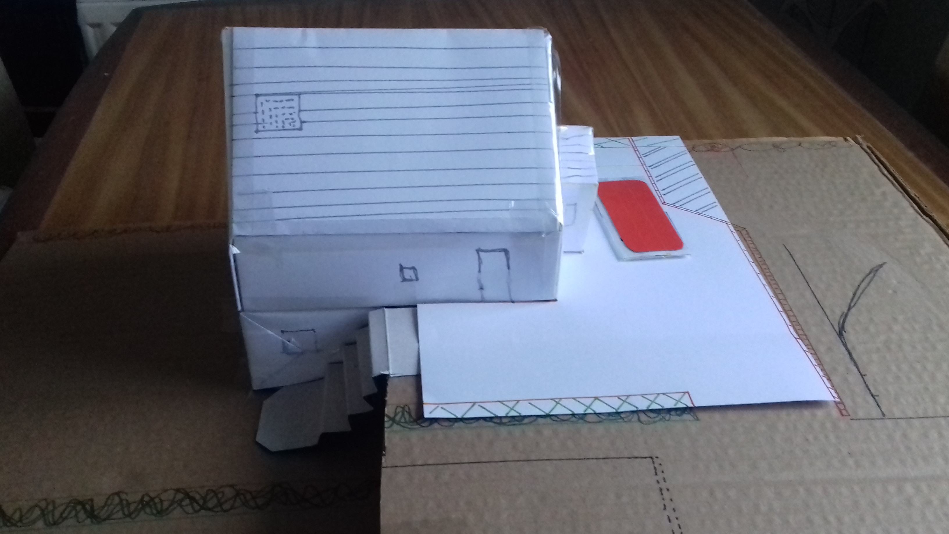

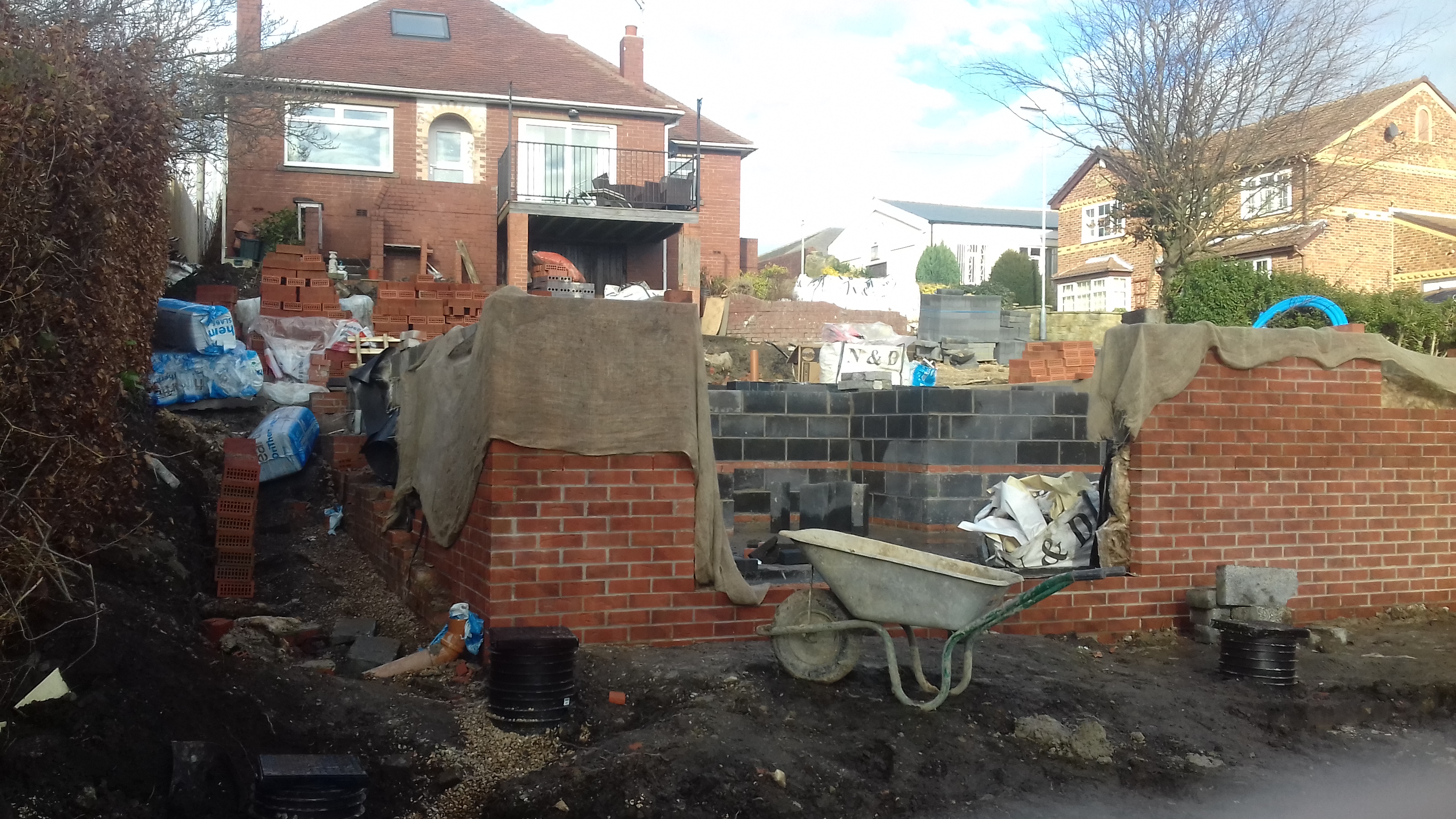

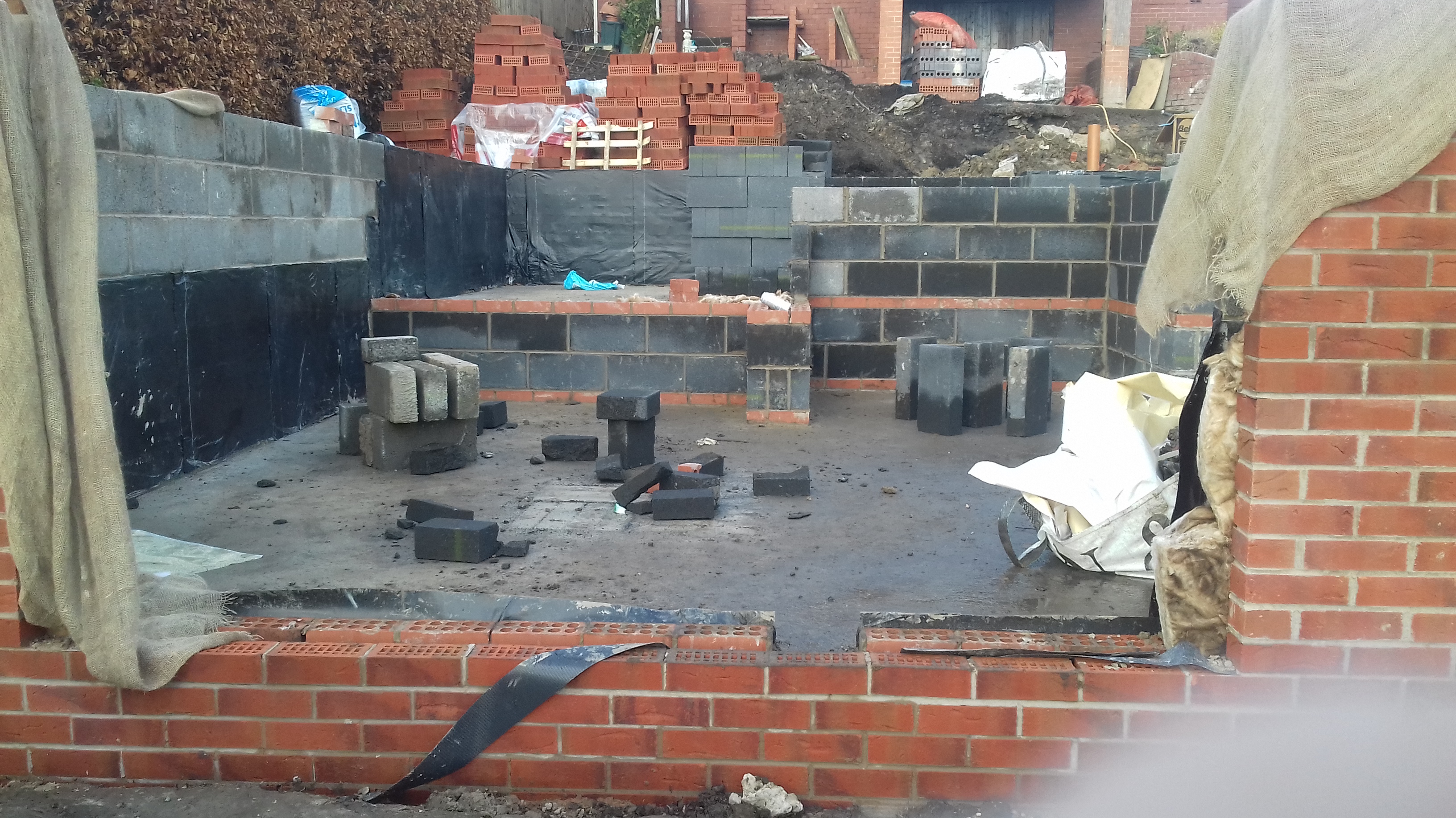

Oz07 Posted February 9, 2018 Share Posted February 9, 2018 How high is the external ground above your ffl? Link to comment Share on other sites More sharing options...
Hecateh Posted February 9, 2018 Author Share Posted February 9, 2018 Very, very rough model - The ground at the far side will slope down fairly evenly along the length From this view the land will only be slightly sloped at the top - to allow for car turning/parking and the steps. The mid level is only about 1.5 metres above the lower level Link to comment Share on other sites More sharing options...
