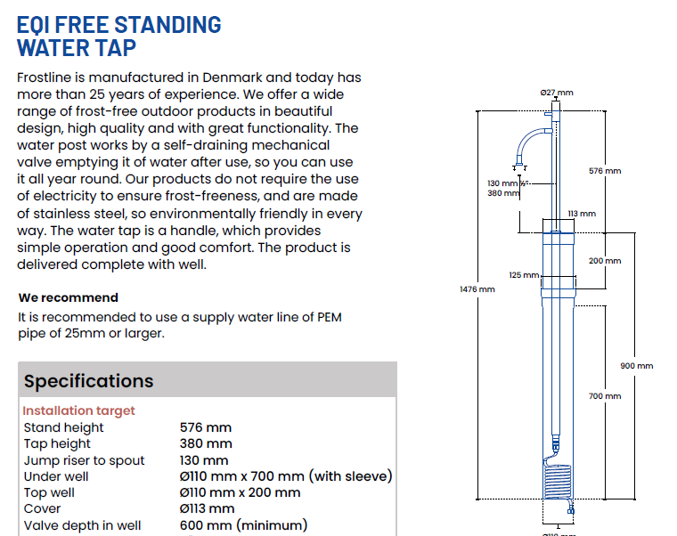

Mr Blobby Posted 3 hours ago Posted 3 hours ago (edited) I would dearly love to have a freestanding tap in the garden, but is it worth the effort required to stop it freezing. But I hate taps on the wall. Frostline taps have some self draining mechanism to stop them frosting up but still require a nearby valve in the ground. If I need to put a valve in the ground then I may as well just install a regular free standing tap and then a drain valve in a nearby box to drain it in the autumn. Bernard the builder is already rolling his eyes over this, what to do? Edited 3 hours ago by Mr Blobby
