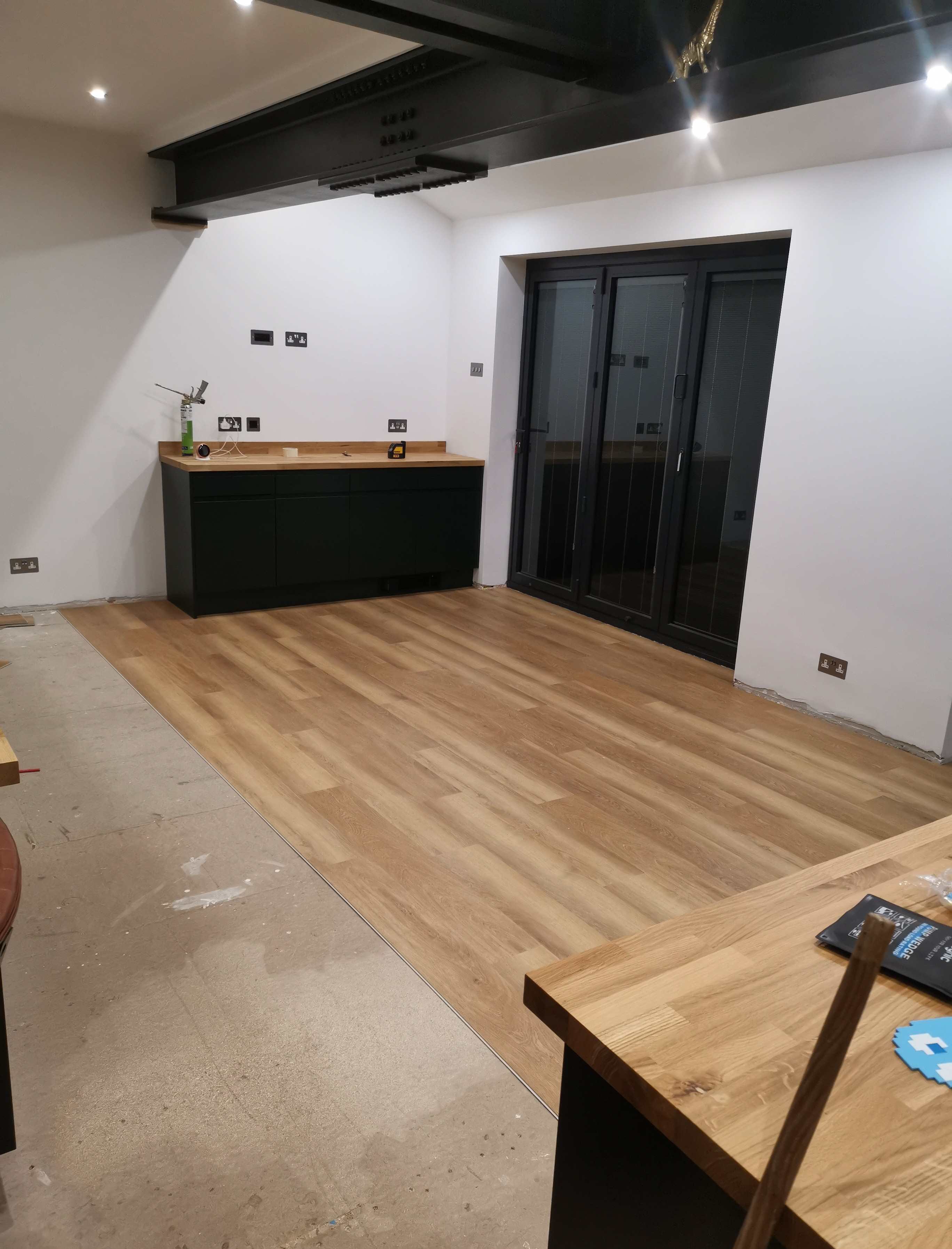

kandgmitchell Posted September 29 Posted September 29 11 hours ago, MPH243 said: The guys I work for fitted some and it buckled in front of the bifold doors, I took it up and relaid it and made sure all expansion gaps etc, and it still buckled. We fitted Amtico floating LVT in the extended kitchen at our last house. The extension featured large bi-folds looking south across the hills, lovely view... However, the first summer it all buckled between the island and the bi-folds. I chased Amtico and they said the product wasn't suitable for conservatories, having pointed out that this was the ground floor of a two storey extension, they changed to . ..... we wouldn't recommend it in that location due to the heat. Eventually they sent a technical guy down to help the kitchen fitter and between them they glued it down in that area.

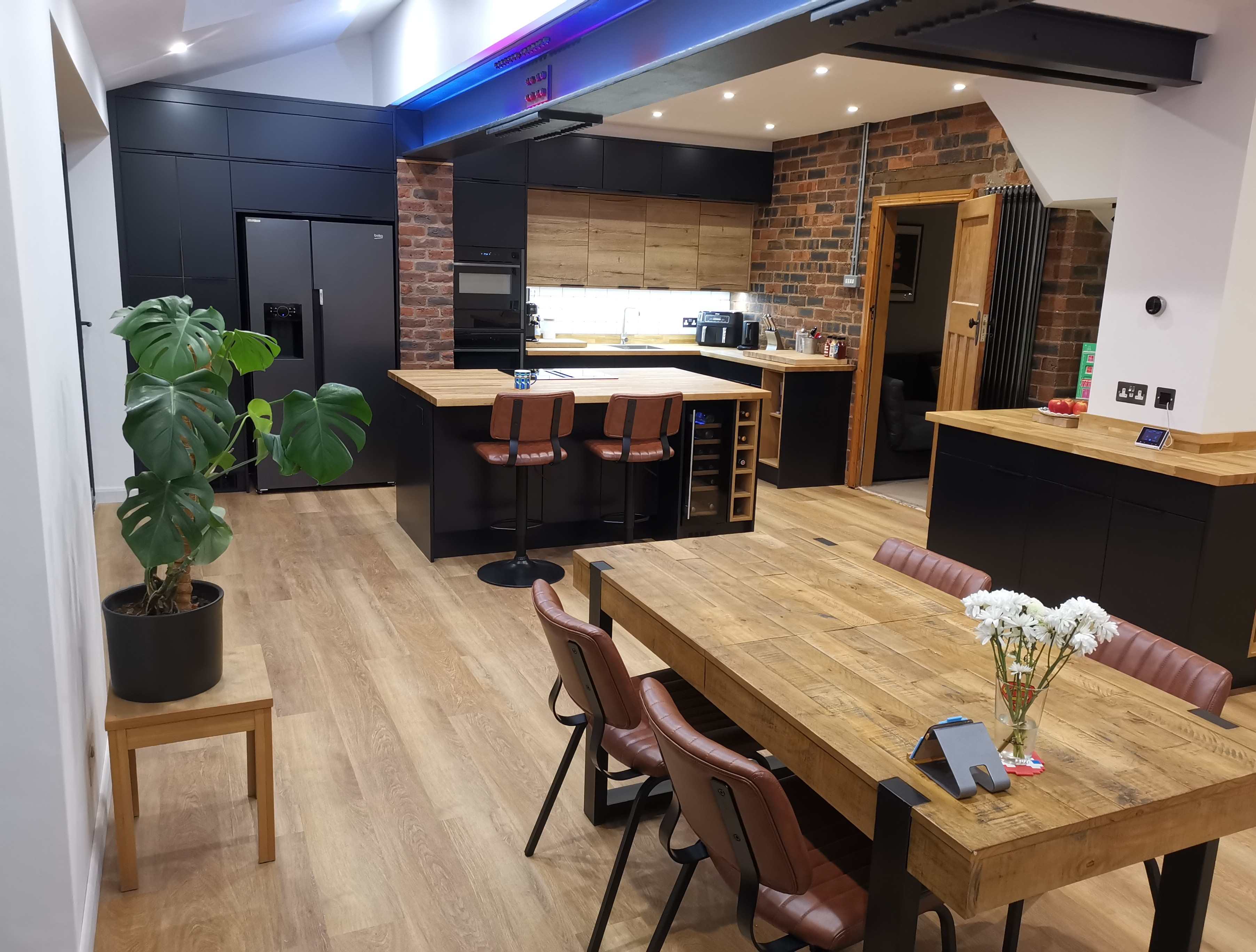

BotusBuild Posted September 30 Posted September 30 On 29/09/2026 at 07:15, Great_scot_selfbuild said: We’ve gone for herringbone, which I may live to regret when we eventually get to the install stage! I did that in a room about 6x8m. It nearly killed me 😁 To answer OP, no gluing, expansion gap around edges. Used trimmed tile edging to cover the gap. 2 1 2
-rick- Posted September 30 Posted September 30 (edited) 7 minutes ago, BotusBuild said: I did that in a room about 6x8m. It nearly killed me Glad you did it though? It looks good to me! Edited September 30 by -rick- 1
BotusBuild Posted September 30 Posted September 30 2 hours ago, -rick- said: Glad you did it though? It looks good to me! Yes. It looks fecking brilliant 1
Super_Paulie Posted September 30 Posted September 30 3 hours ago, BotusBuild said: I did that in a room about 6x8m. It nearly killed me 😁 To answer OP, no gluing, expansion gap around edges. Used trimmed tile edging to cover the gap. always love a "done in" photo mid-build. 3
Nestor Posted September 30 Posted September 30 In our kitchen I fitted 60sqm of Parador Rigid click vinyl SPC solid core with acoustic underlay, 6mm x 457mm x 914mm tiles on caberdek. Great quality product out of the box, a little awkward to fit together due to the size, planks would be easier. Fully floating with expansion gaps and skirting fitted later. However in front of a south facing 3G 4 metre sliding door the tiles have buckled slightly across the width of the tiles and do lift (0.5mm ?) on very sunny days, enough to feel a tiny pop when walked on. This product cannot deal with full sun. 1

Great_scot_selfbuild Posted September 30 Author Posted September 30 4 hours ago, BotusBuild said: I did that in a room about 6x8m. It nearly killed me 😁 To answer OP, no gluing, expansion gap around edges. Used trimmed tile edging to cover the gap. @BotusBuild this is the inspiration I need. Looks amazing! How did you set out the alignment? And tips for do’s/dont’s?

MPH243 Posted September 30 Posted September 30 4 hours ago, BotusBuild said: I did that in a room about 6x8m. It nearly killed me 😁 To answer OP, no gluing, expansion gap around edges. Used trimmed tile edging to cover the gap. That looks really good, I have done a real wood parquet and it was hard work keeping it straight as each block was slightly difference size(as wood is), I guess lvt is just keeping the angle correct. I have fitted a SPC and normal, the SPC does feel difference and it is not supposed to expand much I think it's a 12m run. It has been down 3 years and no problem but only has 1 french door onto it. 1

BotusBuild Posted October 2 Posted October 2 On 30/09/2026 at 21:24, Great_scot_selfbuild said: @BotusBuild this is the inspiration I need. Looks amazing! How did you set out the alignment? And tips for do’s/dont’s? In a non square room it took a while to decide what straight edge to start from 😀 A lot of measuring and marking to get a "centre" line, then choosing which corner should be on that line. Tips: Dry run fitting the pieces together - you may find there is one way that works better/easier for you. A centre of the room line is not necessarily the correct thing to do as you may end up with tiny pieces to fit in at the edges. Lay out 10 to 20 "rows" but only two pieces wide (hope that makes sense) to start with, then line up that "patch" of planks on your marked line, and fix it in place (glue, or several screws around the edges that you'll later take out as you add more pieces). HTH To answer some other points above, I only glued the tiny pieces at the edges so they didn't move out of place. The windows face WSW so only get late afternoon sun. Even with LVT, the angle can wander a little, but I guess not as bad as wood parquet. And yes @Super_Paulie, the struggle was real 😀
