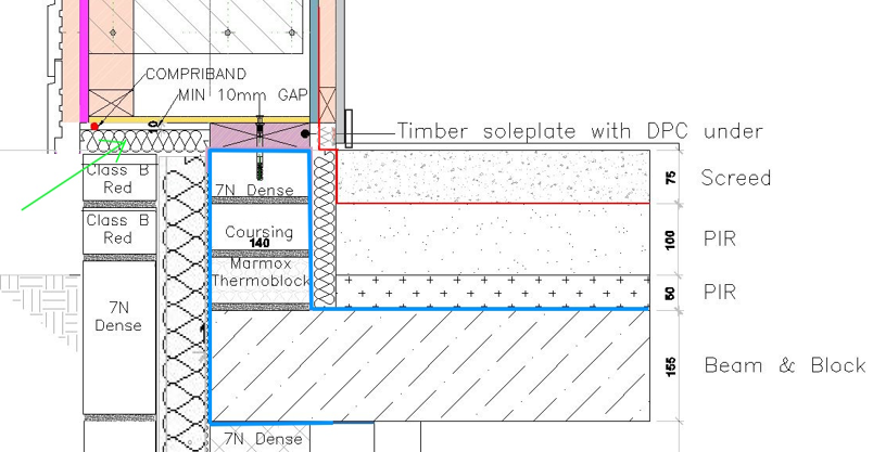

janedevon Posted June 20, 2016 Share Posted June 20, 2016 Hi there really quick question as to best product to use to pack out soleplate. sole plate being laid today by timberframe company, and where it's not exactly level it's been packed out with wedges, they say our guy needs to come and fill the gap, any suggestions? Something in a tube/ gun I guess, going to be hard to get cement under there? many thanks Link to comment Share on other sites More sharing options...
Jeremy Harris Posted June 20, 2016 Share Posted June 20, 2016 This needs to be a really good sealant to make that joint 100% air tight - frankly I don't like the idea of there needing to be packing under there anyway, as it's asking for poor airtightness and indicative of a foundation that wasn't properly laid. It also means that the frame is putting point loads into the foundation, rather than having the load evenly distributed. You need to seal this gap up to absolutely, 100% stop cold air getting in under the sole plate from outside, anywhere, as that risks cooling it and causing interstitial condensation from vapour movement that could, in time, cause the untreated timber to rot. Can you get at both faces of the sole plate? If so, then injecting low expansion foam as deeply as you can get it, from both sides, may be an option. It's going to be fiddly to do, but you are where you are so have to deal with this somehow. After injecting low expansion foam and after it's cured, then sealing the remaining edges with a decent quality PU or MSP sealant will stop moisture penetrating the foam (the foam is fairly air tight, but will most probably be vapour permeable). 1 Link to comment Share on other sites More sharing options...
janedevon Posted June 20, 2016 Author Share Posted June 20, 2016 Thanks, yes it's a bit annoying however the frame company say that it is common in their job to do this they said most jobs they go on are the same, annoying to say the least though, so I'm left with this gap to fill between my dpc and the sole plate, should I try to get it filled under the dpc layer ? Or on top going to be tough which ever way it's not huge gap but theres a lot of it to fill!!! Link to comment Share on other sites More sharing options...
Jeremy Harris Posted June 20, 2016 Share Posted June 20, 2016 I'd have to say it's not at all common, it's very bad practice. Our build is a timber frame and was fitted to a proper foundation that was laid absolutely flat. Anyone laying a foundation for a timber frame building knows that the foundation has to be dead flat and level, it's been common knowledge for decades. There really is no excuse for poor workmanship that can have such serious consequences on the life of the building and for the thermal integrity. Having any gap under the sole plate is wholly unacceptable, especially as filling and sealing such a gap post-erection is both very difficult and unlikely to be 100% effective. Best to try and get the sealant to totally, 100% (absolutely no voids), fill the space between the sole plate and the DPC. It'll be a pig of a job to do well, and will probably need some thin nozzles fitted to a decent foam gun to ensure there's half a chance of getting LE foam right into the slimmest gaps. Any gap at all, no matter how small, will act as a condensation locus when external water vapour moves in through it, and the impact is that the sole plate is likely to remain damp in any such area, with the inevitable risk of rot. Link to comment Share on other sites More sharing options...

Alex C Posted June 20, 2016 Share Posted June 20, 2016 Packing under a sole plate might be far from ideal but it is pretty common practice. Very few frames are put up on power floated slabs, you are normally reliant on a block layer to put down an accurate coursing block course. It is always going to be easier to fill a gap as a sole plate is fitted rather than trying to fill it afterwards. Link to comment Share on other sites More sharing options...

Alex C Posted June 20, 2016 Share Posted June 20, 2016 The mortar will not take the same point load as a concrete block and would need to wait for it to fully cure before putting the rest of the frame up. It is fairly normal to specify a 7kn concrete coursing block that the sole plate is then fixed in to. Timber frames often have point loads from steel posts or cripple studs that would be spread more evenly in blockwork. Link to comment Share on other sites More sharing options...

janedevon Posted June 20, 2016 Author Share Posted June 20, 2016 Yup mine is on a course of 6 inch blockwork allowing ffl inside at least the blockwork was square just a few gaps to fill and bearing in mind it's above dpc hoping won't be a problem Link to comment Share on other sites More sharing options...
