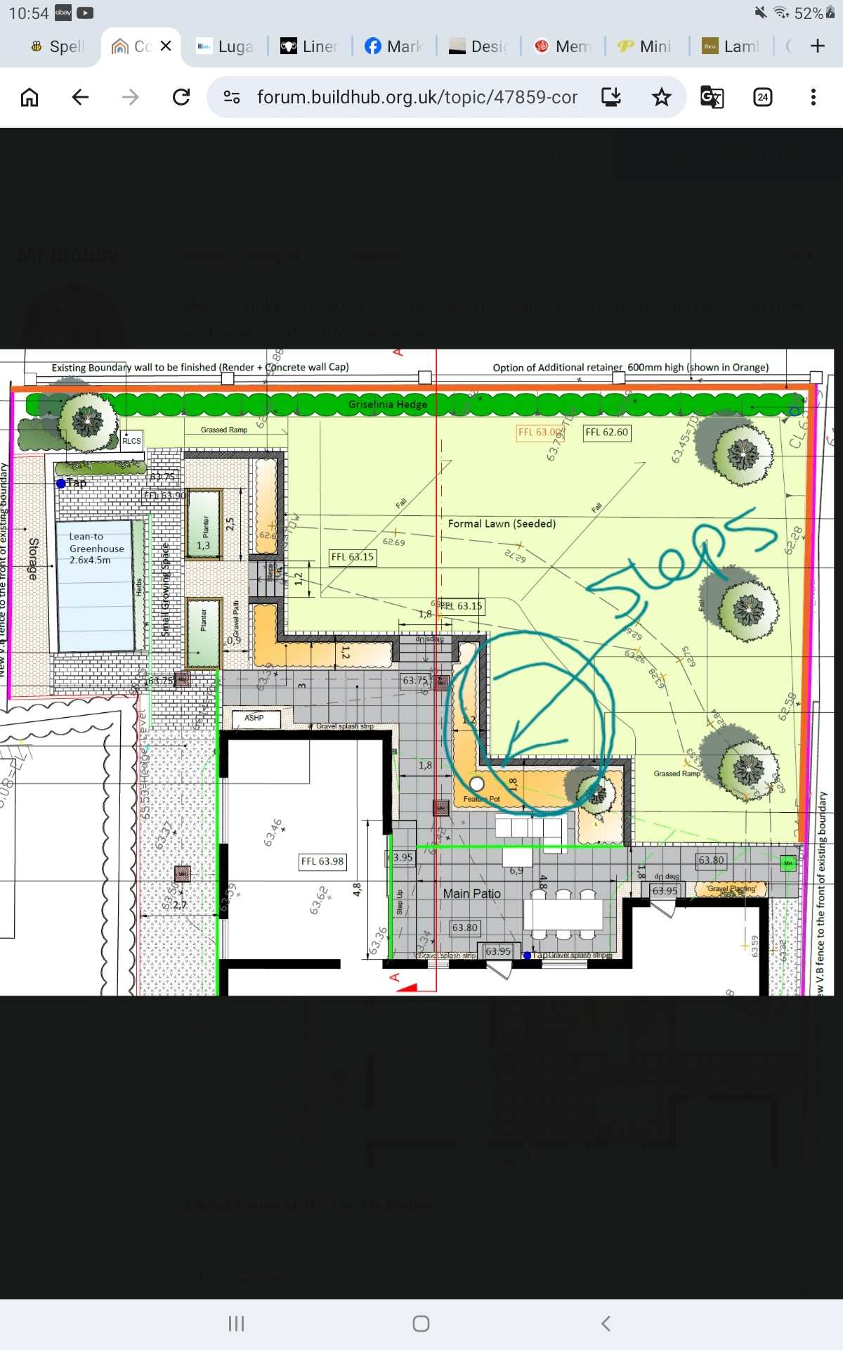

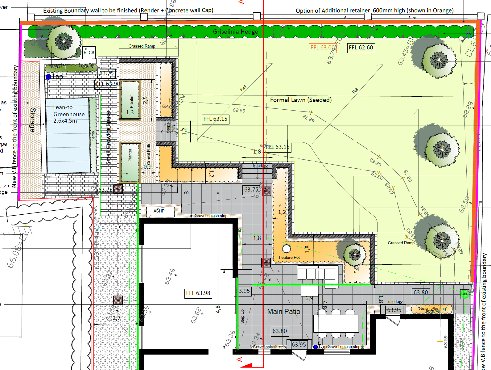

Comment on our landscape design
We've spoken to two landscapers and both are mad about lots of plants and trees and seem deaf to low maintenance.
We have a digger on site next week so under pressure to finalise this.
Neighbours' houses are to the rear and to the right, so some privacy on the patio would be nice but we are not big gardeners so not too keen on the plants on the patio next to the retaining wall.
Retaining wall around patio will be over 600 so we will need to put a rail or build the wall up to 1.1 metre for building regs I think.
Digger access is LHS of house, but think it may be useful to leave access for digger instead of all wall.
Comments please....
Edited by Mr Blobby
If you are not keen gardeners the greenhouse will be unused.  A shed for the mower, strimmer, hosepipe and other garden tools and furniture may be more useful.  The Griselinia hedge may be a bit of a solid green mass.  Maybe rural hedge mix of, say dog rose, hazel, dogwood, hawthorn would be more wildlife friendly and give more seasonal variation.
Is that a wall around the edge of the patio ? If so it would seem to cut off the lawn from the patio. Wouldn't you want to look out and see the lawned area when sat on the patio or in the house ?
A lot probably depends on use cases etc i.e. exactly how you plan to use the garden and who will use it etc e.g. adults, kids, elderly, wheelchairs etc.
Maybe consider a second outside tap on the other side or near the house for watering and cleaning.  (or is that one marked there already ?)
Which way is south and have you considered where you want shading ?
Sight lines from windows and seating positions would normally be something to consider and relate to seasonality of planting - magnolia flowers early, spring blossom tree, autumn colour etc.
It is difficult to comment too much without knowing what is there already, and how much things are constrained by that and by budget.
This wall and drop is where we are stuck.  We want to level the lawn so it has only a gentle slope.  But we also want to see the lower lawn section but can't have a 1m retaining wall without a fall protection wall at the top.
 We will either be ditching the wall and just have a bank, or maybe a hybrid 600mm drop and then banking down to a total 1m drop over a 3 metres.
We want to try to level off the lawn section as much as possible for kids to play on.

Not sure which room is which  ( take sliding doors to indicate one most used rooms?), nor how old kids are, but how about wide tread, shallow steps down? Not necessarily cheap but would give view downs to grass and double up as extra seats? (Could be done more cheaply to start with, grass treads over sleepers or like with a view to a paved version in future)
I like the stepped wall but landscaper is not too enthusiastic.  Suggests raising the lawn up by 500mm instead.  That would be kerbs as retainers at the rear and side and about 20m x 20m of 500mm fill.
I wonder which would be the easiest and cheapest 🤔
Edited by Mr Blobby

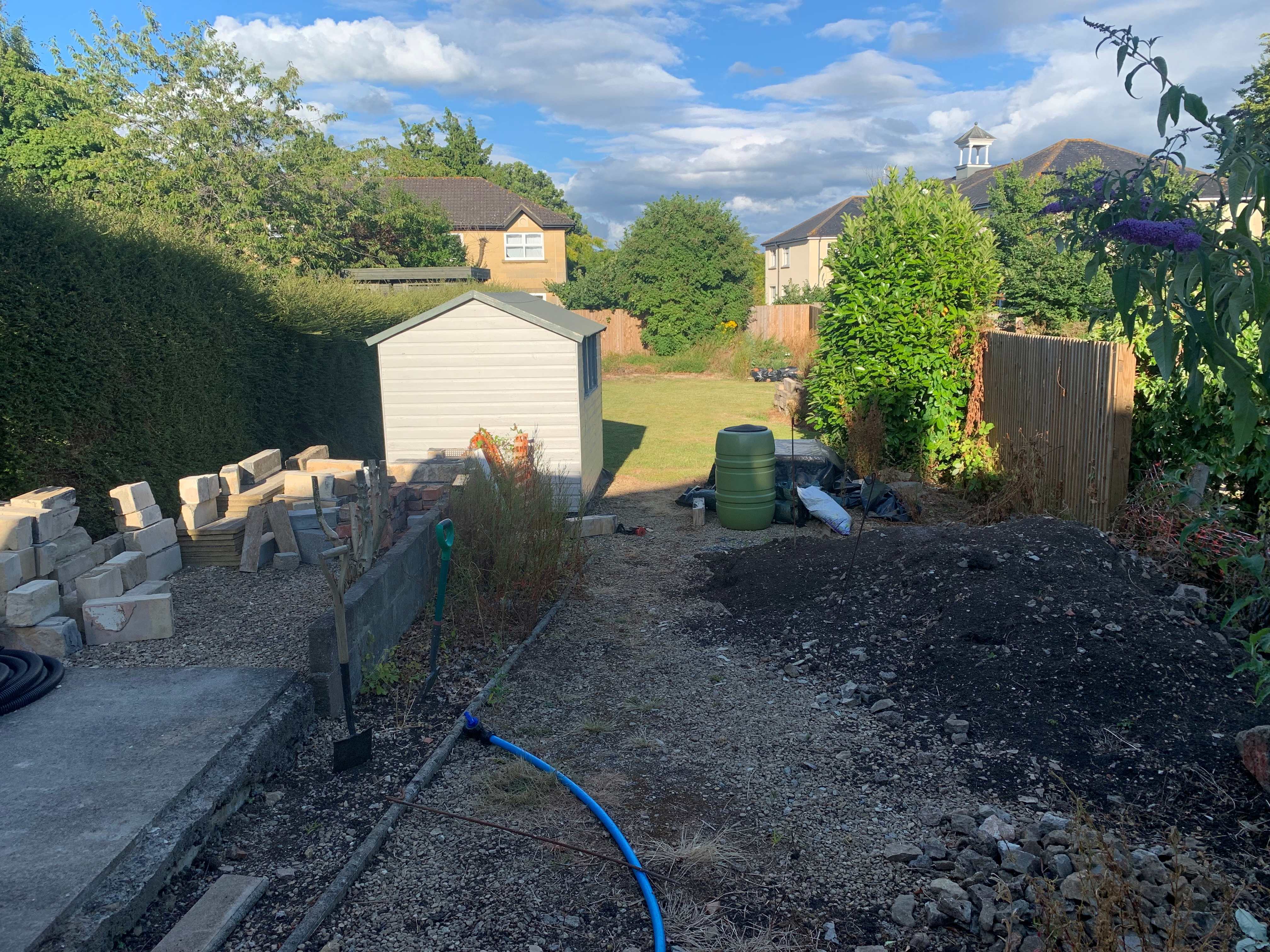

Our place faces west as well. We are fortunate to get some evening sun flooding down the north side of the house into the back garden. perhaps you get a similar effect with some evening sun coming down into the back where you have your 2.7m wide area to the north of the house ? If so you might want to consider a seating area where the planters are ?
When the sun sets the shadow of the house creeps over the back garden and a patio near the house becomes shaded. And then it becomes nice to (a) stll look out onto areas that remain sunlit as long as possible and (b) have a second sitting area to catch some evening sun elsewhere in the garden.
Our back garden is longer but thinner and so we plan to have a patio near the house, and a second one at the bottom of our garden.
Photo is 7pm on 7th July.
