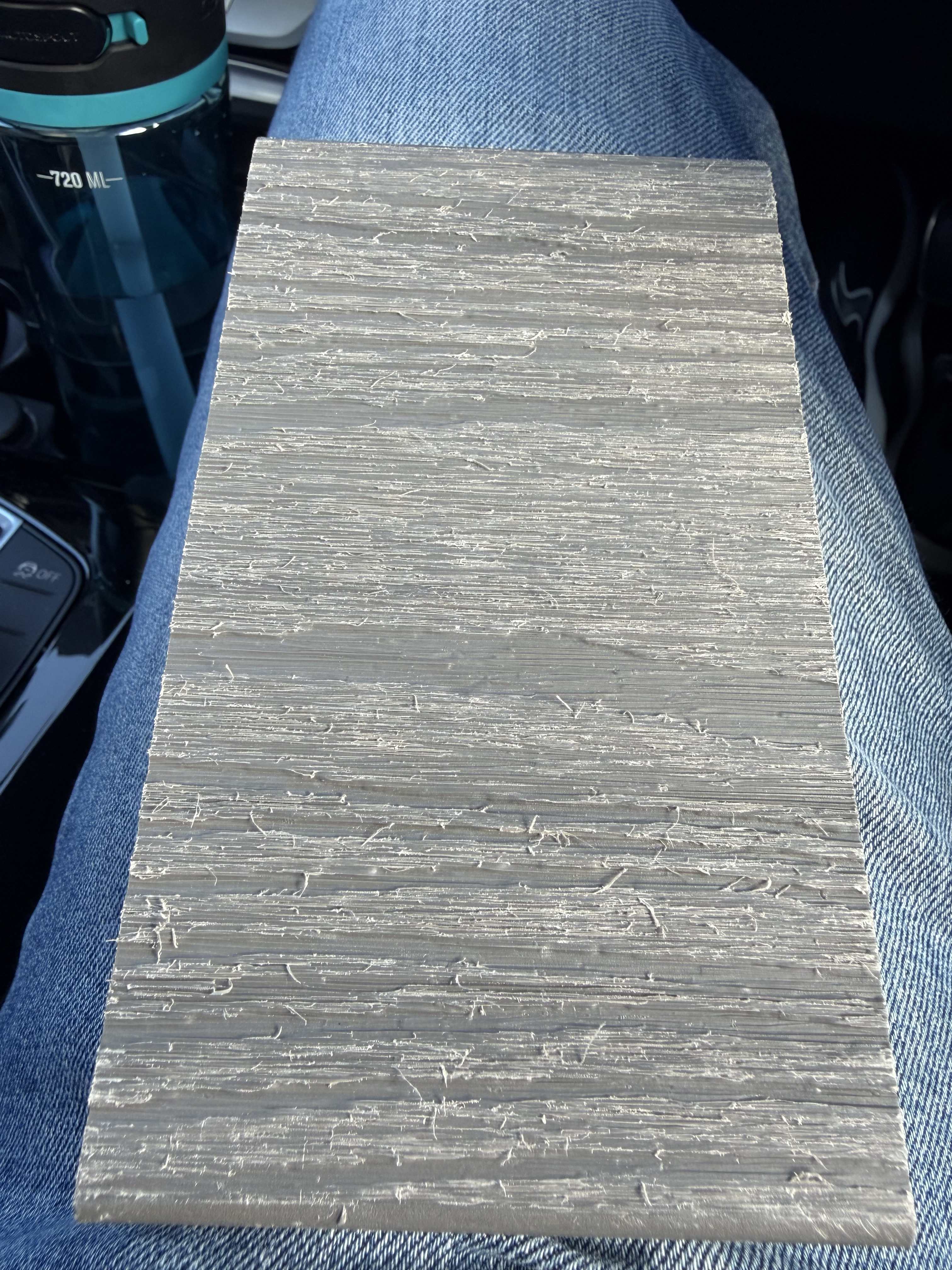

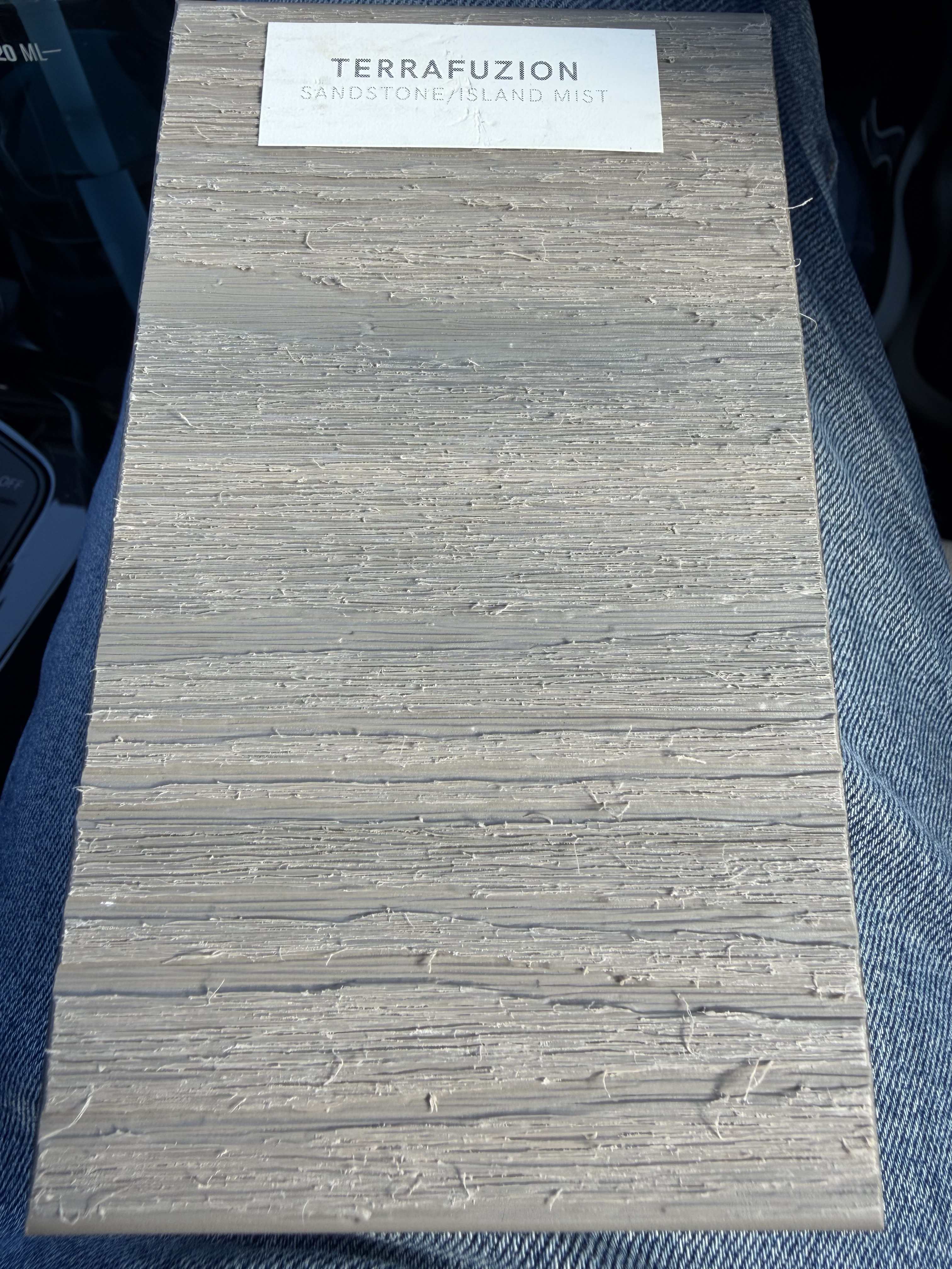

I have somebody laying a deck on our roof terrace and I am looking for recommendations on composite decking. I had a look at some samples, one of which is Terrafuzion but I do not believe them to be of great quality albeit they are cheap. The finish on even the samples appears to be flaking off!
I would like something mid to high end. It isn’t used frequently but I do want it to last.

The photos you attached look a rubbish quality board.
