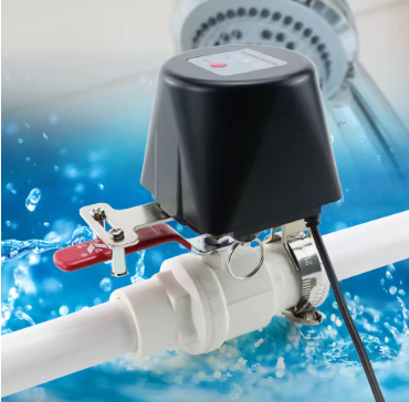

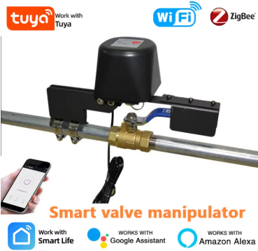

MortarThePoint Posted August 30 Posted August 30 There are various products (e.g. Moen Flo) on the market that effectively include the following elements: Wireless brain with some combination of WIFI, Zigbee and Bluetooth Motorised valve Flowrate sensor Pressure sensor It's a deal breaker for me to have something that requires a subscription (ongoing cost, dead device when cloud disappears,...) and most of the off the shelf ones are such. Consequently, I am tempted to roll my own and have identified the following parts as good options: Brain [£10] Lots of choice, ESP32 likely candidate. Relays likely needed to control mains voltages ... needs more thought Motorised valve [£30] You don't want a spring return one as that would require constant powering and also cut off your water whenever there was a power cut. There are various cheap options on the likes of Amazon (link) but they won't be WRAS approved. You can also get retrofit actuators (link) that operate an existing lever valve though these look like they would struggle with a stiff valve, but that approach does resolve the WRAS requirement. You can get wireless connected valves (eg link) that would allow connection to a home automation system to close the loop. Flowrate sensor [£50] There are plenty of off the shelf meters with digital pulses. For example this one from BES that does 1 pulse per litre. Would be WRAS Pressure sensor [£20] I haven't found one that is approved for drinking water (e.g. WRAS approved), but this is the sort of thing: https://www.dfrobot.com/product-1675.html A bit of elbow grease and some additional fittings and you can make your own system for around £100 that wouldn't go obsolete. The pressure sensor is the main issue at this point as it is required for leak detection (shut off water and see if pressure drops) but I haven't found one that is WRAS approved of claims to be OK for drinking water.

MortarThePoint Posted August 31 Author Posted August 31 (edited) 1 hour ago, joth said: If you want WRAS motorised valve I'd pay the extra couple of notes for one from here. https://www.solenoid-valve.world/abvm06s Their failsafe valve requires permanent voltage (negligible current) to keep open, and uses a capacitor to run the ball valve closed when power is removed. 9-24v is rather annoying to drive from an ESP32 though, without some additional quiescent current cost Interesting (bit of an issue with the website, but hopefully fine tomorrow). I don't need failsafe operation really since it's a bit of a bonus system. I quite like the ideal of a retrofit approach, but those bolt on ones look a bit weak. There are some stronger looking ones, but still not very satisfactory. I might see if I can 3D print a large cog and pinion arrangement, but that starts to look like a long term project. Edited August 31 by MortarThePoint
