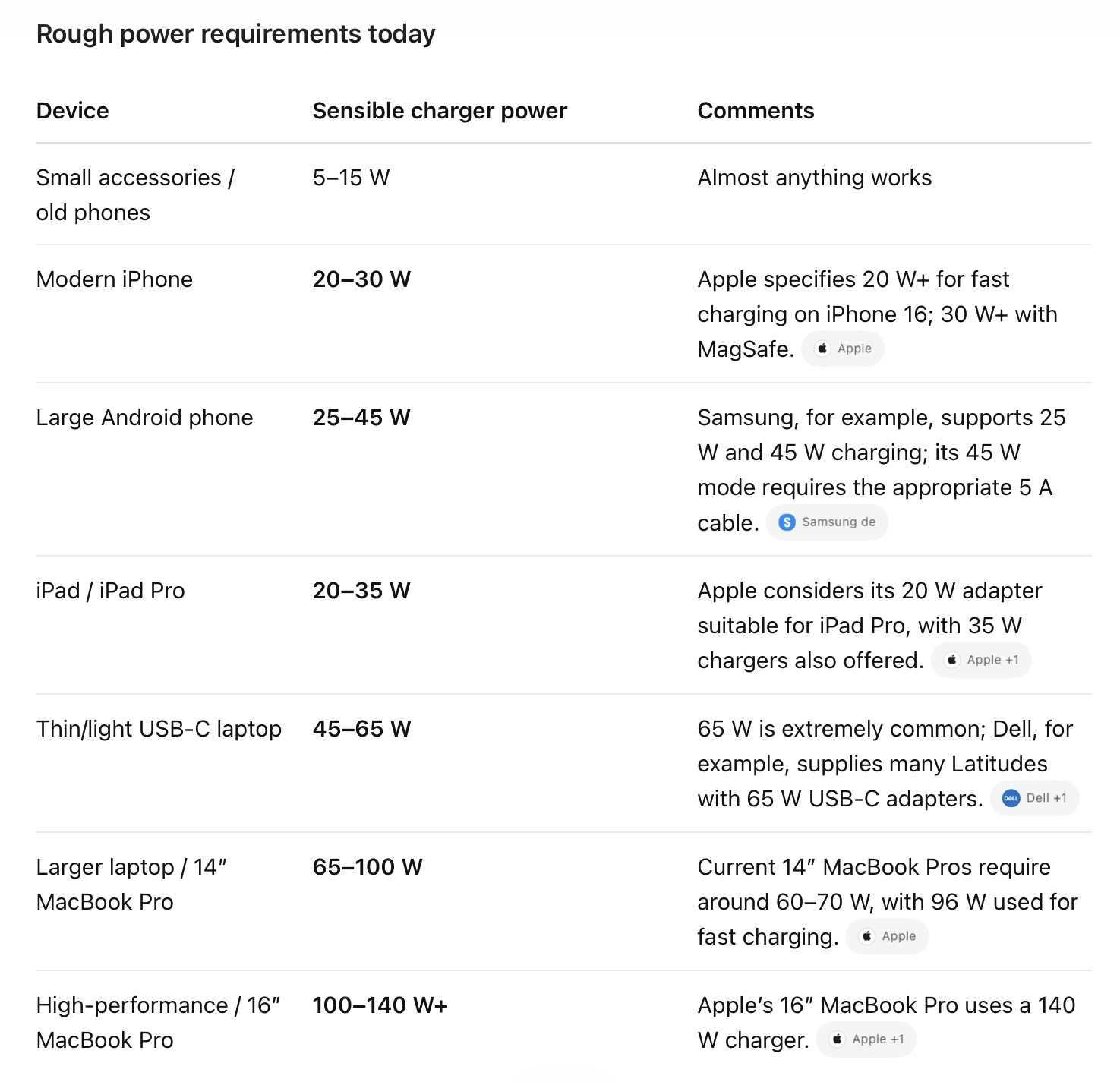

garrymartin Posted 2 hours ago Posted 2 hours ago 1 minute ago, Iceverge said: Does USB C charge faster than the old ones? Yes, USB-C generally charges much faster than USB-A, although it really depends on what you are charging, the cable you are using, and the capability of whatever sits beyond the actual port. Some USB-C ports with Power Delivery (PD) can pump out 240W compared to a USB-A port rated at 2.4A pushing out just 12W. 1
-rick- Posted 2 hours ago Posted 2 hours ago Just now, Iceverge said: 240w, goodness. For laptops, monitors, etc. The charger will be physically quite a bit bigger if it's putting out that much power. I'd guess the more commonly available ones will go up to 30-60W max. If you have a USB-C laptop charger that will be 60-150W probably.
Super_Paulie Posted 2 hours ago Posted 2 hours ago For what it's worth, the majority of my bench height sockets have both A and C. The one on my island is a high power one so can charge the laptop up while sat at it. Use them most days and if it ever becomes obsolete id just change them to whatever comes out next. USB-D 🤷🏼♂️
-rick- Posted 2 hours ago Posted 2 hours ago And that brings us back to mains sockets with USB-C. The vast majority of them will be more basic chargers so basically the same as a USB-A fast charger but with a usb-c connector. So that means even if you have a socket with a USB-C you can't necessarily plug your higher power device into it and charge at a reasonable rate. All devices have to support the lowest power standard but a laptop would take hours upon hours to charge at that rate. When I say higher power device, obviously laptops but it also applies to tablets and even the big high end phones. Anything with a big battery wants a higher power charge.
