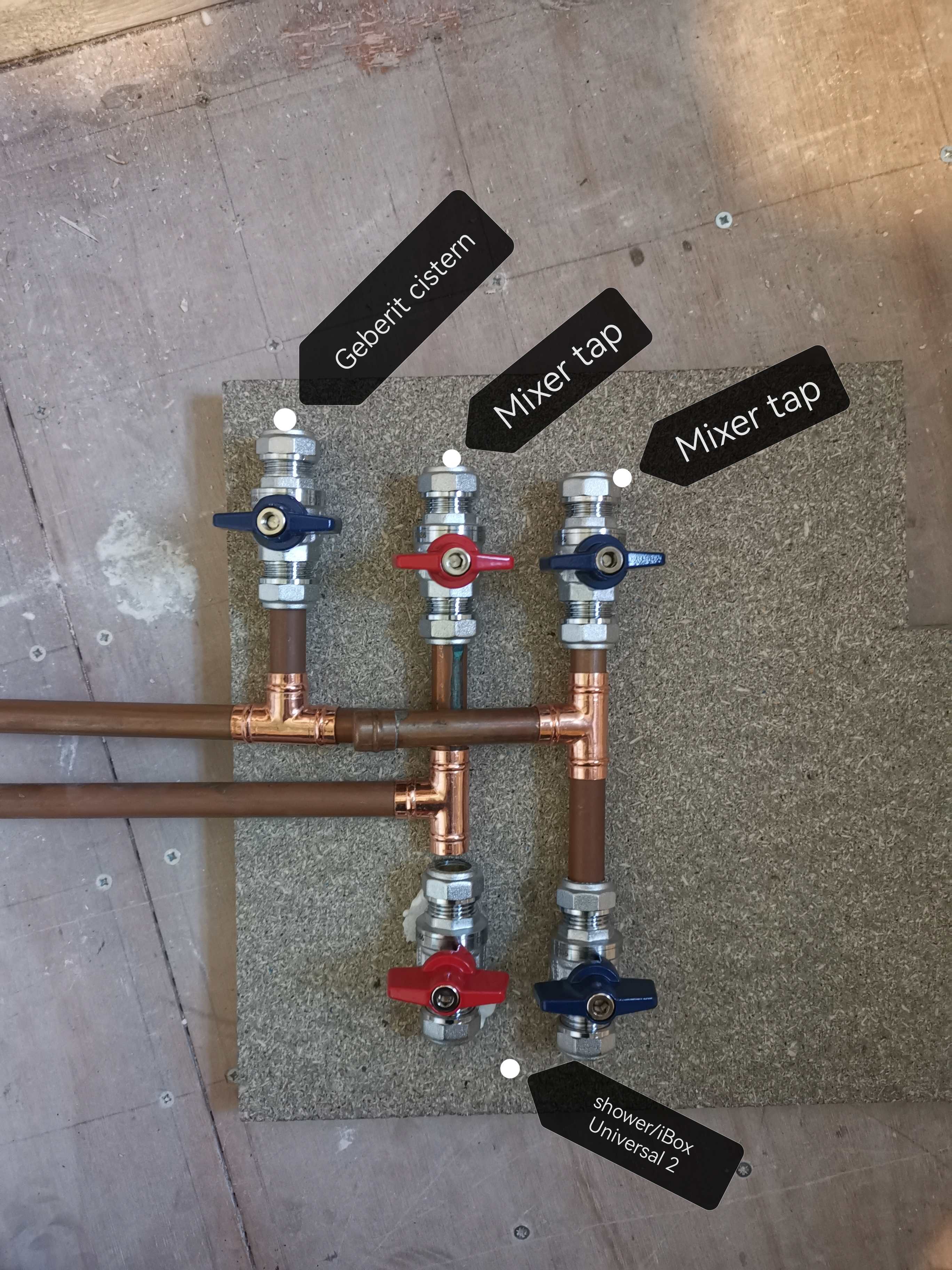

Just mocking up the bathroom plumbing, do I need single check valves on the cistern and the hot and cold to the in-wall sink mixer? I have confined with the company that the mixer doesn't have them built in.
The shower is a DuoTurn iBox2 which I believe has checks built in already.
Image attached, hot and cold supplies coming in from the left, I'll have to jump over the hot, just mocked up for now.

None of our outlets have check valves.  If your hot water source is an unvented cylinder (or combi boiler) all your water (hot and cold) is wholesome.  So my assumption is an UVC or combi - vented you may need checks valves everywhere you can get mixed hot and cold water
Edited by JohnMo
If it's a balanced system (eg UVC with control group @3bar) then no need; that is unless it is written in the manufacturers installation instructions that they do not come with any but you have to install (if necessary).

It's a combi John.
That's what I'll be using Nick, yep. 👍🏻
So no checks at all, not even on the bog?
My understanding is the same as @JohnMo's - when mixing hot & cold you need single check valve. Regular cisterns have an air gap between the water inlet valve & the water level, which is fine. Double check valves for outside taps. Washing machines & dishwashers are required to have built-in valves, but nothing to stop you adding another.

It's a combi John.
If it's a combi you do get pressure drops across hot > cold, but it's still classed as balanced, so all good.
"Bog" has an A-B gap so water from the cistern cannot enter backwards into the system.
Number of single checks required = 0. ;)

4 minutes ago, Nickfromwales said:
Only if open pipe 'gravity hot' and then cold mains the other side ;)

Cheers guys, I've finished the job. I plan to shutter around the timber for something to tile up to, and then clad around this in edged material like the backer board. So it's an in-wall manifold, if you like.
Had to get creative to connect to the incoming mains, but it's all holding pressure. For now!

10/10 for plumbing, but I am very much at odds with the location!
Me as well. SWMBO wanted the vanity as clear as possible as the room is so small. So I plan on having this within the wall, with a window opening. Vanity over the top with the rear cut out so I can access. Sounds ok in theory.
