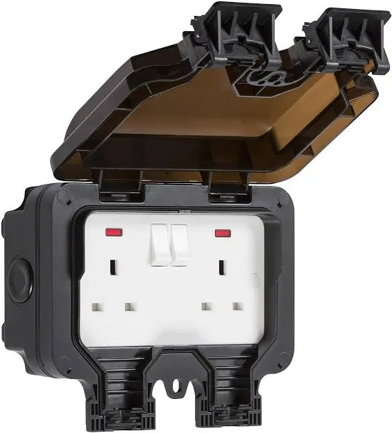

JohnMo Posted 8 hours ago Posted 8 hours ago 2 hours ago, junglejim said: has any tips on getting back boxes into here. Just do external waterproof surface mounted. If your not doing waterproof how are you keeping the water out?
junglejim Posted 7 hours ago Author Posted 7 hours ago 18 minutes ago, JohnMo said: Just do external waterproof surface mounted. If your not doing waterproof how are you keeping the water out? Thanks John sorry I wasn’t clear enough…internal face of external wall.
