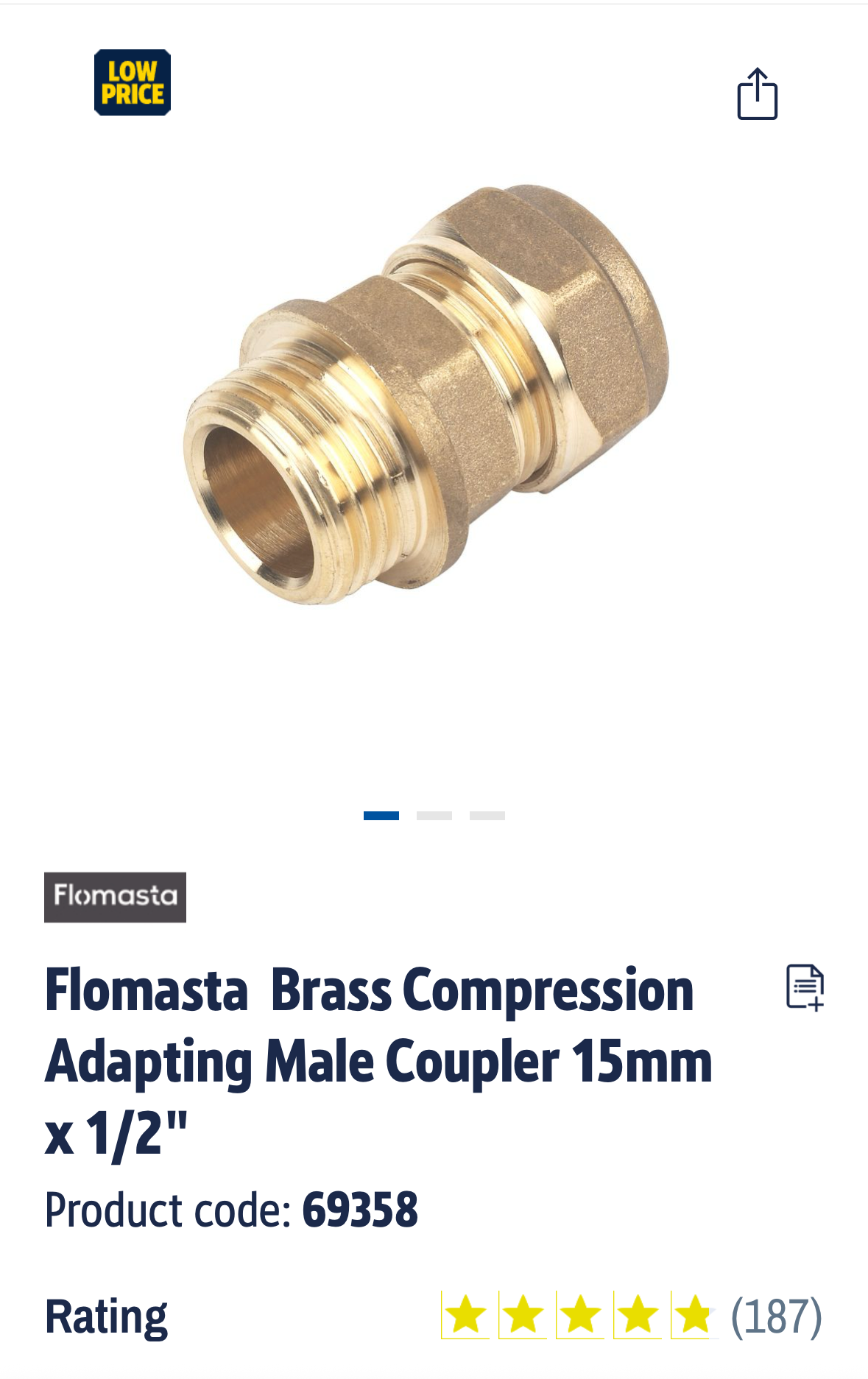

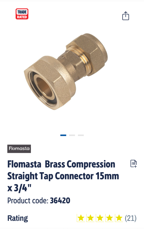

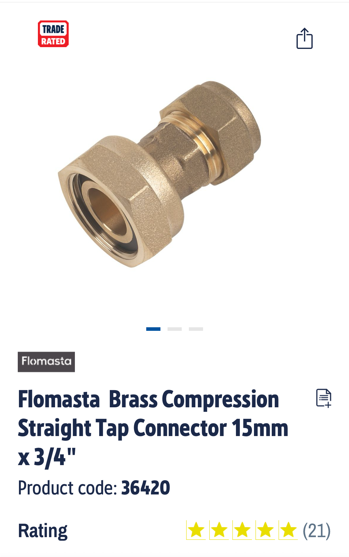

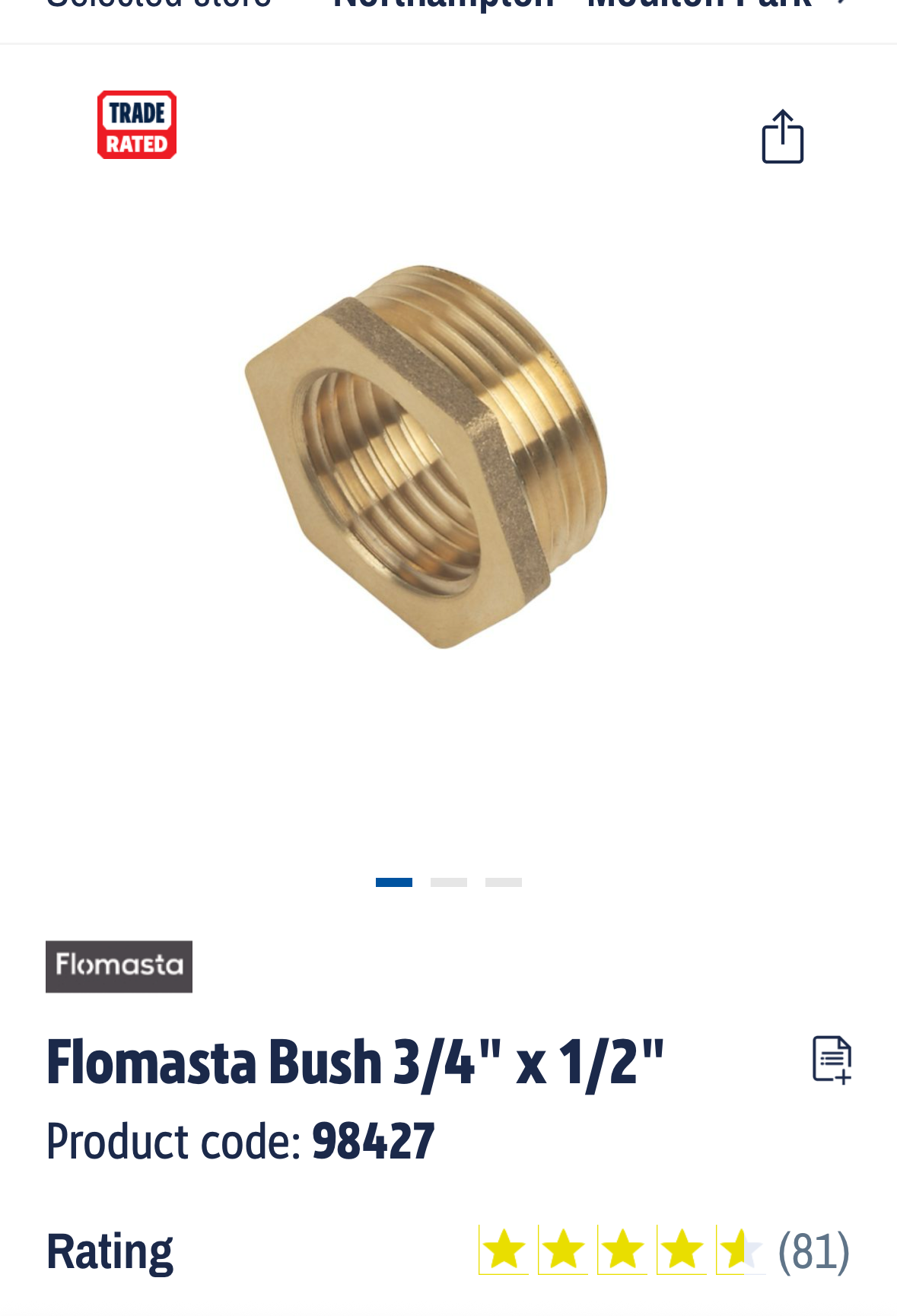

For the shower outlet this is simple.
This goes into the top.
Then this goes into that.
Likely 2 of these for hot & cold.
The bush simply gets 21 turns of PTFE tape, same with the 1/2” male thread, or buy liquid PTFE like pipe superglue if you’re not confident.
Those 3/4” fittings should be just a bit over hand tight and a little pinch with a spanner and all good.
Make off stubs of 15mm into them before mounting them onto the shower, so you’re not swinging off them and putting the rubber seals under undue stress / movement etc ;)

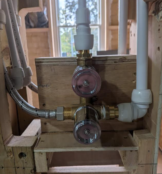

Below is my piping arrangement.
All bathrooms systems have been wet pressure tested and seems dry and holding pressure.
Congrats, looks v tidy.

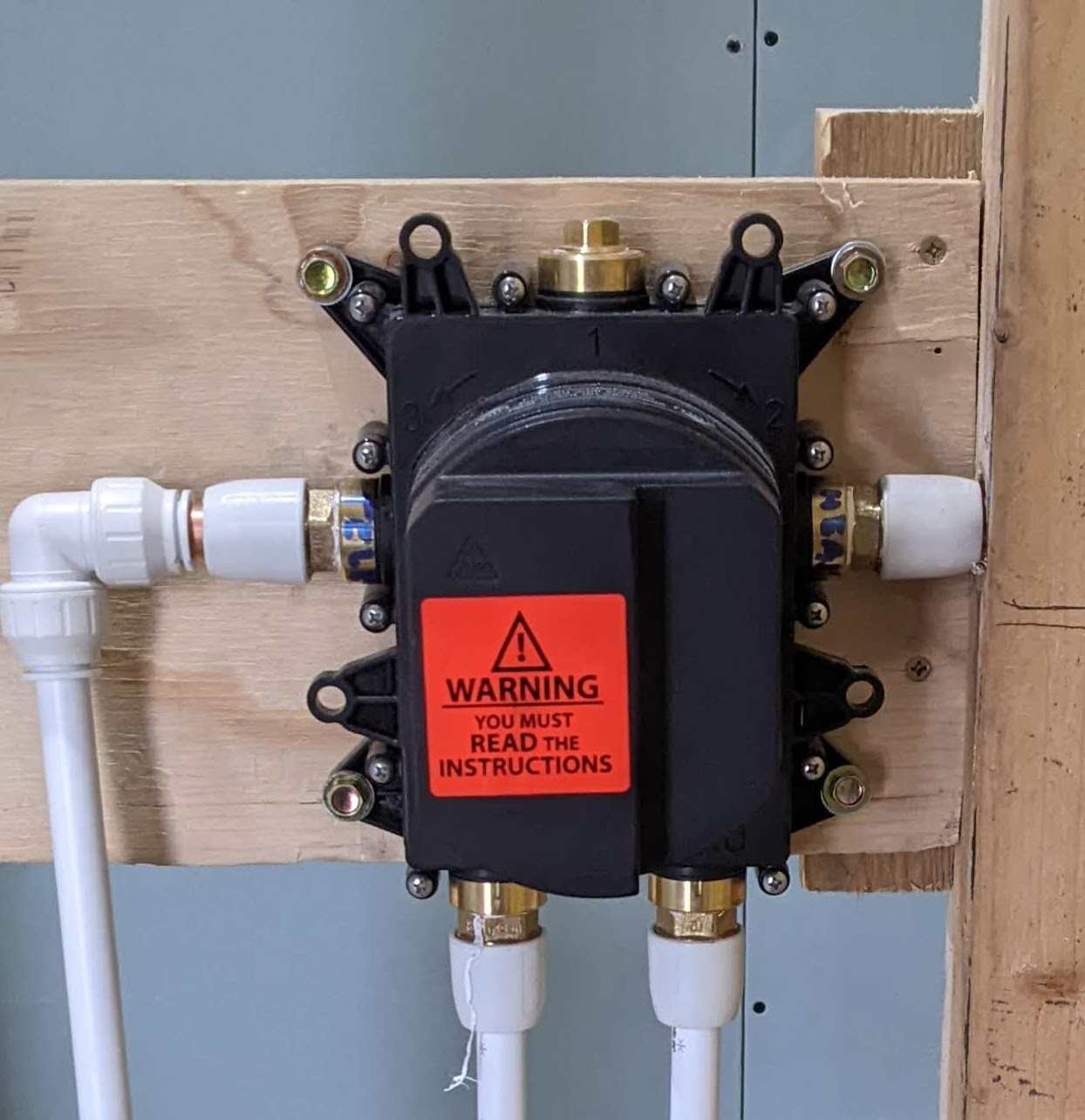

Admittably the instructions for the valve specifically said not to use tapered threads, however it also made a few contradictory statements.
In the end I could thread male tapered fittings entirely into the female parallel ports without any friction or stress; with the addition of Lock tight 55 these joints have passed 5.5 Bar wet pressure test and current not weeping. and will hopefully remain that way.
I always have in my head that the leak risk will be less where fewer joints are used, so yes these Hep2o couplers are tapered, but they get made straight onto Hep2o pipework so it's six of one......

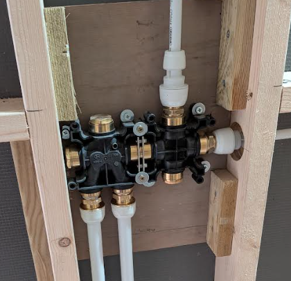

I used the HEP20 3/4 - 15mm push fit directly into my cross water mixer. A bit of PTFE on the threads. No issues 5 years in.
Ah, good to hear.
You have the very same set up as myself.
