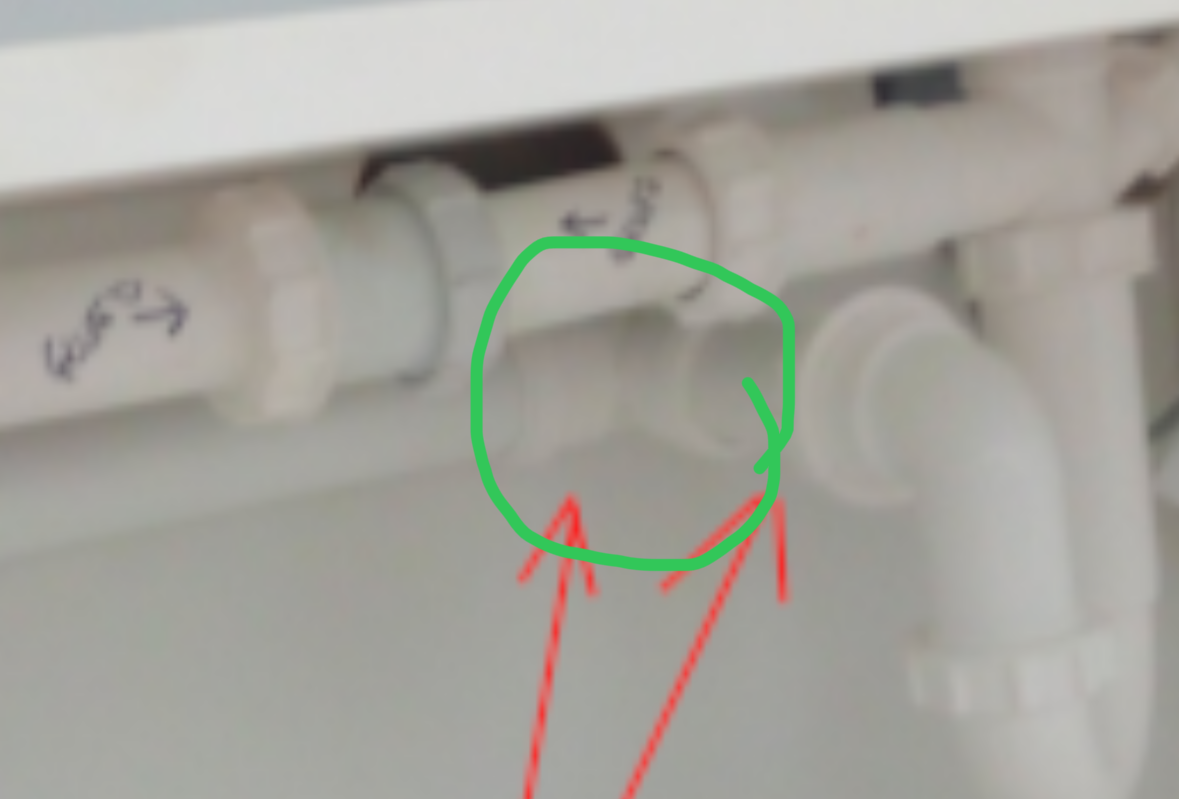

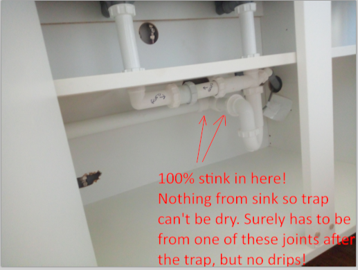

marmic Posted 8 hours ago Posted 8 hours ago morning all, We have a stink emanating from somewhere around trap under sink - but no water leak. 1 1/2" plastic waste. Could the trap be 'faulty' somehow? It's not dry/blocked etc etc - (no smell from sink). There's also an elbow after trap. Both removed, cleaned, reinstalled - but still stinks. not making any sense - new fittings maybe? any bright ideas please? very frustrating!

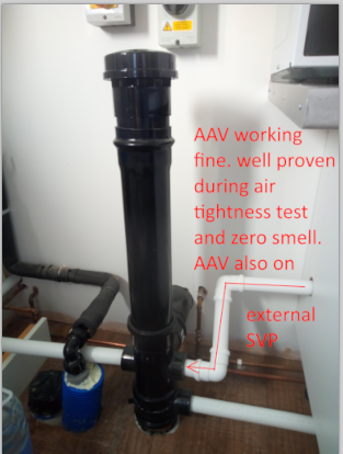

MikeSharp01 Posted 7 hours ago Posted 7 hours ago Sounds like your system is open to the main sewer, have you got a dry trap somewhere - washing machine for instance or maybe an air admittance valve (AAV) is stuck and your loo flushes are sucking a trap dry.
FarmerN Posted 6 hours ago Posted 6 hours ago We have a problem with the dishwasher connection but that’s above the trap and smells from the sink and you say “ (no smell from sink)”. Is it a drain/ sewer smell? No chance of a dead mouse under/ behind units?
