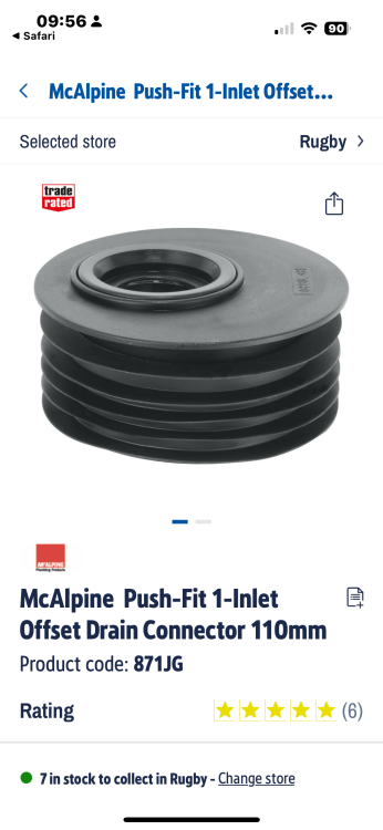

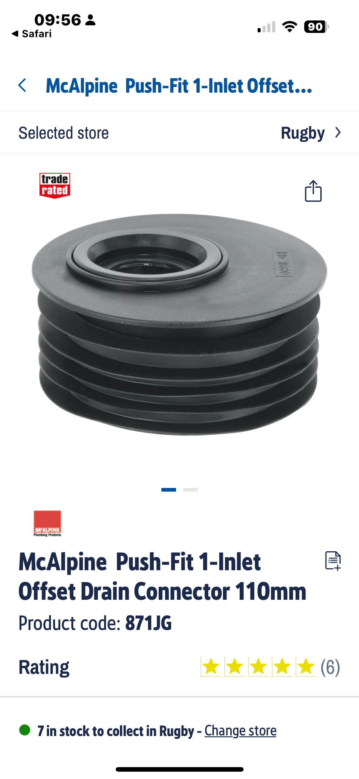

Nickfromwales Posted July 11 Posted July 11 One of these, and have a piece of 50mm pipe dropping through it with a 100-150mm tail, as this will be more forgiving than a solvent weld joint; given you’ll be fiddling with it and working around it as you lay the new 50mm pipe. Set the falls in place with off cuts of PIR insulation or plastic packers, then foam into place and leave to cure for a few hours / day. When cured you trim it square with a handsaw and then butt your sheet PIR up to that. Make up any deficit with more foam, job done. 1
