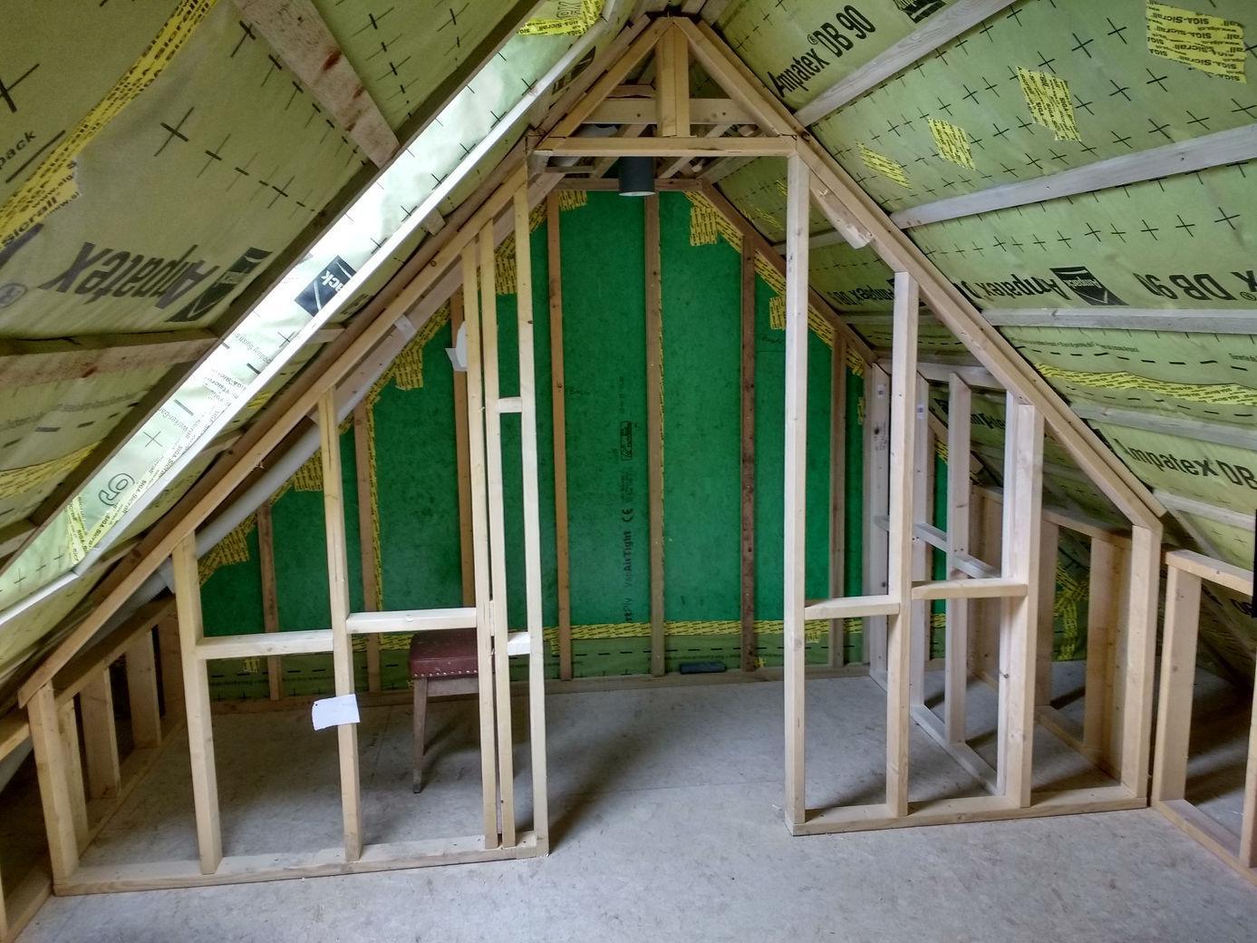

JanetE Posted June 22, 2016 Author Share Posted June 22, 2016 1 hour ago, Nickfromwales said: Another option ? Wont be cheap. The Fiora one I fitted last was £500 for a 1000x1000mm. If avoid the White / lighter colours too as the 'grain' seems to harbour the grot a bit. Not the end of the world tbh if it's cleaned after every use but certainly a point to consider if you have a life beyond the shower tray This wetroom must have a flat floor as we plan to have the glass door opening across the corner of it and acting as a shower screen as well. Difficult to describe - this is on the top floor with a sloping roof so it's all a bit of a tight fit. I think we shall probably have to go with a tiled floor. Thanks Nick. Link to comment Share on other sites More sharing options...

TerryE Posted June 22, 2016 Share Posted June 22, 2016 Thanks @Nickfromwales and @Auchlossen; much appreciated. This ensuite is in our son's bedroom, and he can be a bit of a dozy bugger. One thing that worries me is that this ensuite is tucked into the the rear gable, and the apex is tight at the frame head so we've only got about 3 cm floor clearance unless I start thicknessing the frame head down further, and so we can only have a small thresh on the door. IMO the disaster scenario would be if say he had a shower and dropped a flannel over the tray trap so the floor in the ensuite would then start to fill and top the door thresh spilling into the untanked bedroom. We have a secondary drain in the floor near the door in the wetroom in our Greek cottage. Is it worth doing something similar in this ensuite? OK, this backup drain might never get called upon, so the tanking integrity doesn't need to be of the same robustness as the main shower tray. However, it seems that using this as an emergency overflow would be a lot more to be preferred than topping the door bar and dumping water into the bedroom!! PS. How to you like my model toilet pan? Link to comment Share on other sites More sharing options...
